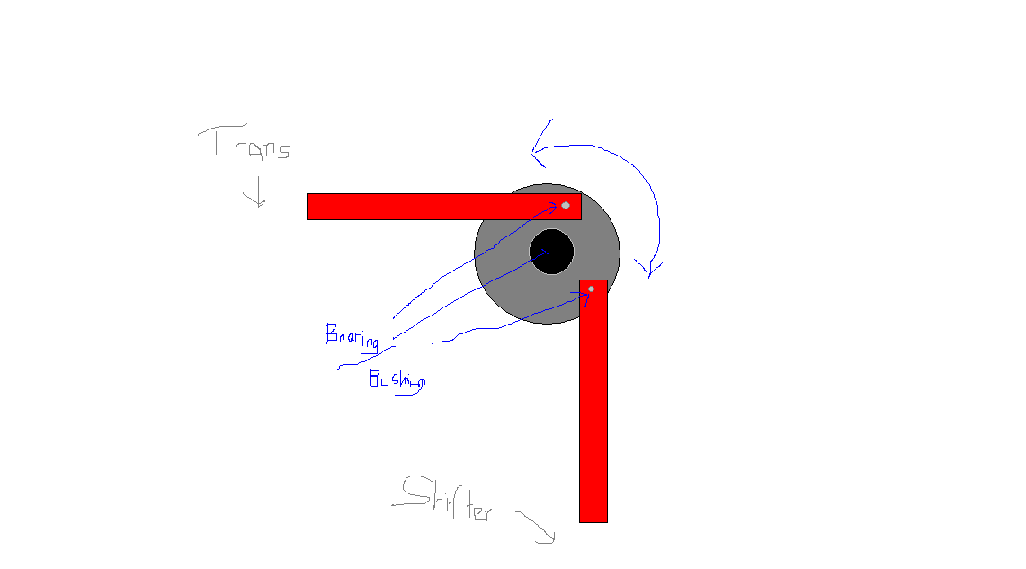

    has anybody put any thought into getting rid of the shift cables? Ive been thinking about trying it but wanted some opinions/ideas. I REALLY hate cables. well and the transmission in general..
    my #1 idea will require a new rear header so I cant exactly try it for a few more years. this is my best idea so far I think
    after adapting the factory shifter and trans, basically have a rod (well 2), go through the firewall, attach to a pivot point that would move another rod that moves the arms on the trans. pretty basic and simple. getting it to funciton 100% every time in a race setting is a different story. cant be TOO hard tho.
    basically the same as above, but have 2 pivot points and make the transmission shift from front to back instead of side to side. more complicated and higher chance of failing. this would make my current exhaust work (in my head, no real world testing or measuring)
    same as #2, but have one piot point. run one single bar (one for each action I should say), through the firewall, take a 90* left and move along the firewall then go straight forward to the trans after modifying it to shift front to back. I feel like too much flex would happen with this idea.
    I attached a BASIC idea of #1

    This would be a neat idea but the geometry has to be exactly right on this and I don't know how possible that is do to with our setup's

                I dont think it would have to be perfect, just close enough to move the levers correctly. there would be added support/guids not shown in the pic. Im thinking about doing a mini/bench test for the hell of it.
                it would be a hole in the firewall and exhaust reroute lol.
                reliable system??? I think not. Its my car, being user friendly only matters for the guy working on it, plus it seems REALLY simple once everything is designed actually setup, thats the complicated part. I cant count how many I have bent/broken cables, yes, the metal ends bend. its one component that holds the car back. out of all my cars, the beretta is the worst when it comes to shifting. even my geo metro has solid linkage! it shifts amazing. I think a lot of hondas use solid linkage too
                the beretta has a solid shifter, its tighter than factory
                I was thinking 1/2" or 3/4" DOM for the bars. might be able to find a pully and modify it to bolt the bars too. then its just a matter of attaching/supporting everything. I was thinking about heim joints on everything. already planned on making new headers so thats not extra

                        All I can think of with this idea is how much you are going to miss gear changes from engine/trans movement, unless you have completely solid mounts.
