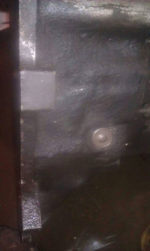

    How do you remove the fork on a 1990 Beretta getrag 282 external slave. I need to replace it and I don't understand how to remove it
    This one?
    I'd say loosen the arm at the top so it slides around, then rotate the arm away from the trans so the fingers are not on either side of the output shaft and then see if it will slide up to release the bottom, then angle the whole rod away from the trans and slide it back down. This is only a guess from looking at this photo though, I've never removed one before.

      Yup

        That method doesn't work. Been banging on it and everything
          I asked a guy on Bnet who I know had to replace his... the picture above is actually the trans he did it on. I'll let you know what I get for a reply.

              Jon's pretty much got it. Loosen the slave cup and slide it toward the input shaft. Pop that end cover off with a screwdriver and start sliding the fork through the hole until it comes out of the bushing. Then just angle it forward and pull it back through the hole you just slid it in to.

                How do you remove that cap?

                  It's just pressed in. The service manual specifies a screwdriver but I can't remember what I used. This was quite a while ago now.

                    I got it out thanks.but the bearing is kind of bad now. Is it even possible to buy these.
