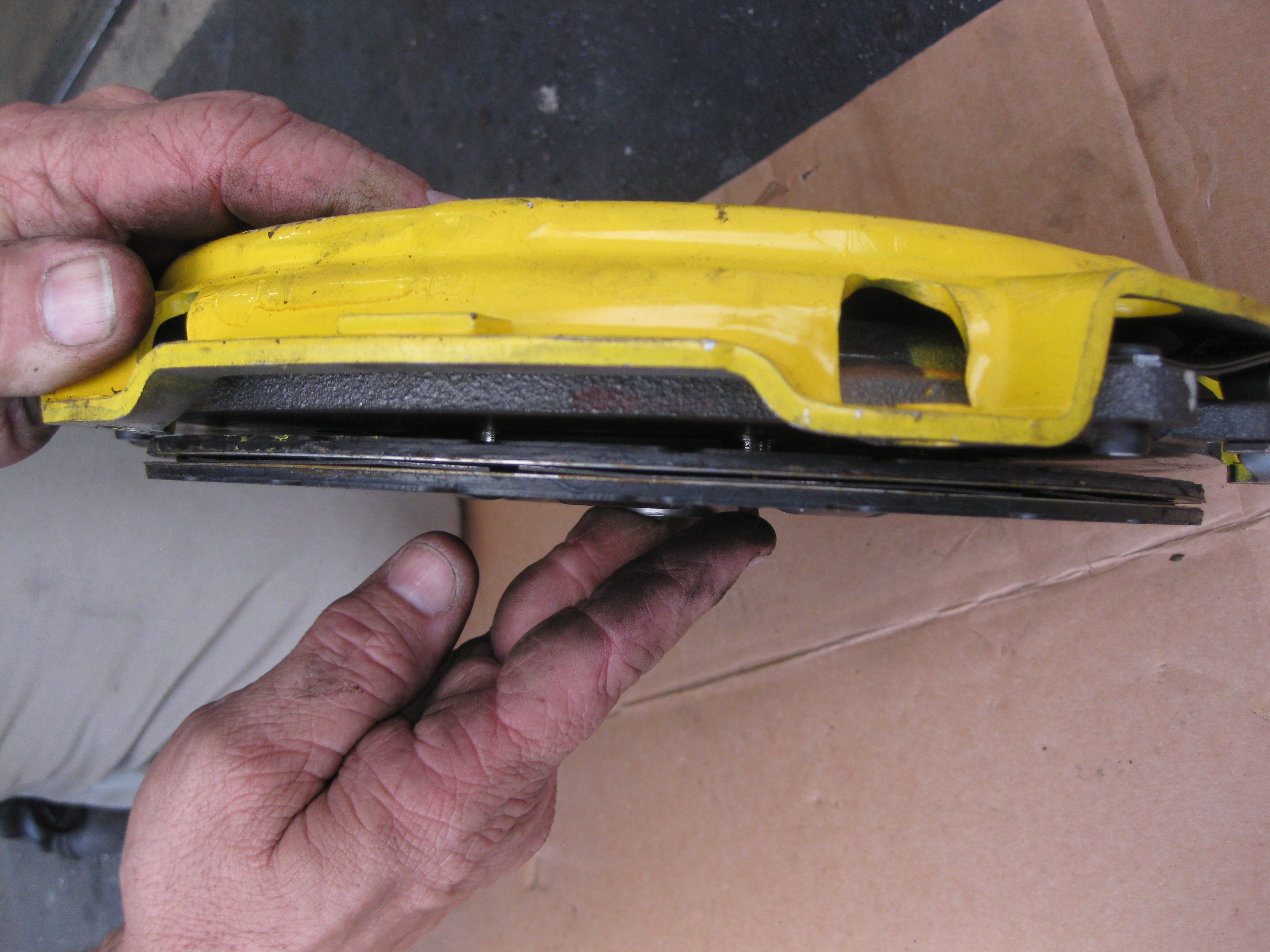

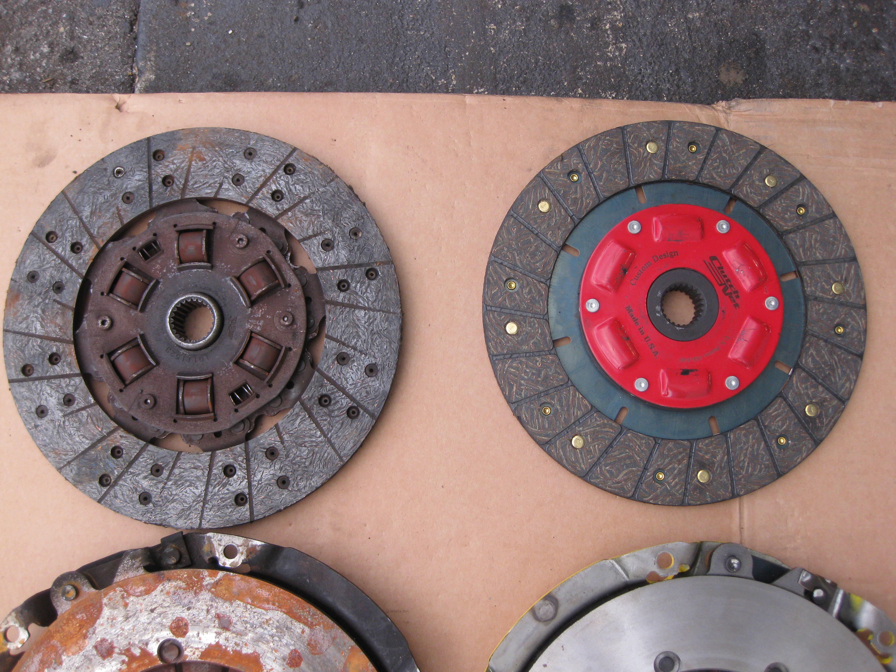

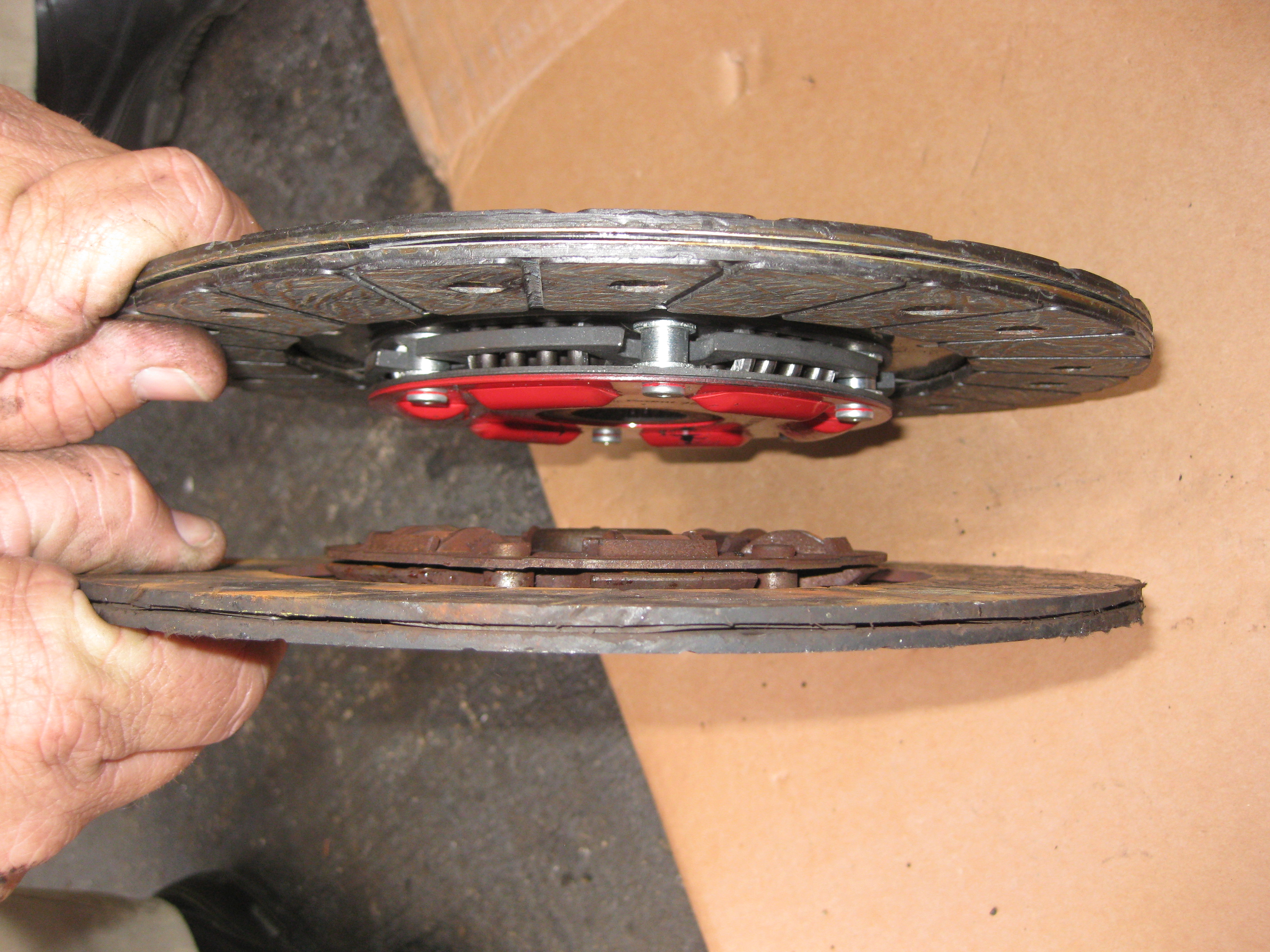

    Clutchnet sent a "stage 2" pressure plate and disc to my dealer...supposed to be 15% stiffer than stock. In addition to the disc and pressure plate the clutch master cylinder, clutch slave cylinder, and throw out bearing were replaced. The pedal would not go in so they had to take the tranny apart. After removing it they determined the disc had an extra part that kept the two pieces from meshing. I sent both parts back to Clutchnet who repaired and sent them back.
    The clutch is now back in the car and the pedal goes in. When the car is off the tranny shifts freely. However, with the car on, when the clutch is pushed in the tranny cannot be shifted. You can see the pin under the air cleaner moving when the clutch is pushed in, but somehow it seems to not be disengaging the clutch to allow shifting.
    Has anyone run into this problem before? I have been without my car for months and really want to get this resolved. During the past few years I have invested thousands in parts for this car, but at this point I am really thinking about selling it.

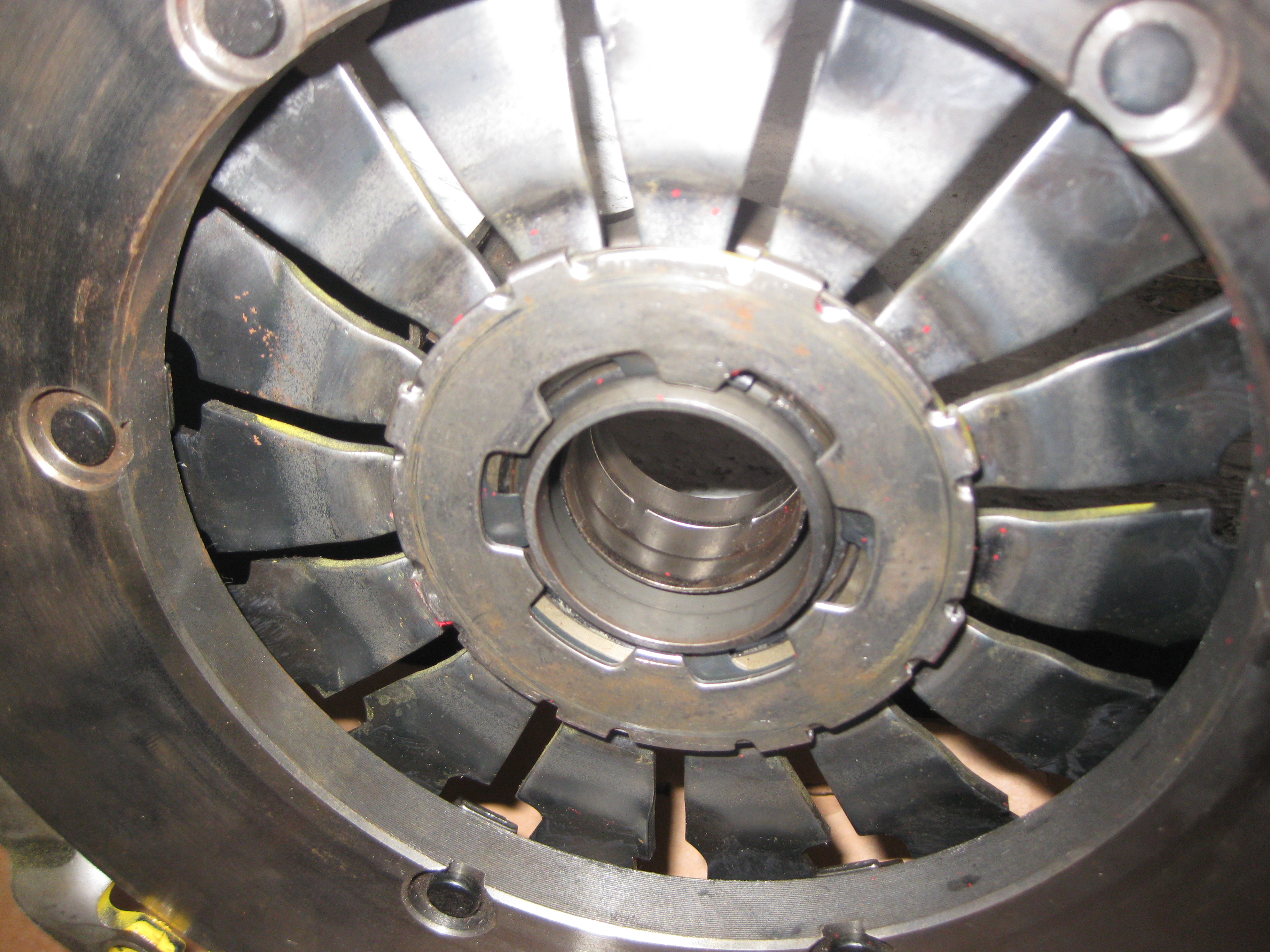

        There is no adjustment on the 284 for the clutch. Either it works or it doesn't. I'm willing to bet it's the clutch disc. I also bet that if you start it up with it in gear, it'll want to take off on you.
        That clutch disc seems like it sticks out wayyy to far. Those fingers on the pressure plate look like they have more wear than the plate does. ( the fingers shouldn't have any wear ) What it looks like to me is that the center of the disc is farther out than it should be, and is hitting the fingers on the pressure plate, and even when you put the clutch in, there's no room for the fingers to move to disengage the clutch. Which is why you cant get it in gear when its running.

              Looks like the wrong disc. Clutch is probably engaged all the time which is why the trans won't let you shift into gear.
              You can confirm that by putting the front up on jack stands, put the car in 1st then start it. Wheels shouldn't move till you let the clutch out.

                The clutch disc that was removed is a Centerforce disc that I put in there...believe it or not...about 1995. It lasted a very long time.
                At this point, I believe my best option would be to get an actual new OEM pressure plate and disc. My challenge is finding them.

                  You said you sent this clutch assembly back to Clutchnet for repair. I would call them and ask why when you set the disc into the pressure plate assembly (as shown in your 4th picture) it does not set flat into the pressure plate assembly. It appears to not be a matched set. The disc center section projects to far out from the disc face and is hitting the fingers of the pressure plate assembly. Again if me, based on the fact that they supposedly repaired this assembly I would return it for refund and use what you have had good luck with, Centerforce.

                    Just to clarify, the pictures above were taken before I sent the parts back to Clutchnet. With those in the car we couldn't even depress the clutch. Clutchnet repaired/replaced the parts in the pictures with others that were sent back to the dealer and put in the car. With the replacement parts in it the clutch depresses (with a good bit of effort), but the gears can only be changed with the car off.
                    What I really need is a new OEM pressure plate and clutch disc.
