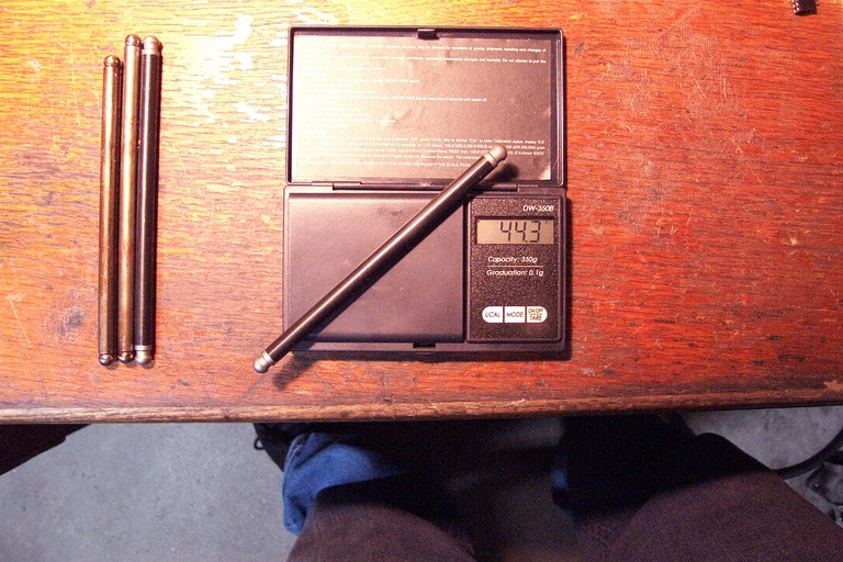

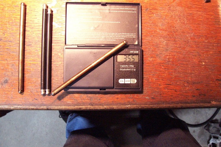

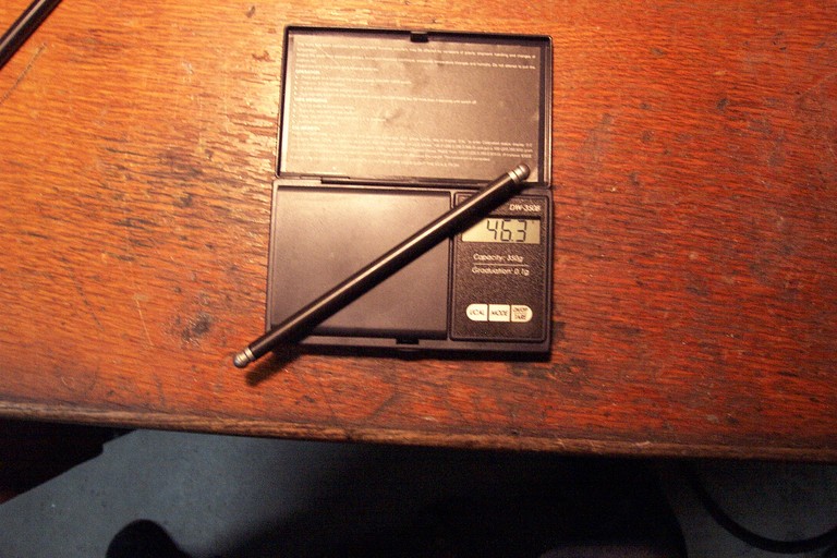

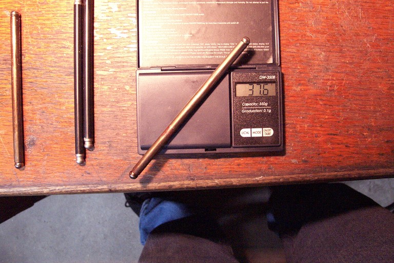

    "The Milzy Motorsports Lightweight High-Performance Chrome-Moly Pushrods are made exclusively for us and your 3100/3400 engine!
    These pushrods are made to the exact specifications of stock pushrods but are stronger and lighter. These pushrods are a great addition to your 3100/3400 engine with our custom cams or stocked cammed car. The weight savings these provide will decrease valvetrain weight and therefore decreasing valvetrain float and allow the engine to develop higher rpm's."
    The gold looking pushrods are stock 3100/3400/3500 pushrods. The black and silver press on tip pushrods are the Milzy Motorsports pushrods.

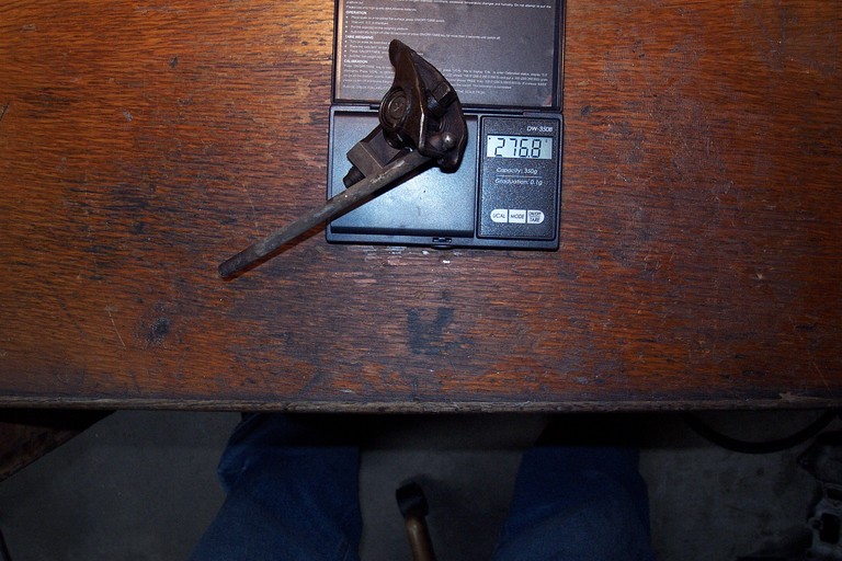

          My interpretation of how mike weighed a stock pushrod for comparison.

              so what you are saying is the performance pushrod is heavyer then the stock ones well thats sucks then

                The pushrods are also the wrong length for his cams even though he claims they are made to work with each other. They may work but they are not the right length for proper pre-load.

                  Who cares about weight on the pushrod side. Your concern should always be stiffness in this area. The speed on the pushrod side is slower than the valve side but the spring load in amplified through the rocker ratio and this is why stiffness is you number one concern.
                  So to anyone who has a brain these rods are advertised completly wrong along with being the wrong length as Ben pointed out. So really its a big fuck up all together and Milzy sucks like I have said since day one when I saw "Performance Cams" offered with not a single spec published.
