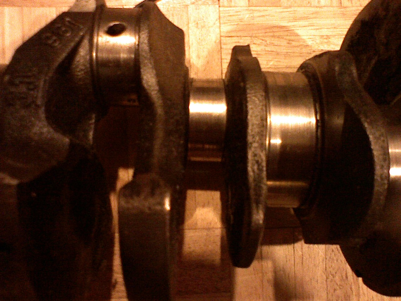

this is pretty bad isnt it

    Kinda hard to tell from those pics, but the prognosis doesn't look good.

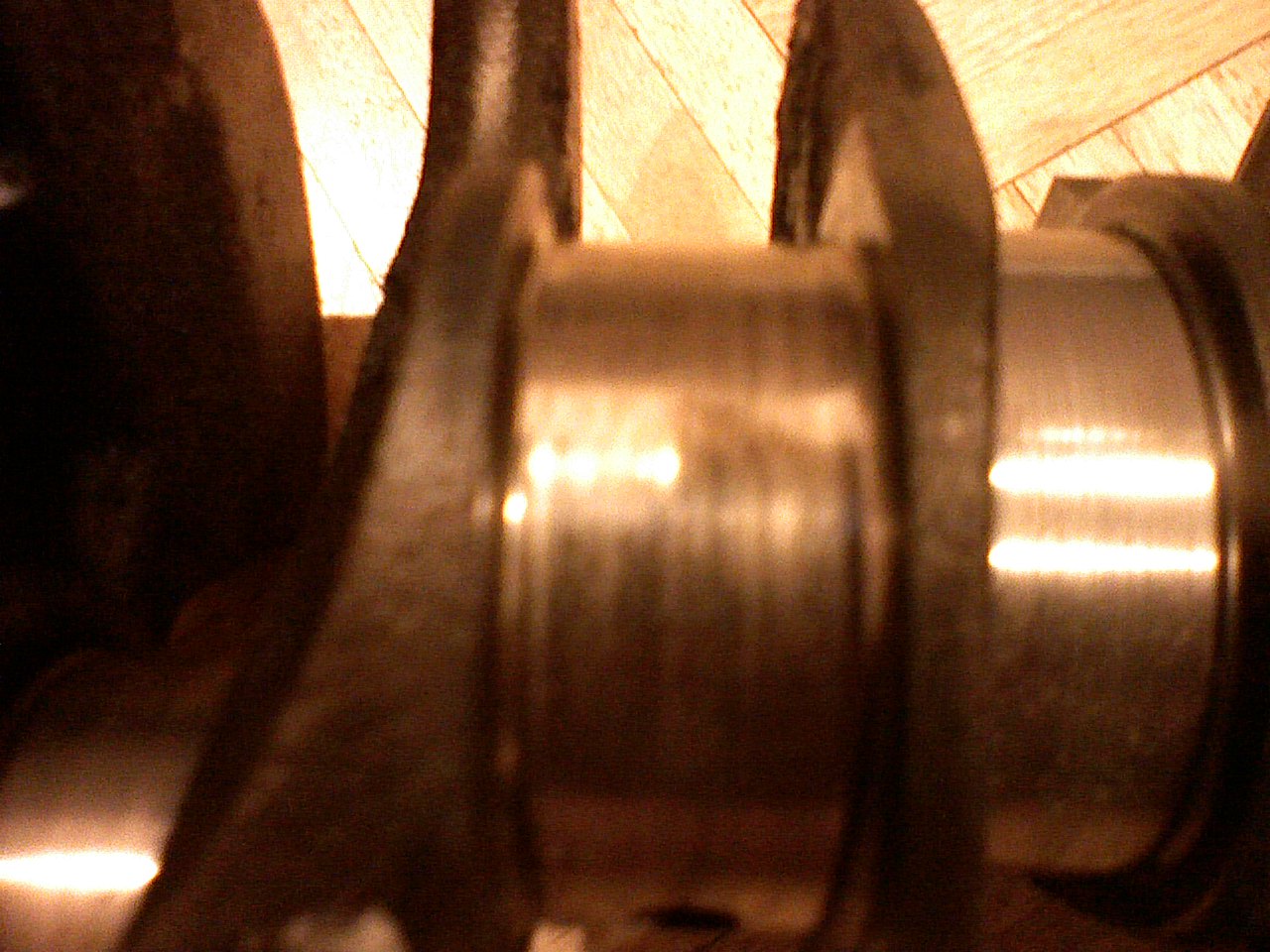

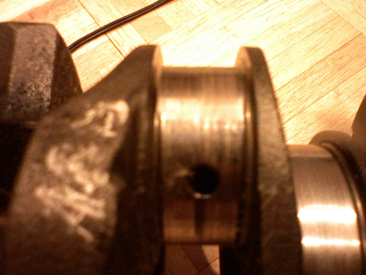

        ouch, did some1 spin a bearing or 2? it may polish out but i wouldn't bet the farm on it.
        • tractorman
          • 451
          Can't see the pictures real well... but that crank looks ruined to me- especially that second picture. My guess is that you need to have it re-ground, get a crank-kit, or a whole other motor.
          Did any bearings spin? If so... then the rod bore or main bore that they're crushed into is toast.

              • gpse3400
                • 1460

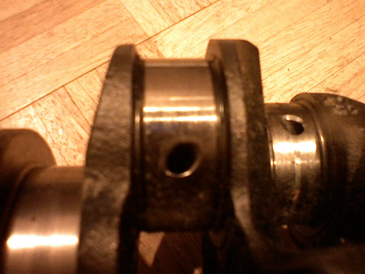

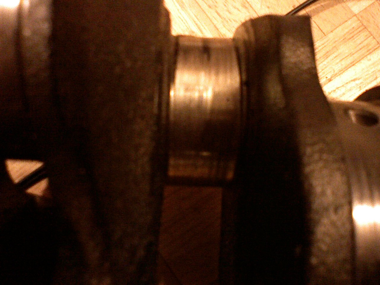

                Bought it from a guy off of ebay who said it was good.. I;m looking at tone of the rod journals and its so out of round, the filleting is gone on the sides....Not to mention the counter wights have indentations like he droped it a few dozen times....

                  HMMM, looks like he tried to use it as an anchor...for his car and dragged it down the street,lol.
                  Actually it is no laughing matter, sometimes you take a chance on getting had from e-bay.

                    id contact the guy and tell him that crank is trashed and try to get ur money back
                      that's good for a core on a new one.. that's about it.
                      my old 3400 crank wasn't even that bad and it spun #4 for 30 min on the highway...

                          that is good enough to maybe make a table lamp out of, or put a leash on it and take it for a walk.

                            you could dig a sand pit and have a crank tossing contest... that might be fun
                            But in all seriousness if it's not warped then you could have it welded and offset ground... Stroker!

                              Yeah I contacted the guy last sunday and politly asked for my money back. And he returned all of it...Amazing...
