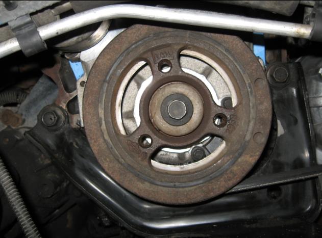

                        The rubber ring is embedded inside the damper. You can see it if you look. I'll try to find a picture.
                        • IsaacHayes
                          Mr. Orange.
                          • Apr 2006
                          • 6030
                          Rubber between the 2 pieces.

                            ok if thats there for a reason on the stock one then why when they made the ud pulleys didnt they incorporate it into them.
