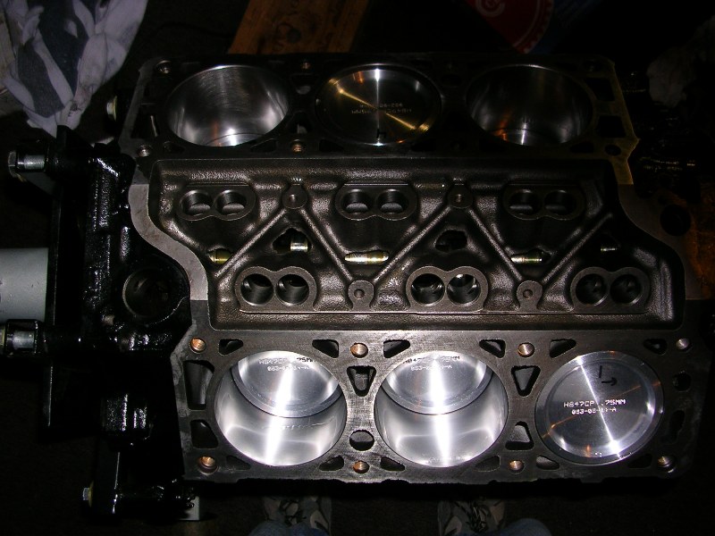

              I will try to post pictures tonight. I took a picture of valve stem seal installed over the valve guide. I did not take a picture of the valve guide itself because to the naked eye it looks fine. The guides are not loose.
              I put the engine at #5 TDC to work on #2 but the valve traveled too much so i pulled the spark plug and verified #2 was not at TDC. I continued to rotate the engine clockwise to get #2 at TDC and when it got there #3 was at TDC. Explain that.

                I can't explain what happened with you, but here is picture proof, 1 and 4...
                  And a P0401 is a Exhaust Gas Recirculation Flow Insufficient Detected... why are you doing valve seals?
                  Ah, i had it backwards...#1 is right front not left front of the engine. That was confusing but it is cleared up now. I am not familiar with 3100 engine, i apologize.
