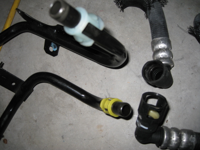

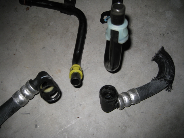

                          Here are a couple of images of the set I took off of my LX9/3500. I used my existing LA1 lines and quick disconnects.

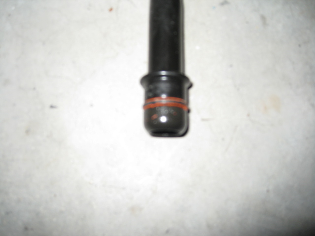

                          I suppose that you mean the O-ring shown in the third image?

                            YeeeAp that looks like it.
