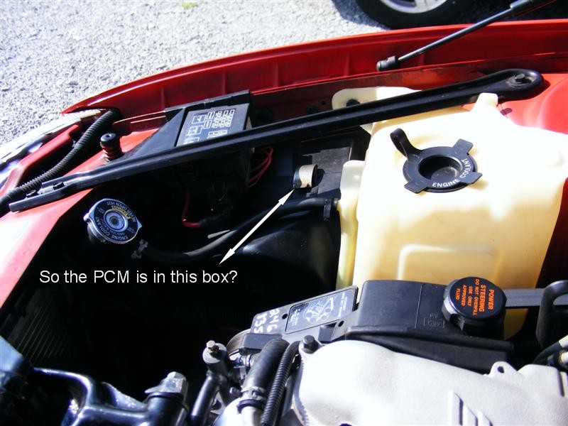

    Need to locate my W body 1997 Monte Carlos PCM location as i have another pre-tuned Pcm on the way...sorta like playing where's Waldo

    It's in a black box underneath the relays that sit right in front of the coolant jug on the right side of the engine. Take out the jug and those relays and there's a couple metal clips to open up the box and get to it.

      Thank you jman..Why did GM place something so critical in the outdoor elements....Tom
        almost everything OBD1 was located in the passenger cabin, with the exception of corvettes and w-bodies. corvettes and W's got weatherproofed ECMs though. i assume when OBD2 hit, they all went underhood.

            N body are in the car still so I guess W body just kept it under the hood.
              weird.... so they made them weatherproof, but still kept them in-cabin?

                Always wondered what was hidden here.......Tom...Thanks all

                  that's exactly where it is on a 95 3100 and LQ1 MC. good to know that doesn't change.
