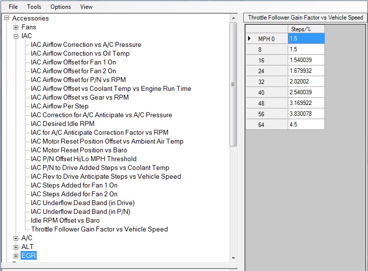

                This is whats avilable, let me know if you think any of it could help and I'll let you know what values exist there currently.

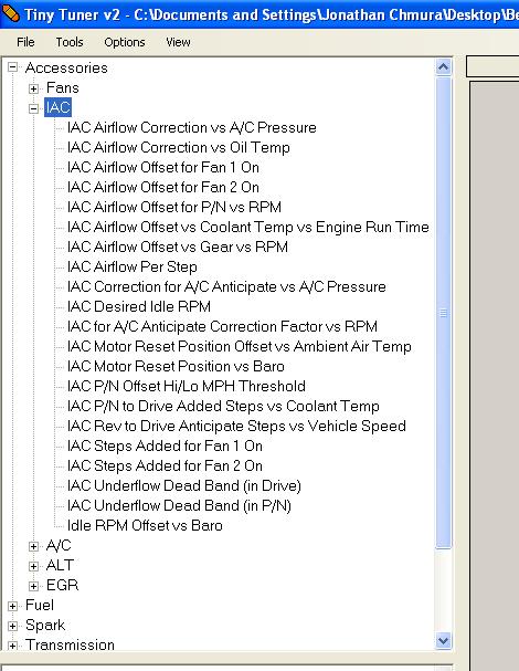

                        Assuming you can read/flash your cars PCM and If you can obtain your cars PCM file in BIN format, you can alter your IAC responsiveness somewhat.
                        Use Tiny Tuners.......if your OSID isn't supported, there are ways around that with the data base file. Easy to edit.
                        In the PCM file opened by TT there are a slew of tables pertaining to the IAC. Some I edit more than others are Throttle Follower settings.
                        Most settings are in the Accesories > IAC area, but two important ones are also listed in Uncatagorized which are.......
                        Throttle Follower Disable Delay vs Gear
                        Throttle Follower Disable Filter Time Constant vs Gear
                        Working your way through these settings and some trial and error, you'll find the right IAC settings for your ride.

                          Go back 4 posts and look at the image I posted.

                            looked through mine and the only one i have is the throttle follower gain factor vs vehicle speed none of the ones listed under the Uncategorized area, not much listed under that on my bin.
                            might try playing with that one on mine since i have a similar issue like Jon has. mine does it when it downshifts from 2 to 1 but that's more of a blip but it sounds like it almost stalls but bounces back, but that's part of the problem. sometimes it will start up fine but then others i have to feather the gas to keep it alive since the idle likes to bounce when it starts.
