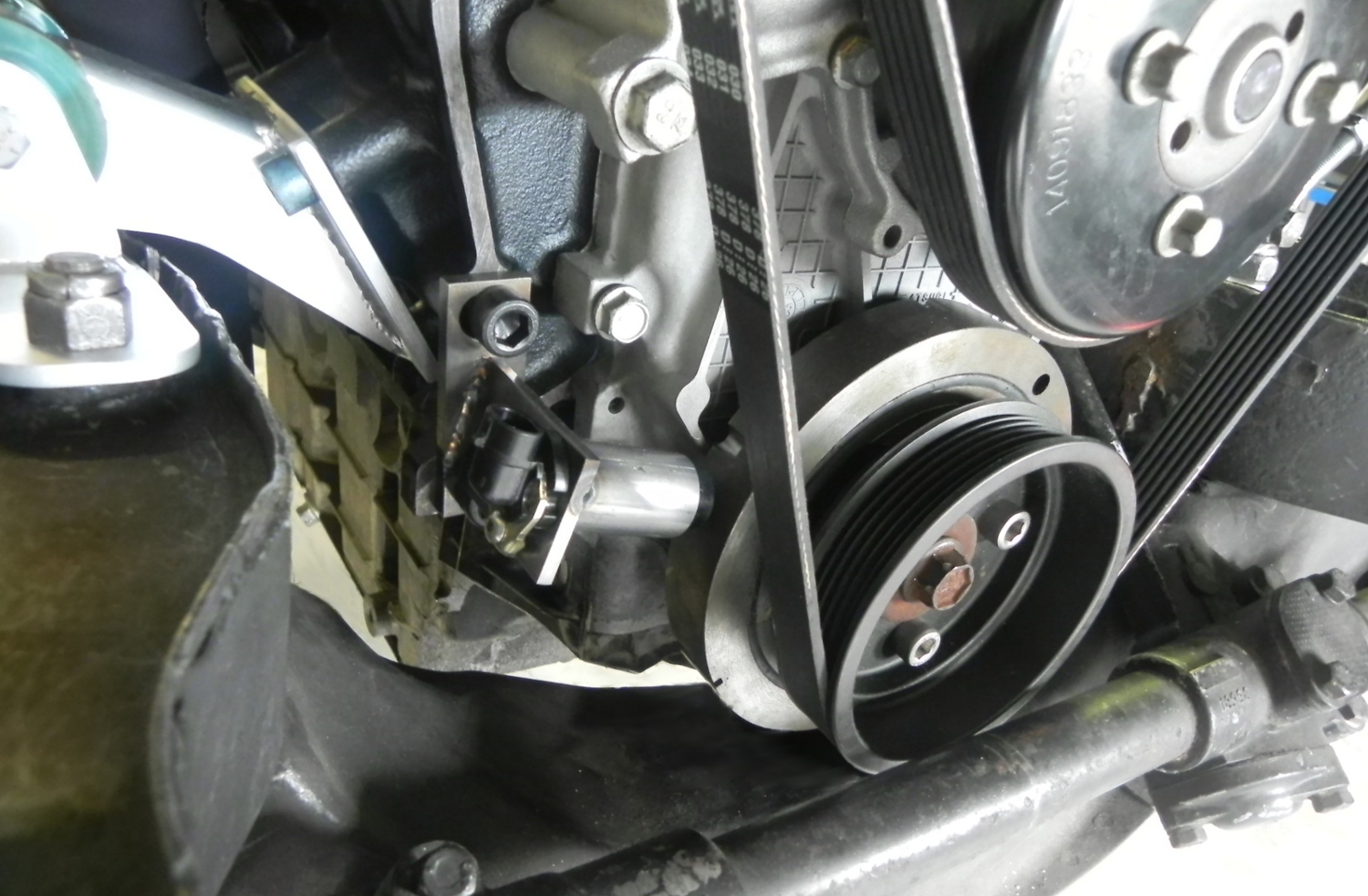

          The external crank trigger kit you are referring to will not work with the RWD pulley setup. We recently made a small batch of triggers designed for your application. The kit includes the CPS mount and a new dampener with the timing notches machined into it. See picture below of the prototype.
          What transmission are you planning to use?
          I don't know of anyone with FWD 60V6 Spitfire conversion but we have done a 3400 TR3 and have customers who have done or are doing TR6 conversions. The majority have been with 3400s but one of the in process ones is a 3900 swap.

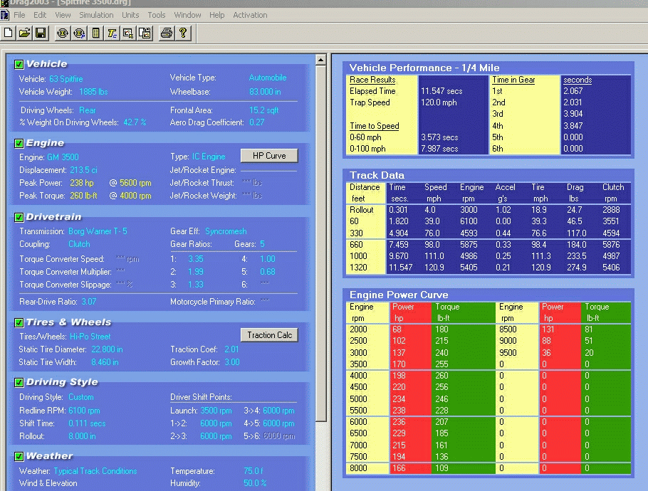

                        Using those numbers in Dragstrip 2003 gives me an 11.66 @ 120mph in the 1/4 mile and 0-60 in 3.720 secs, not bad at all. .

                            Heh, those numbers are with a 2500RPM launch, when I switched to 3500 RPM they came out as a 11.535 @ 120.2 mph and 0-60 in 3.541 seconds.
                            Oops, the above numbers are with the Cadillac CTS 6 speed transmission, I forgot to change it back to the T-5 gear box.
                            With the T-5 and a 3500 RPM launch I got a 11.547 @ 120.0 mph and 0-60 in 3.573 seconds, 0-100 mph in 7.987 seconds - not too shabby.
                            As far as weight goes I've even sandbagged it a bit with 35 extra Lbs just in case I go over what I've calculated the final weight of the car and myself to be. I also went with 340 Lbs engine weight even though the information I have is 350 Lbs because I won't be running PS or AC and I figured I would lose at least 10 Lbs that way.
                              I weighed a 3500 without P/S, A/C or alternator. It was 340lbs with the stock cast iron exhaust manifolds...
