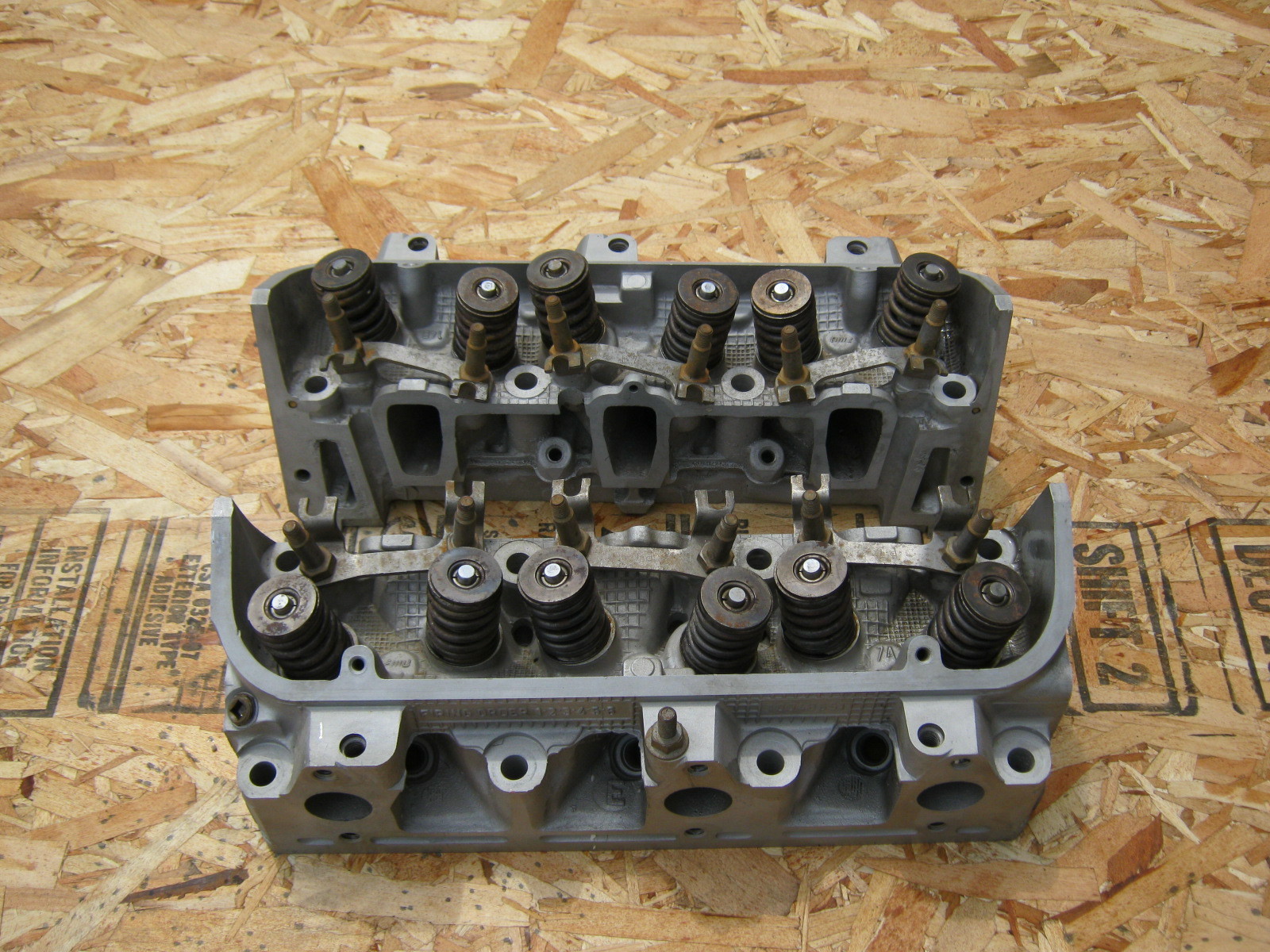

    I made an impulse purchase recently, and now I need advice on what exactly I've got, and what I'm going to need. What I bought is a set of rebuilt aluminum heads. They were presented as being for '87-89 GM 2.8L V6 for an S-10. Until now, I was under the impression that the aluminum heads were for Gen II engines, which were FWD only. What I have is an '89 Camaro 2.8L V6. Will these heads fit my engine? If they will fit, is it worth putting them on an otherwise good running engine? What would I need in addition to the heads, to make the swap?
    Aluminum were fwd only. You could swap them on and build a hybrid and make more power though, but you would need to do a bit of extra work. It's not a straight bolt on operation. I'm not certain what all is required but you should be able to find the information you need on these forums.
    On the flip side, I think those are gen 2 heads and if you are going to do a hybrid you should go with a gen 3 setup.
      Those are gen 2 heads. Don't waste your time with them. Sell them to a FWD guy or use them as a door stop, lol
      they could work with a gen 2 LIM and UIM but your compression will be stupid high and that setup flows no better than the iron heads you have now.
                What kind of compression are you talking about? Would the old trick of thicker head gaskets work to get it back to reasonable levels? Am I correct in assuming I'll need Gen 2 rockers and push rods also?
                If the head gasket trick will work, I guess I'll keep my eyes open for the necessary swap parts, and shelve the heads for now until my current ones are no longer up to snuff. Otherwise, if someone wants a set of rebuilt Gen 2 heads, I'll sell them for what I have in them....$85.
                  13.6:1 with .040 head gaskets and 12.5:1 with .060 head gaskets.
                  Yes, you'd need the correct rockers and gen 2 pushrods. you won't really be gaining anything but a headache with that setup though.

                    Yeah, way too high of a compression ratio <sigh>. If anyone wants them, let me know
