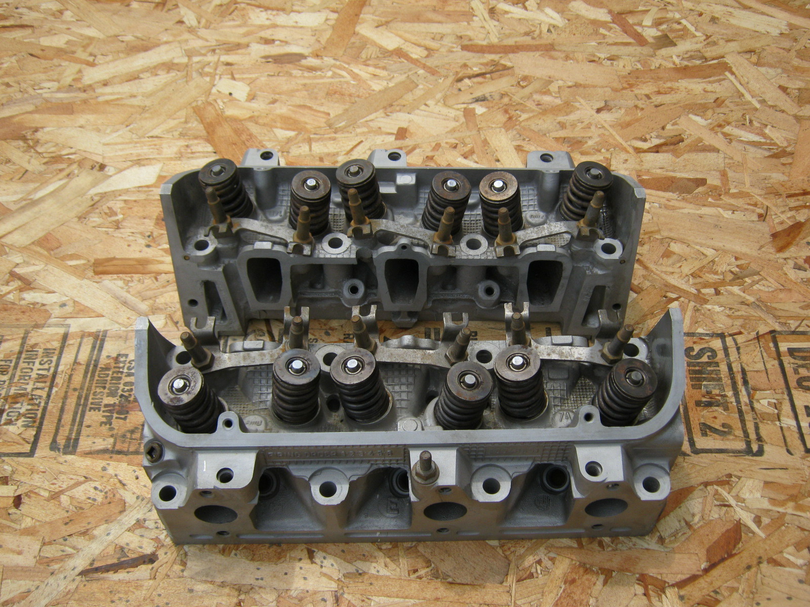

                  I do not know if they would work for you or not, but I have a set of rebuilt 2.8 FWD aluminum heads laying around collecting dust. They've not been used since rebuilding. They were sold to me as being suitable for my 2.8 RWD engine, and they are not. I'll sell the pair for $100 + shipping.
