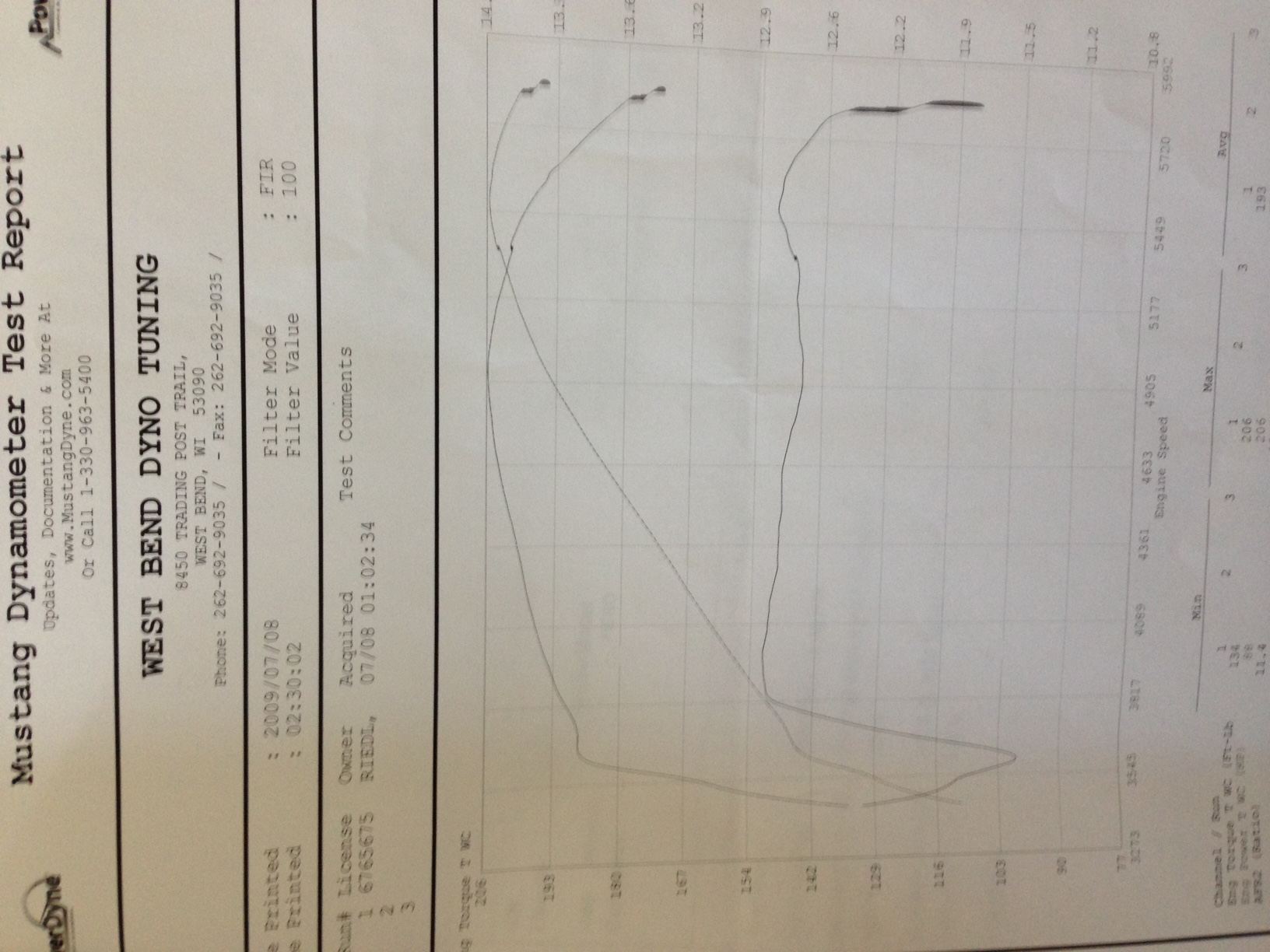

I only know of one person locking the cam before swapping to a wot cam. it was locked in the full advanced position(default). it still peaked at close to 5500 rpm or so for hp.Originally posted by neophile_17 View PostI have been looking at this for a little while and even bought and tore down the 3900's little brother, the LZ4. What I've determined from research is that the profile of the stock cam is designed to work with VVT. Several people have tried to pin the cam to a specific position or operate the VVT in an 2 position on-off way. The results I saw seemed to be universally underwhelming. I'll either try to get a MS to operate the VVT or get a more traditional profile for my build.
~sam
It made 206 whp that way. top end fell off of course because of the amount of advance it had. I think bringing it back closer to straight up position will help the top end although it might not need anything done and just run it with the vvt disconnected. Do you know of anyone else who locked it, and has a dyno of it? Here is Reidl's dyno and this was through the auto trans. He had a lz4 upper intake and tb I believe as well.
