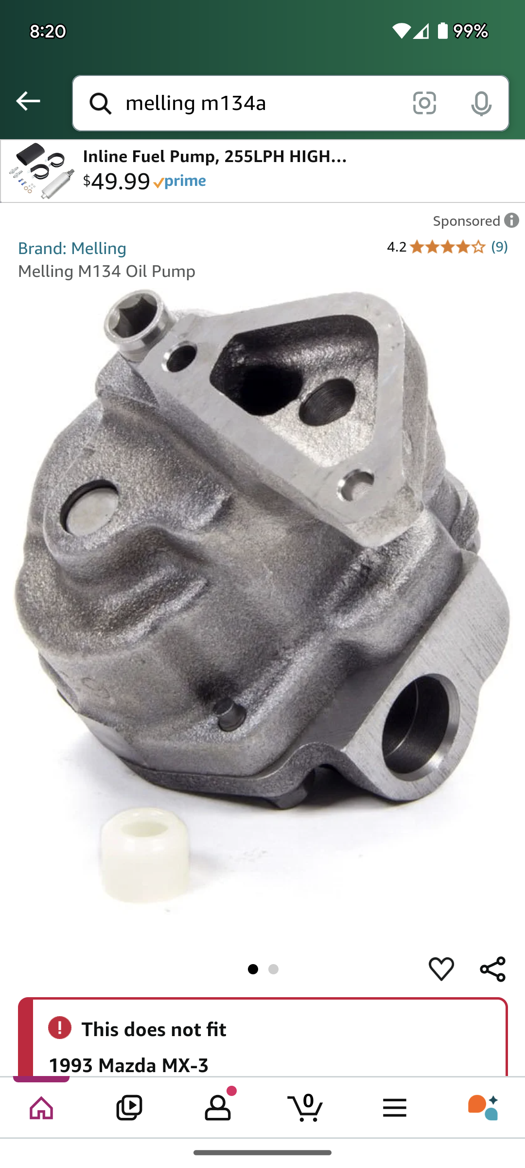

                So sorry to bother you again, and I really hope this image resizes itself. All I can find, just using amazon as an example cause it came up in my search, I can find a Melling M134, but I can't seem to find anything that says M134a. It looks right, but hoping to make sure.
                One more thing, putting together my list from your site, might as well go with stage 3 springs, awesome value! Are your seats and seals the LS style you mention? I might be sabotaging myself and causing confusion cause I'm looking at the cams under your 2.8 section, and moving to the 3100 section (3100) heads for the springs, seats, and seals.

                  Its just M134. I bet I was thinking R134A for air conditioning. Make sure you get a pickup tube to go with it. 251S.
                  Those in a .553" guide OD for the rocker rocker arm gen 3 heads.
