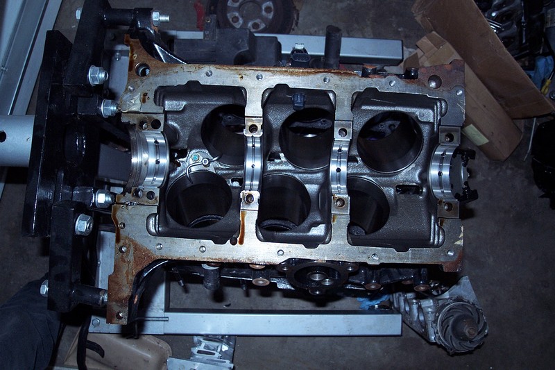

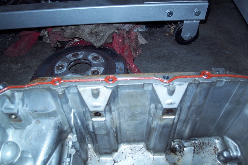

                    Yes, the 3500 block is notched in several areas to clear the crank. I can get pics tomorrow...

                              I had pics... But the drive that had them all crashed a month or so ago. Maybe I can take some tonight when the wife gets home from the movies. Don't really feel like leaving the 3mo old upstairs by herself...

                                Bottom of the block and the oil pan. If you need more pics let me know.
