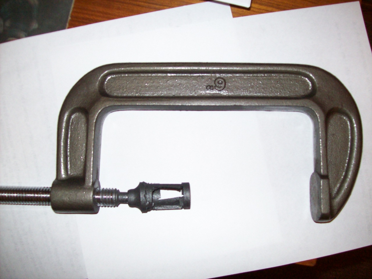

    Just saved 50.+ buck by making my own valve spring compressor. old socket, new clamp 6.00 little weld and whaaala:
    Not pretty but works like a charm!!

    What are you clamping against cause its not the valve. Doesn't look too safe for aluminum heads to me.
      Probably safer than the claw type... i hate those things.

        good point
        should have added I guess as some would think that metal on metal is a good idea. for the valve spring, I used a garden hose washer, for the valve itself, I used a small piece of old bike tire.

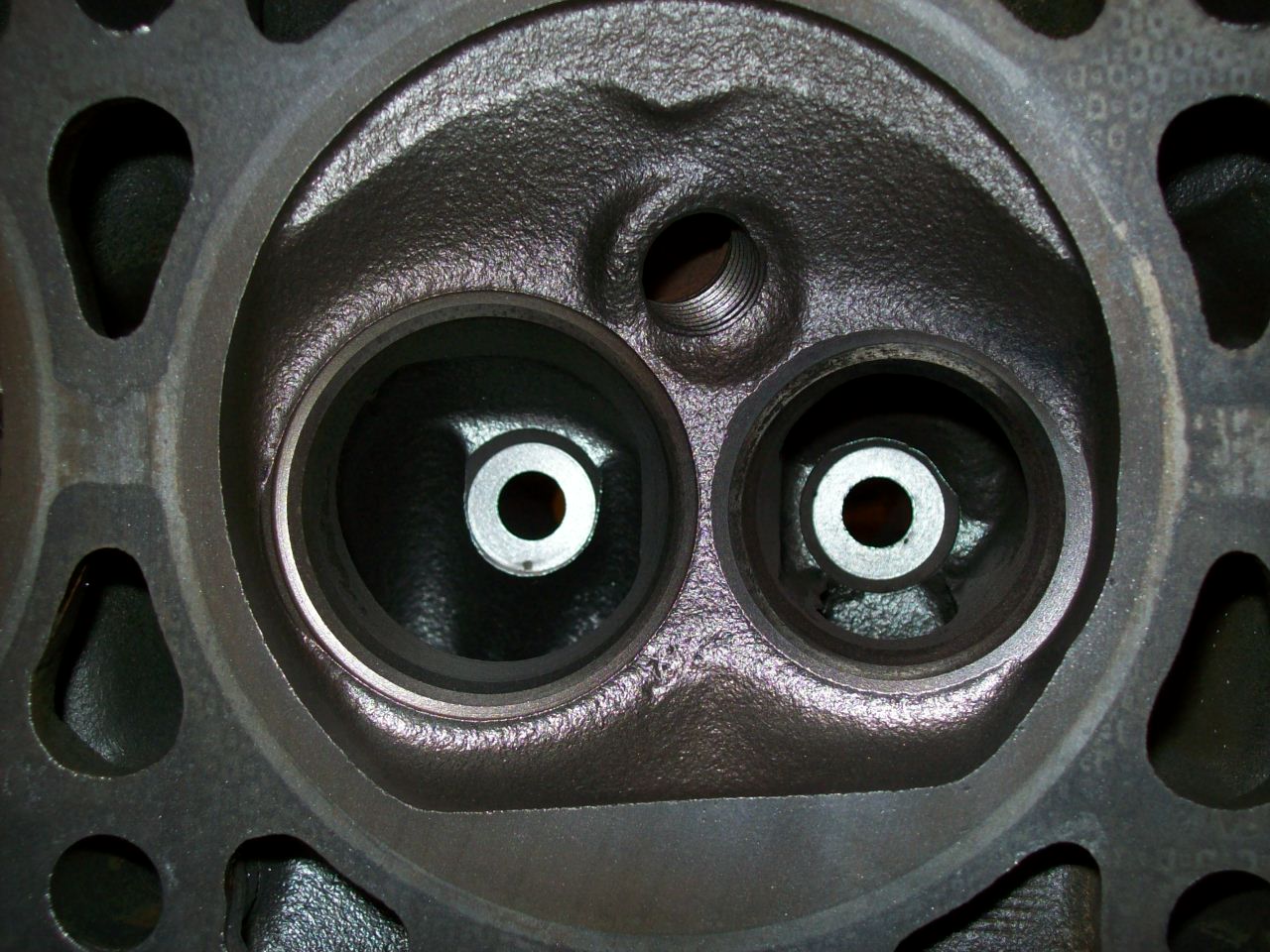

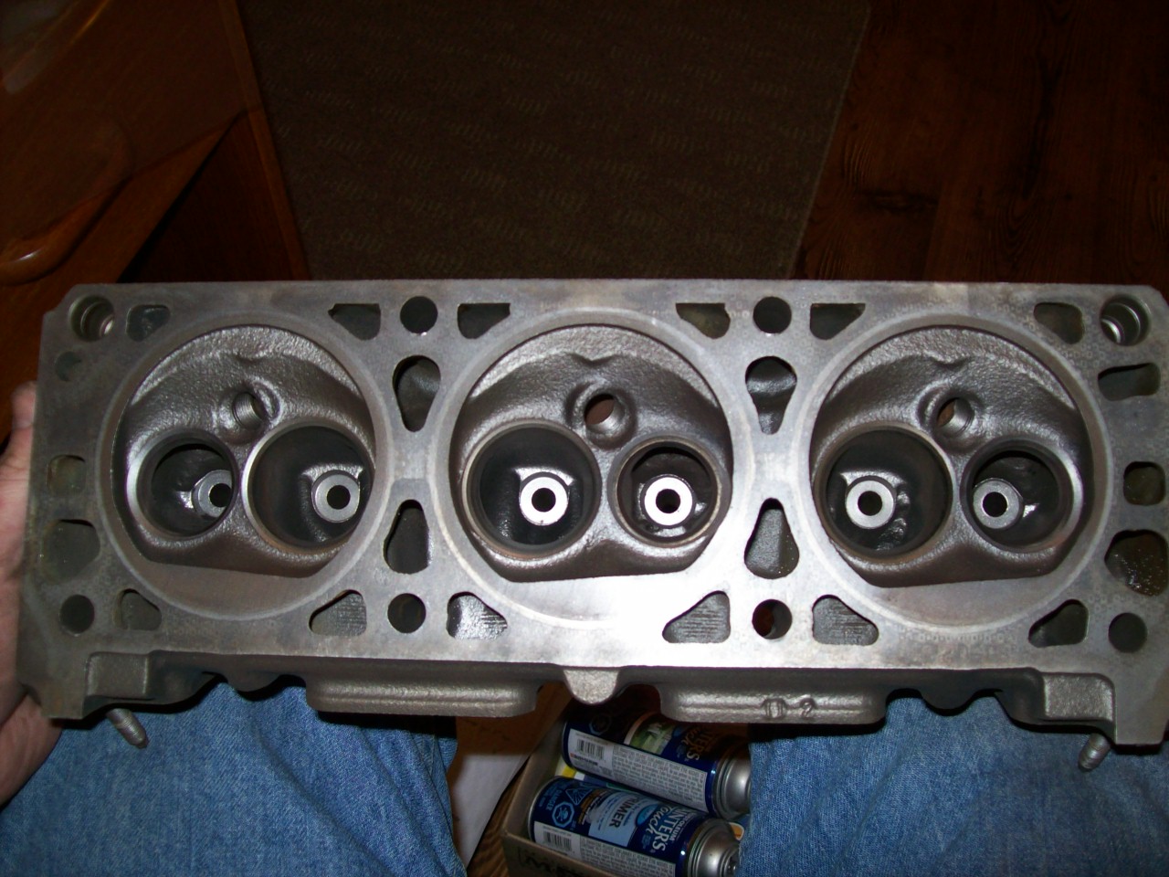

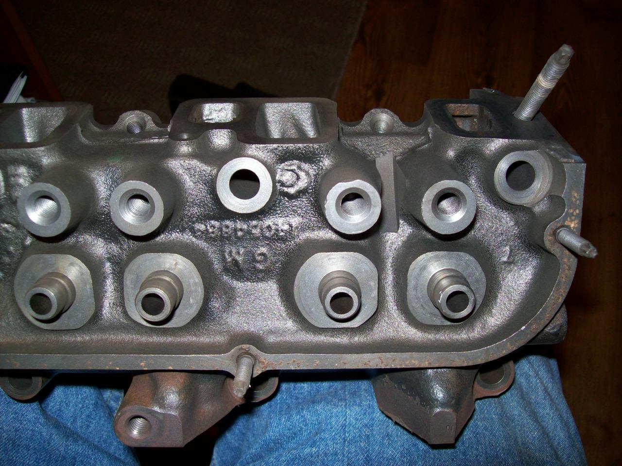

          One head done
          Well after safely removing Valve springs with homemade valve spring compressor, valve guides and bolts, used blaster with #6 glass bead and I think turned out great!!

            They look fantastic! Now you just need to port them to get them to flow a little better
            I'm putting some #6 beads on the shopping list since I have a few extra sets of iron heads laying around
            I bet the socket really helped to keep the locks and retainers from getting lost. Last time I was dissasembling heads, a retainer shot across my garage and went through a cardboard box 10ft away, and never found one of the locks. Looks like I'll be welding an old socket to my c-clamp type tool I just paid $30 for
