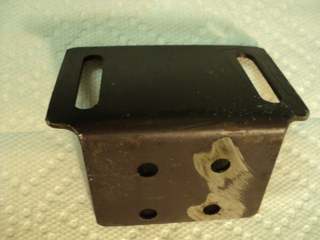

          You see.. I finally reasoned out that since the Multec II EFIS are fitted with sealing "O"rings on this new rail...AND... the fact that the precise hole I drilled for the tight fitting Acrylic Down Tube leading inside the EFI Cleaning Fluid Catch Container was air tight... unless I somehow managed to relieve the pressure building up inside the down drain portion of the system when activating the OTCs, then gravity drainage would literally be "Stoppered" before it could exit the tube right at the hole in the base plate of the Silver Tray.
          When I realized this was happening, the simple solution I came up with was merely to drill a 5/64th " hole through the edge of the green sealing screw cap lid adjacent the other acrylic pipe hole and then slip in a hand-curled section of a red WD-40 "spray tube". With the pressure now able to escape in a manner that would allow the free flow of compressed air inside of the container, I would still be able to keep the fluid inside free from any atmospheric dust and dirt settling in there. This problem definitely would have occurred had I just drilled a typical bleed hole and then let it go at that.
          The other problem was that I needed to make the hole in the bottom left hand corner of the silver tray for the Down Drain lengthy tube feed into the shape of an ogive (think of a 9mm Luger Parabellum Bulllet shaped hole in the lower base plate). This adjustment in combination with placing two tightly squeezing tight plastic zip ties around the curving portion of the tube allowed it to slide comfortably through the hole and neither bind nor kink nor slow nor stop the returning fluid from escaping all that clear acrylic plumbing up inside the tray.

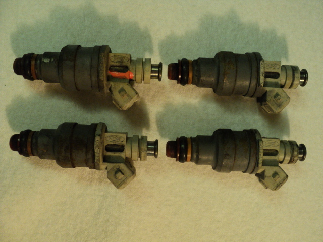

                    It's a bit late in the evening, but I wanted to get this entry in... As ever... Here is the link to today's work:
                    Earlier today, I worked on trying to break down the Delphi Fuel Injectors, Part # 25313185 ( Ac-Delco Part# 12569573) and ran into a significant problem. Unlike the old Rochester Multec I EFIs that have the in-dwelling brass-10 micron Fuel Filter Baskets sitting flush with the top flange of the injector, making its extraction with a sturdy sheet metal screw fairly simple... the later model Multec II design has the same style of filter baskets... however, they sit nested down deep inside of the upper flanged portion of the stainless tube giving access to the interior of the fuel injector. I had to study this problem closely with a magnifying glass and a flash light, but I finally decided it would be easier to just take some macro-close-up images with my Sony SteadyShot DSCS2100 digital camera and look over a raft of images taken at quite a few experimental angles until I could resolve the appearance of the working innards and the see problems the filter basket removal posed more clearly. Once I was sure that there really was a filter basket hiding down inside there, I took the sheet metal screw that shipped with the injectors as a removal tool and slowly screwed it down inside to a depth of about one or two thread and after clamping the screw head down tightly in my bench vise, I attempted to bend and pull on the body of the injector. I did this several times to no good effect and at one point, I was using so much elbow grease to try and pull that damned little basket out that I yanked the screw and all out of the vice.
                    I decided I'd better "Build a Better Mousetrap" of a tool to extract the things... and just about the time I was scanning my garage for the means to get to work on it... I flushed out a distant memory of something that my strange and mechanically challenged neighbour had given me many years before. I actually laughed out loud and exclaimed. "Bobby? WTF have you got there?!" when he showed up with what could only be described as an RPG looking thing ...with an armour piercing point at the tip and a heavy red cast iron slide that was reminiscent of the shoulder fire shape charge of the Mujahideen!. It weighed a ton and had some weird sort of internal spring that allowed you to pull back on the heavy handle and cock it like f*cking spear gun!
                    Anyway... after having that fortuitous "Total Recall"...I dug around in the lower big drawers of my tool chests and finally rifled it out. The cool part was that no sooner had I screwed the upper S/S nozzle onto the hardened steel screw point and then pulled down slightly hard on that heavy red handle...then.. Voila! Out popped the filter basket complete and intact..."...as smooth as D'Oyle Carte". I was quite surprised that such a heavy and robust tool could be persuaded to do something this delicate and not crack or destroy the polycarbonate body of the injector or scratch up the insides of that S/S flanged tube. The one other important observation I made was that there actually was a residue of super fine ringlets of brass metal shaving left inside the S/S tube further in and so I took some "Q" Tips soaked in carburettor cleaner and inverted the injector so as to dislodge, trap and sponge out those fine brass threads and avoid the problem of having them fall inside the injector and wreak havoc later on.
                    I used a S/S depth micrometer gauge and noted that the inside diameter of the S/S tube starts out at around 7 MM and at just above 10 mm deep into the tube, it narrows abruptly to around 6 mm. I will have to construct a tool that will seat the new filter baskets firmly inside that S/S tube and stop at the proper depth before driving it inside too far. My intrepid neighbour just gave me an old but sturdy Craftsman Wood lathe that I am hoping will tolerate my novice knowledge and skill level when trying to turn down a bar of Aluminium a little at a time and make this tool myself. I am open to the guidance and suggestions of the metal shop experts among us who've all probably just cringed and shaken their collective heads at this heretical notion. I have more than just a head stock spur and a dead tail piece to hold the rod in place, having just ordered a live tail piece cup and 6" adjustable keyed chuck.. if that is what they call it? So I should be able to centre it and take my time while shaving the metal down a little bit at a time.
                    If I sort out this tool issue, then sometime tomorrow, I'll finish doing the pulling and replacing of the rest of the filter baskets on this set of six (6) EFIs and finalise all the other cleaning operations before mounting them back on the 4 thGenFrank Machine for another round of pressure spray cleanings and then...Flow Balance Test Number Two.

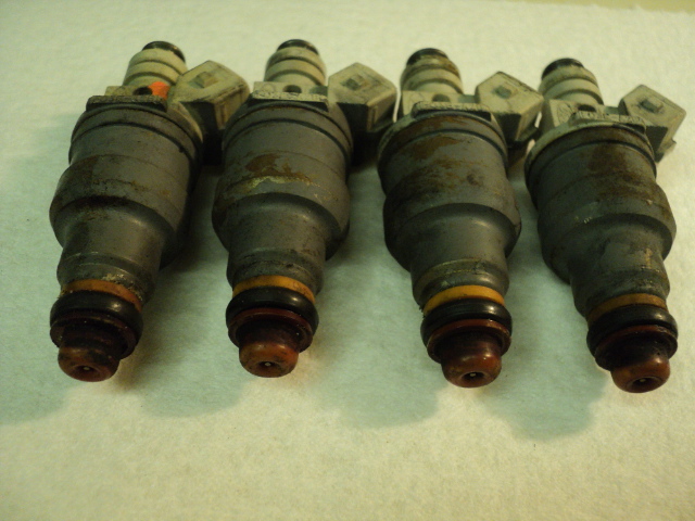

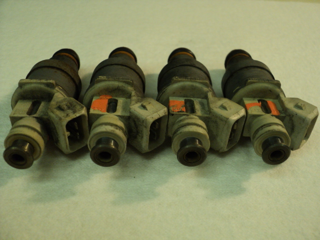

                      In spite of being "Holiday Bizzy", I managed to find some time to move on to the next phase of testing and proving out the 4th Generation FrankInjector Machine. I was happy that the new Fuel/EFI Cleaning Fluid Rail hooked up on both input lines, but I'm a bit concerned that the "unclean" set of 4.2L EFIs I put on there for the first pressure cleaning and Flow Balance test provided such sketchy balance results. The fact that the two center EFIs were so much higher in output and ultimate volume has me wondering whether my old design with a single, centered input pressure was an accidental stroke of genius in that the incoming fluid would naturally be pushed from the middle Schrader Valve body outwards towards the opposite ends of the fuel rail. But in this instance, Ive got two problems in that the new rail is around 23" long and the fluid in-ports start from the outboard positions and pressure push towards the center of the rail. I might be getting a little ahead of myself in worrying about this issue b4 having tested the next set of injectors. And that leads me to what I accomplished working on this evening:
                      As promised, I took another, dirtier set of injectors off of another Vortec 4.2L Fuel Rail and systematically cleaned them; starting with a very thorough external scrubbing and spray down with some spray carburettor cleaner and then took the Dual Harness off of the Forth Gen FrankInjector Machine by un-clipping the harness from the factory clips and just snipping off a few nylon zip ties. To speed things up, I completely removed the Green Locking tabs from each with the idea of relying completely upon the small push-release and locking lever that cinches over the small strut sticking out from the sides of each injector. This proved sufficient to keep the Metri-Pack seals under enough compression to exclude any intrusion of Purple Power Solution when these six EFIs were later cleaned under 55 degrees Centigrade fluid heating while the stuff was boiling around under the influence of the ultrasonic agitation. No leaks. No short-circuits.
                      I had removed the upper and lower "O" Rings and slipped off the Black Plastic EFI Protector/Insert Guide for the Intake Manifold without having to resort to cutting them off. Using a small screwdriver wedged lightly between the "O" Ring lands and grooves allowing the plastic ends to slip off without too much wrangling. Next, I re-attached the Dual Harness and after filling up the Eumax Ultrasonic Cleaning Machine with enough Purple Power concentrated cleaning solution to completely cover all six injectors, I submerged them and set the unit to run the heated solution for thirty (30) minutes. At the point where the solution got hot enough to steam a bit and when the ultrasonic activity was going gangbusters, I activated the Dual OTC units on all three actuation settings to ensure that the fluid was being allowed to enter and exit while the six pintles were firing. When this was done, I lifted the hot soaked six efis out of the bath and after undoing their harness connectors, took them into the kitchen sink and washed them for around five minutes in a plastic container exposed to very hot tap water. This action is necessary because the "soapy slick" feel from the "Purple Power" residue is impossible to just wipe off and would interfere with and corrupt the EFI cleaning solution if left in that condition.
                      Next, I put a few drops of 3&1 oil into the intake port of each injector prior to spraying cold shots of compressed air into the ports with the idea of not damaging the pintles or their springs in their cleaned and un-lubricated condition. Once sprayed out, I used that "harpoon" tool mentioned a few posts back to hammer-pull each EFI Filter Basket out from deep inside of each EFI. Now this is where it got interesting and problematic as it concerns "which test and exam should be done first" kind of a problem. You will notice from the many new photos I took of each of these cleaning and re-building phases that once the EFIs were spotlessly clean and just after extracting their in-dwelling filters... I laid them out top to bottom in line and took some post-cleaning condition photos. You will notice that one of two things were at work here:
                      1. The Fuel Baskets were cleaned so well by the action of the "Purple Power" solution in combination with the heated ultrasonic action that this would have obviated any requirement to ever pull them out in the first place... or...
                      2. These injectors had recently been replaced as new, rebuilt or had been serviced by the dealership as a Brand New Set just prior to the vehicle crashing and being junked as a salvage vehicle.
                      In any case... see for yourself... The internal 10 Micron Screens were PERFECT! So... from now on... before I clean a full set to see if the first instance in involved... I'll pull at least one filter out of one in the set and determine its baseline appearance b4 giving the entire set of injectors "The Full Monty". In this manner, I'll have a "Before and After" mode of comparison to work with and if they really do start out so completely "E'ffed Up" and then come away looking as good as these do... well then... there simply is no reason to R&R the filter baskets at all! I got a lucky break when I found just the right size slender hex-nut screw with a wide face for striking to install and hammer in the new filter baskets after lubing the inside of each injector and coating the brass ferrules with 3&1 Oil and after fixing each injector in a small vise, I used a plastic mallet to drive the filters in place. After that I simply pressed on the new plastic nose caps and installed the upper and lower "O" Rings in readiness for their installation on "Frank" after the holidays. I'll shoot two videos then of this newly re-built set showing their pressure cleaning status and their performance during the next Flow Balance Test.

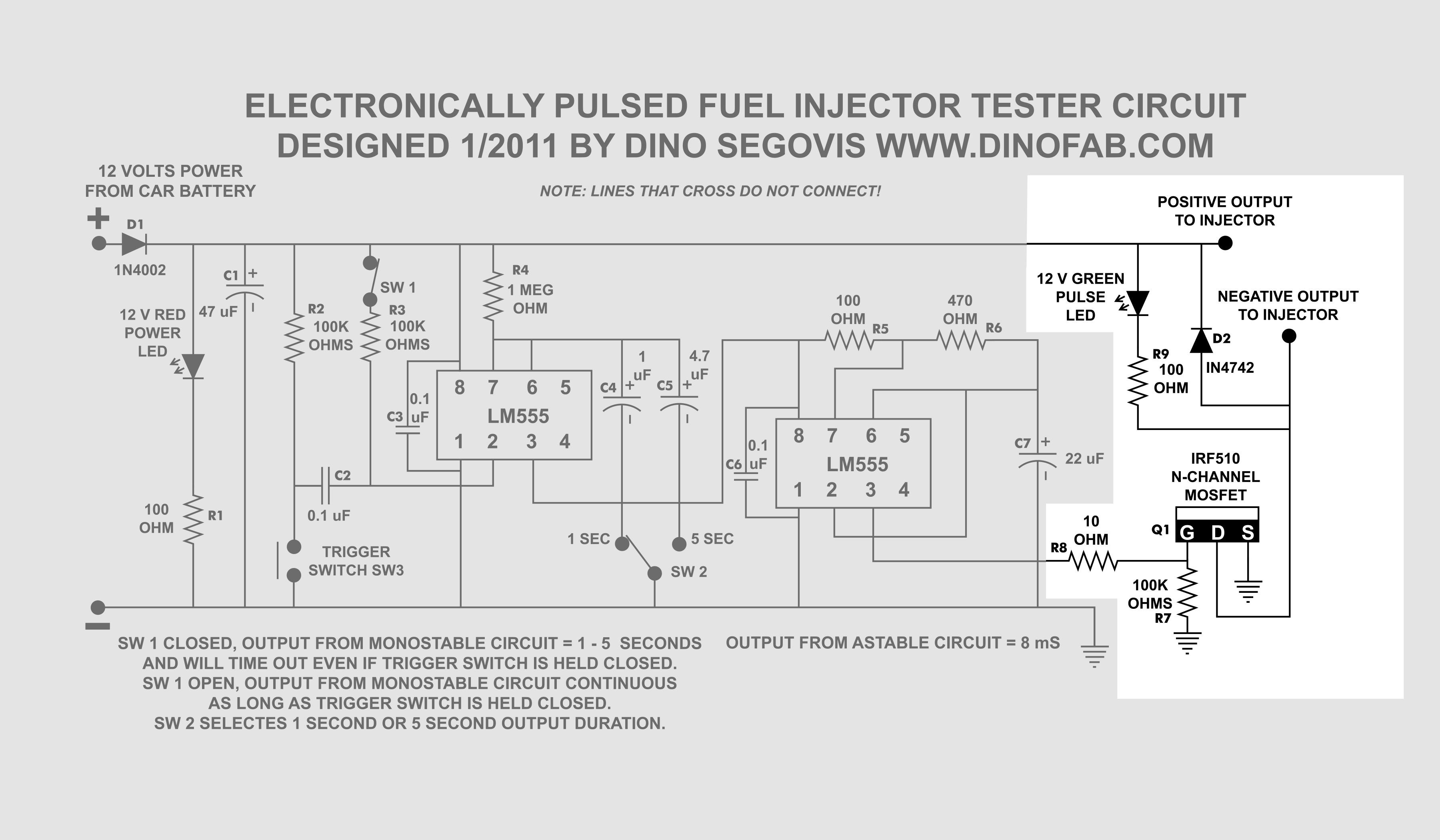

                        [Dino] is an auto mechanic and needed a way to test out fuel injectors. Commercially available tools start well over $100 and go up from there, but he built his own for about $20. The injectors hav&#8230;
                        Find information, resources and relevant links for dinofab.com. This domain may be for sale.
                        Well... It looks like somebody out there on "The Internets" has finally managed to design and build a cheaper version of the OTC EFI Tester and according to this site and video done by a Dude named "DinoFab"...he has included a parts list, several electronic schematics. bread board information, a seven minute video on how he designed, built and got the damned thing to work. He even has some follow up videos and updates on his design(s) at his home page. And ...most importantly... he even holds out the tantalising possibility that with the removal of one of two small resisters... his little controller might power one EFI indefinitely. The only question is ... How many of these units would be required to satisfy the EFI circuit power draw for more than one injector... say for 4 ...or 6...or even 8 EFIs? I don't know anything about this kind of stuff... but HE DOES and I DO know we have quite a few peeps that follow this thread who also understand all this electronic gibberish. So please...HELP!
                        Dino.... THIS LOOKS LIKE THE RIGHT DESIGN... NOW....I JUST NEED SIX OF THEM!!!

                          I received a rapid response to my Request For Help from The Man himself at www.dinofab.com, Dino Segovis concerning the use of his EFI triggering device design and the modifications required to duplicate its performance six (6) times...although I suspect making work for eight [8] or more would also be possible, as long as the power supply can hold up to the draw:
                          Hi Bob. I'm glad my work is of interest to you.
                          You can take my EFI tester and run multiple injectors with a simple mod repeated for each injector you want to trigger. Just build the circuit as you see it in the attached schematic, then build the highlighted section of the circuit for each injector and connect it to the output of pin 3 on the 555. The MOSFET handles the switching and the load because it's connected directly to the 12 volt supply. The positive output pulse from pin 3 of the 555 chip is what turns on/off the MOSFET.
                          Let me know how it works out.
                          Dino
                          The attached JPEG image shows the areas involved in the needed mod to this design. So...finally.... I can say...."THANK YOU, DINO SEGOVIS AT WWW.DINOFAB.COM FOR YOUR GENEROSITY AND QUICK REPLY TO MY NEED FOR THIS HELP!"

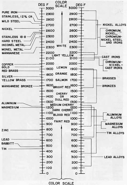

                              The attached cool (actually its HOT! ) and interesting image is from one of the numerous training PDFs available at this site:
                              More Naval Training Manuals (PDF Format) than you can shake a stick at!

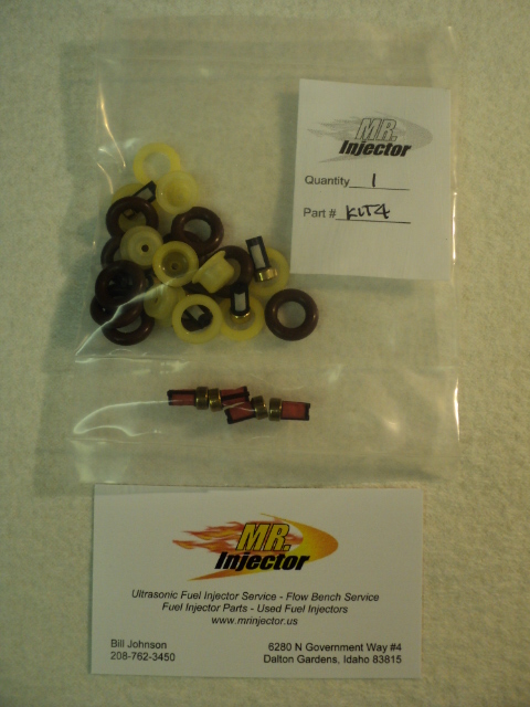

                                If you've seen my post, images and videos on “My Neighbor's 900+ Horsepower Toy” the blue early model Chevy Nova II, then your familiar with a man called “Eric” who makes his living as a Diesel Mechanic and, having seen the various generations of “Frank” in action with me at the helm of this device in my driveway, he was prompted to ask for my help after his Dad's 1993 Ford Tempo just died right there in the street in town leaving him stranded from a failed electric fuel pump.
                                After crawling around to do the dirty work of extracting and replacing that fuel pump in the Tempo, he thought about the poor condition of the old fuel pump and the in-line fuel filter and rightly surmised that after being pounded on and squirting enough fuel through the system for around 200,000 Miles... it might be a good idea to also attend to the four fuel injectors inside that little motor. Of course, I never say no to any of my neighbours when they need my assistance, so I told him I would do my best to clean, recondition, rebuild and bring the gnarled EFIs back to life.
                                The subject at hand worth mentioning here is that I have to be completely objective about the ability of “The FrankInjector Machine” to do as loyal a job on cleaning other than strictly General Motors Electronic Fuel Injectors. These are not our familiar Rochester Multec I or Multec II style of injectors, but factory OEM Ford EFIs Model# F03E-A2B (probably made by their supply line company: Motocraft). Unlike the all stainless steel, protected and submerged spinnerets of the Multec design, these high impedance injectors have a true pintle in the nose that requires a nylon cap to protect its delicate design. Without that cap, the pintle can either be bent, or broken off without much effort and render the injectors inoperative. The other interesting thing is that cleaning these style injectors for the first time will allow me the chance to tear them apart and memorialise each step of their re-conditioning.
                                Based on some very happy prior experiences of dealing with “Mr. Injector” for my EFI re-building supplies, I sent him (Mr. Bill Johnson) an email describing my unfamiliarity with these EFIs and he promptly alerted me that he had the right re-build kit to service the EFI Set, As usual, he came through with flying colours by sending me a very generous repair kit that even included four (4) additional red fuel filter baskets to service the Nippon-Denso style of EFIs should their innards turn out to be of that flavour. Using eBay, I dropped $20.00 on this set with free shipping and they arrived here, post-haste today. The weather is bad here today, so I won't be able to get to work on them unless the sun shines again and I can move "Frank" outside for the sake of safety and fire hazard. I'll shoot the proper break-down and re-build still shots and two videos of the pressure cleaning and Flow Balance Test by and by and soon we'll have Eric's Dad's car running like a top. The video link below shows a training session in which these particular injectors are being broken down for repair by Bill "Mr. Injector" himself:
