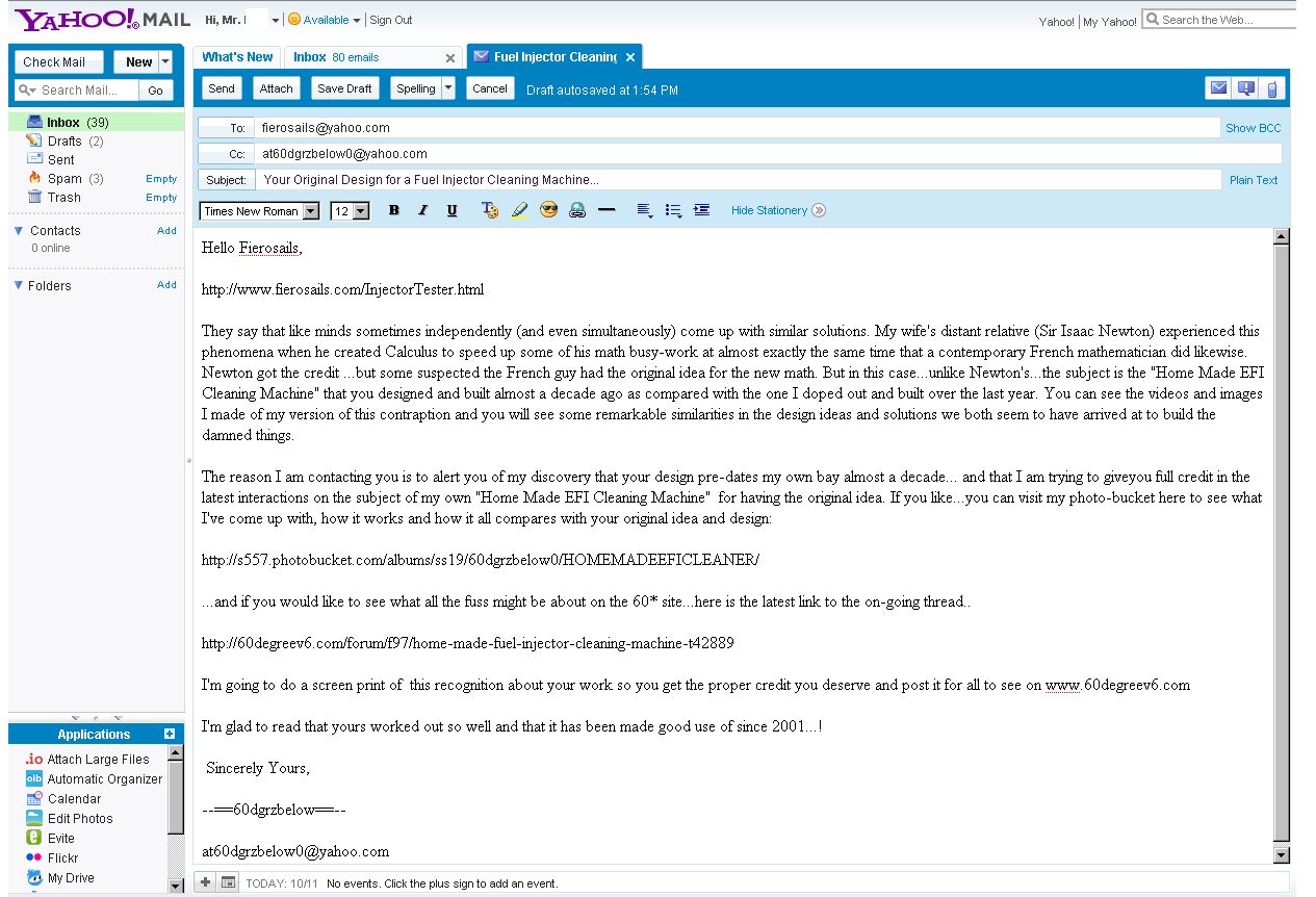

                          Holy Smoke... I think I found somebody...and he is a 60*er...too!!!
                          Votre magazine automobile et moto au quotidien
                          Its interesting that he chose to use the same general construct that I came up with, right down to using the identical GM Fuel Rail! But with the major differences between the two designs being that I finally mounted all my hardware in an organized 'easy-to-get-around' sort of vertical rack... while his parts and pieces seem to be mounted on a half-an-acre of marine plywood where he has to bend down on his driveway to work the thing.
                          The other significant issue of difference is that his device can only test one Electronic Fuel Injector at a time... having to use a stop watch in one hand, while holding down the power button in the other, while mine will do at least three and the pulses are pre-timed to exact fractions of a second. And still another issue is that his power/wire set up can only open and close as fast as he can press the trigger on his 12V finger button actuator, while the OTC Tester I'm using can force at least three injectors to fire 100 times in half a second. Like me... he was also very concerned with having a fire hazard with fuel substances under pressure in the presence of a possible ignition source, but I'm not sure how he would control a fire once it started (no Fire Extinguisher on hand), but now that I think about it, just because there was no extinguisher present in any of his photos does not mean he would have one on hand in an actual real-time situation.
                          I still think he has me beat though on his ability to power one injector open and hold that open condition while the EFI Cleaning Fluid (in his case... he chose to use Kerosene as the solvent) for as long as he wants to flush out the injector ...just as Superdave described earlier in this thread.
                          I'm still interested in coming up with something... with the understanding that I am not trying to approach some God-awful stoichimetric perfection here since I'm not burning anything...I just want to be able to activate all six injectors...and keep them sort of at WOT for a set time frame.

                              About this idea of mine and the resulting device that is now built... Now that I know that somebody else dreamed it up first, to be fair, I just sent an email to the REAL originator of this idea...gave him some props for thinking it all up... and let him know that HE gets all the credit for its design...attached is a screen print of my message to the man...
