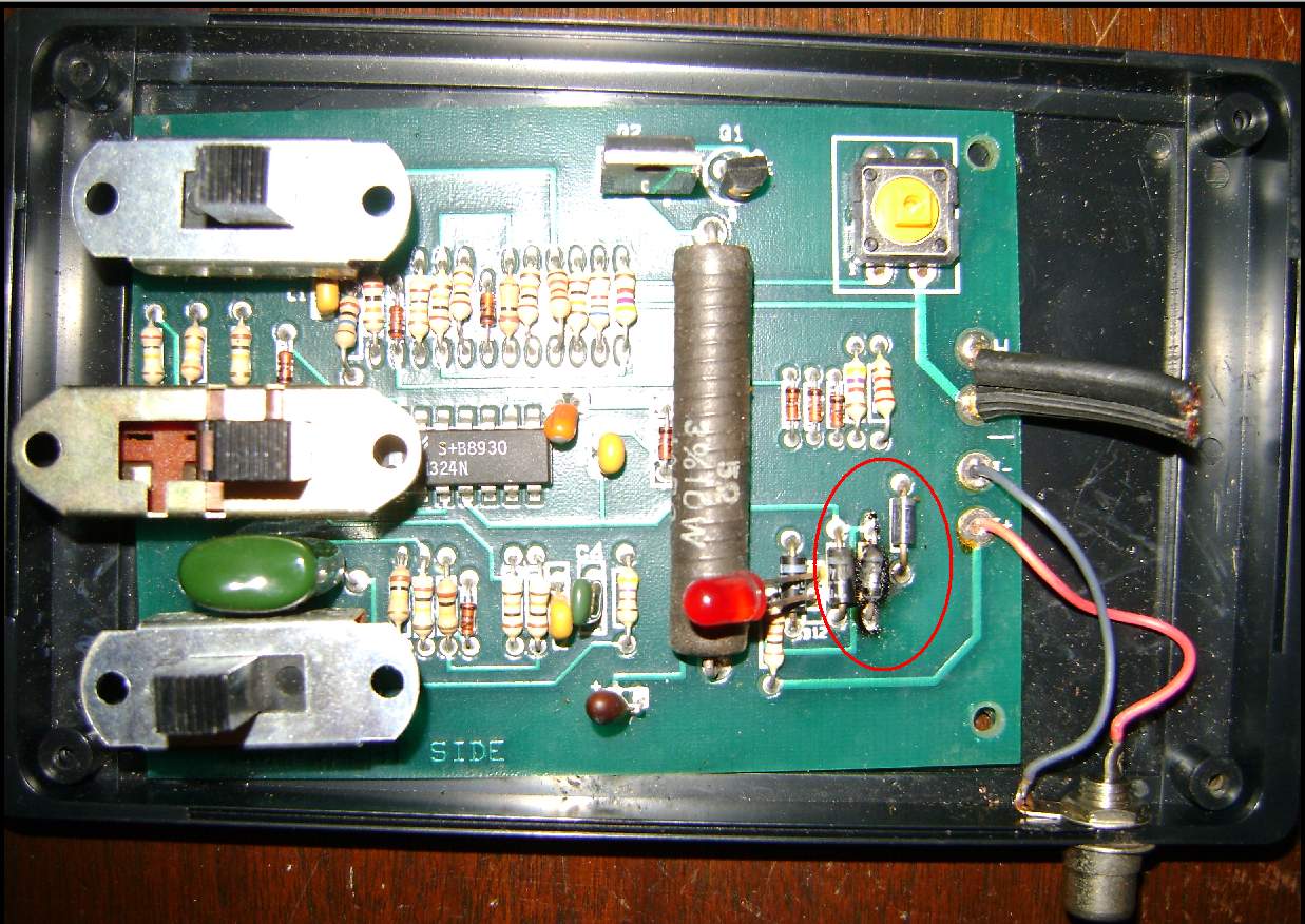

    odd... so the resistor for the LED blew up? or is it for another component?
    I'm not certain of what or why this burned...it is just adjacent the LED Lamp on the circuit board...and quite toasty as well... Speaking of "Roasted" The Lil Woman beckons me to "The Bird"...LOL Be back shortly... (Danny Devito used to say that...)

      can't see where the traces are going.... not sure if it's just to step down the voltage for the LED or what.

          Are you sure it's a resistor and not a diode? The silk-screening on the PCB under the component will say for sure. If it's "Rxx" then it's a resistor. "Dxx" would be a diode. Either way you'll need to find the value of it somehow if you're going to replace it.

            The shape of it tells me resistor, but I could be wrong. I do see it gets skinnier in the center, which is why I think it's a resistor. Have you followed the traces to see if it's the resistor for the Power LED? If it is, you wouldn't have to be exact in value of the replacement. More ohms for a dimmer LED, less for a brighter one.

                  I'll try to de-carbonize the area and the components nearby and shoot some more images of BOTH sides of the circuit board to give us all a better look at it. The board seems sturdy enough to support being repaired ...but not being very competent with electronic gizzies...If I can...I'll un-solder the parts and see what I can find that is a match. I hate not knowing very much about the subject... So if I do manage to get it working again... It will be a surprise to us all!. If nothing else...the EFI Connector box with eight -8- support wires can be used to make up two three wire harnesses for the EUMAX Ultrasonic Cleaning set up... We'll see what I can find out when I'm done cleaning off the "Burnt Offering" on that board.

                      Resistors and diodes are much more tolerant to soldering irons than things like LEDs and transistors so I'm sure you won't have too much trouble. I hope that it was just that part's time to go and not another component causing it.

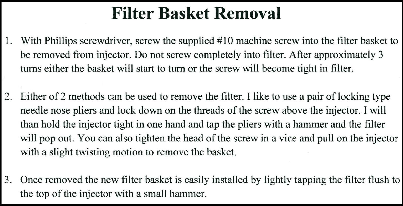

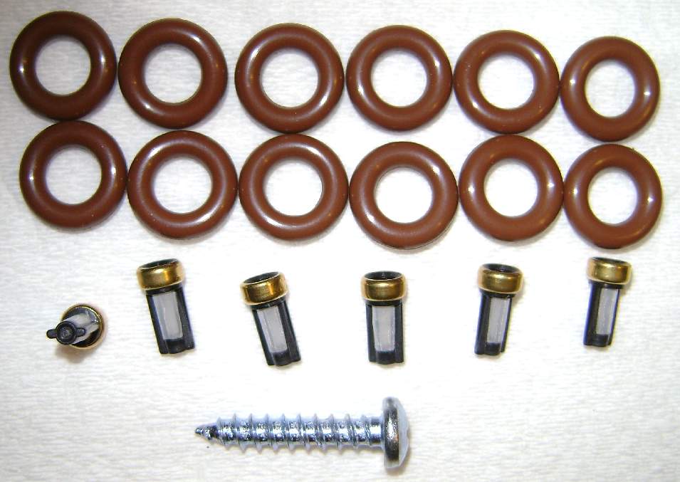

                            At the start of this project... I was trying to imagine what if anything would be able to "UNGOO" the varnished up, mung infested filter baskets inside of the Rochester Multec EFIs that have been the focus of this effort to clean and recondition them back into decent service. For some reason, I mistakenly bought into the Urban Mechanical Myth that... "You can't replace the little filters in the ends of the Multec Injectors...blah...blah...blah..." Well... Nothing could be further from the truth... and if there is anybody out there who knew otherwise... they should've jumped in and said something to us all about it sooner than later.
                            In any case... the purpose of the heavy-duty ultrasonic cleaning in the EUMAX machine using Purple Power concentrated cleaner to get this snug area cleaned out was the only option I thought possible, short of buying brand new injectors. But once again... while looking for one thing or another during my last post, I stumbled across this video that blew this EFI myth completely out of the water... (Pay particular attention to the color and munged up condition of the removed EFI filter when the VOP (Video-Original Poster) is describing its removal):
                            It followed on that with a little investigation via Google and eBay, I managed to find two major sellers of kits made specific to and precisely for... The Rochester Multec Fuel Injectors. I could not believe how inexpensive these kits are and how little is involved in doing the replacements ...especially the ones from "The Fuel Parts Store" on eBay... So I bought several packs of these sets and the close-up photos attached here below will show you what you can buy to recondition your EFIs even more in conjunction with the complete "body massage" offered using your own versions of "The FrankInjector Machine".
                            I think that doing this as part of the re-conditioning process trumps anything I could come up with to finally solve the last remaining question of "back-flushing" the EFIs.... and the kit sells for under ten dollars! So even if you don't want to invest in a complete build of your own Home Made EFI Cleaning Machine and you just want to run some cleaning solution through the EFI bodies via an ultrasonic bath or by some chemical spray methods after the old filter baskets are pulled out, having these brand shining new 10 Micron EFI filter baskets installed should go a very long way in reviving your gummed up "gas-spitters" and make your machine run with more power, efficiency and improved gas mileage. Enjoy!
