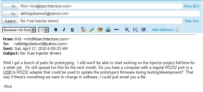

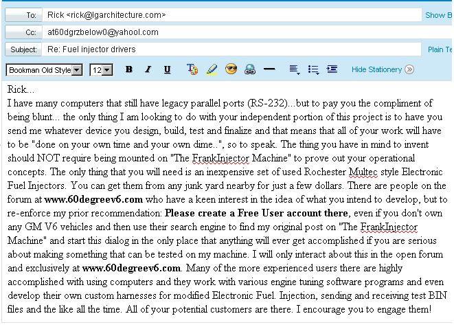

                  Okay... A New Development!
                  I have to say that I am fairly excited about a recent development concerning an email I received from an otherwise "shy" member/reader of this thread who also just happens to be an Electrical Engineer interested in developing his own "electronic control panel" that would serve to give some greater variability over how to activate and actuate Electronic Fuel Injectors. He seems very keen on what has been done with "The FrankInjector Machine" so far, knowing full well that it is wanting a more practical means of actuating the EFIs during the cleaning process than my solution of using the twin OTC devices...even to the point of allowing this to occur "unattended" (which I would never recommend). I have agreed to test out whatever device(s) he comes up with... with his permission and my understanding that he may want to design, build, market and sell what ever it is he manages to get to to work is a separate project from my own "Open Source" EFI Cleaning Machine. I'll keep everyone "posted" as we correspond about this idea.
                  Okay... As much as I am seriously interested in this Gentleman's idea about creating his own OTV means to actuate and variably control Electronic Fuel Injectors... I'm a bit frustrated with the idea that he has not addressed this matter openly in this forum thread where he and others would have a better chance of interacting about what he is attempting to do. Instead, he is trying to accomplish this in the vacuum of sending and receiving personal emails to me on the matter. The attached screen prints are of his latest communique, stressing that in all matters relating to my end of this project... and my response to his request.
                  The man may already be a member here... but since I have no way of knowing or confirming this to be the case... I made my latest ( and last) request for him to join us all here and try to help him with the development of his unique EFI "Driver" device. I will not be interacting on this matter unless it takes place on the site of its original posting: www.60degreev6.com. There are many of us here who might enjoy working with this engineer in making something that I would very much like to try out on " The FrankInjector Machine" and end the problem and complications of having to employ two OTC units to get the job(s) done correctly. It has been a very long time since this thread was started in order to answer this very specific question.. .and it has not been solved yet... But I think this fellow is very capable of doing the job...and I am hoping he will come here and share his ideas with all of us and complete the last and final necessary piece of work.
                        That particular problem should be straightforward for a tech or hobbyist to solve. I'm surprised nobody has some forward yet with the range of talent on this forum. The idea that we need one more custom box with a way to flash updates (that you probably have to buy) over a USB makes it one step away from an iPhone app to run Frankenjector.
                        Or maybe I'm just bitchy today?
