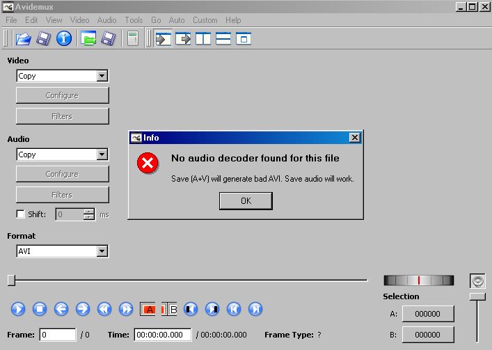

                About the AVIDEMUX APP... I'm getting this error when loading the raw AVI video as saved in my Sony Cybershot camera (see attached screen print)
                  #38
                  weird.... so it doesn't like the audio encoder that was used.... tried saving it anyways? or is that as far as it can get?

                    Okay... I like the Open Source apps a lot for my Linux box builds...but for the sake of time, fatigue and convenience for this Windo$e Laptop...I opted to download and run something called Riva FLV Encoder 2.0... It is completely Freeware..and working like a charm! I'll try uploading the FLV outputted file on this laptop and see if it loads to my photobucket fast.... BRB.
