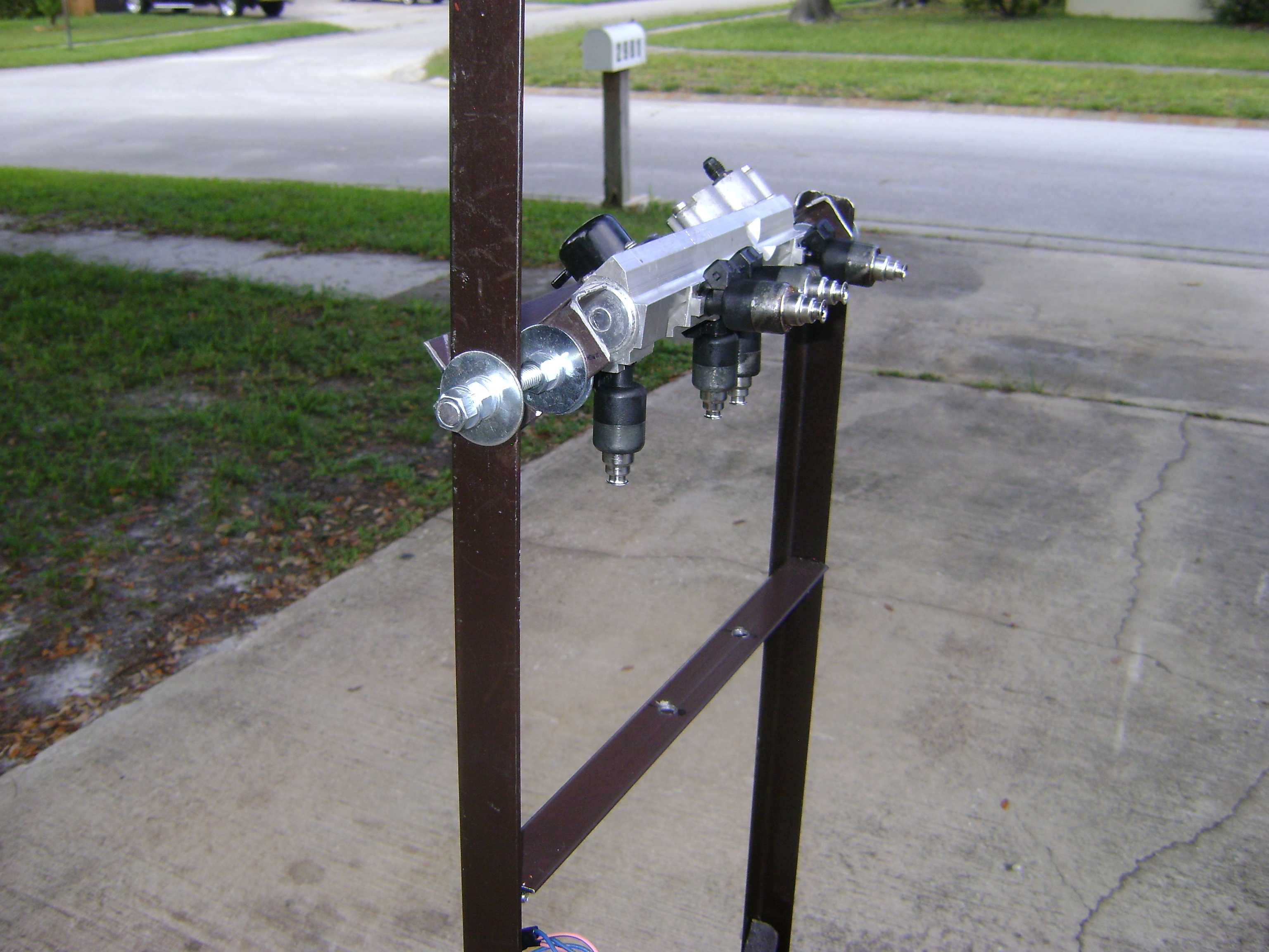

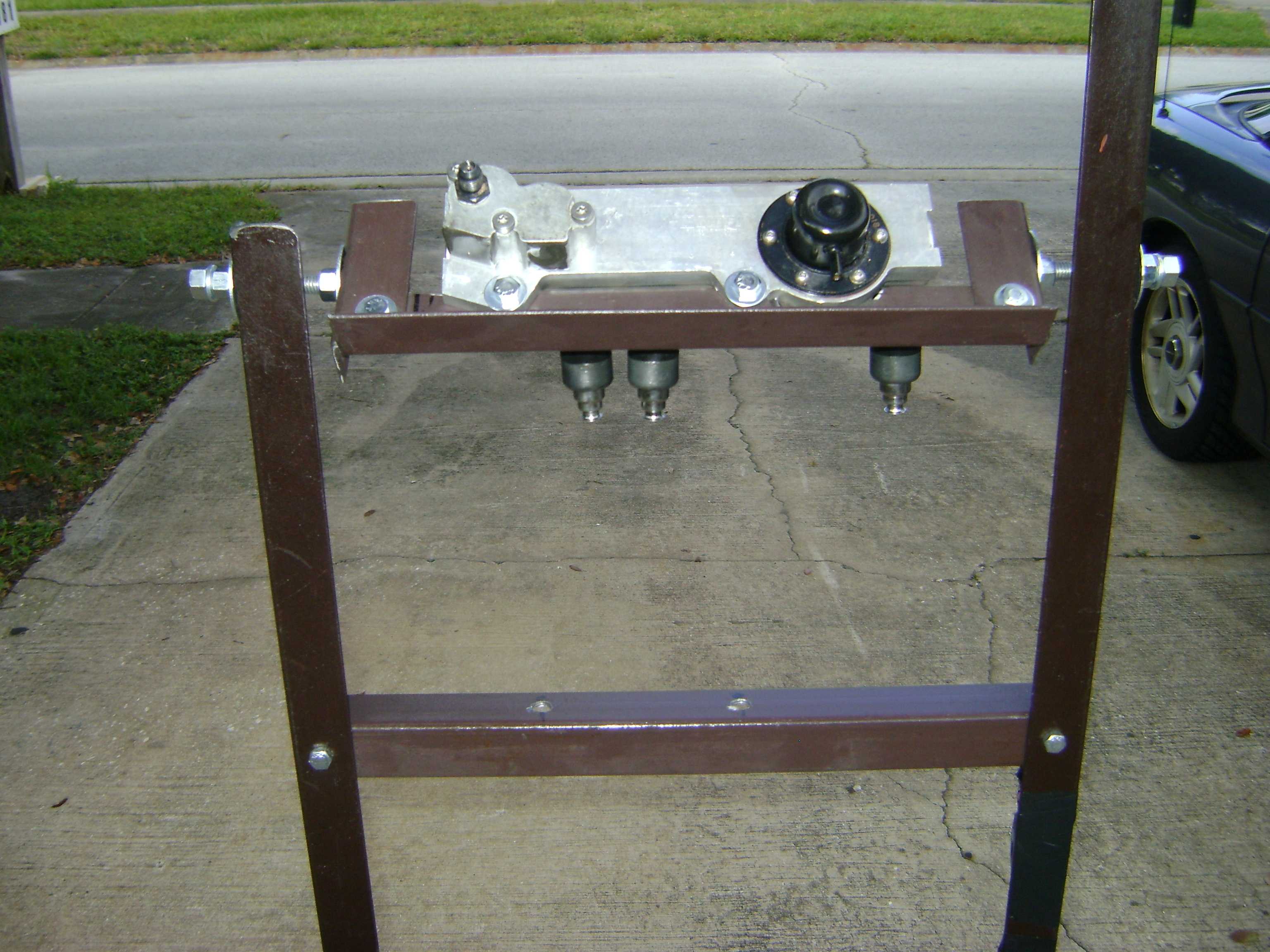

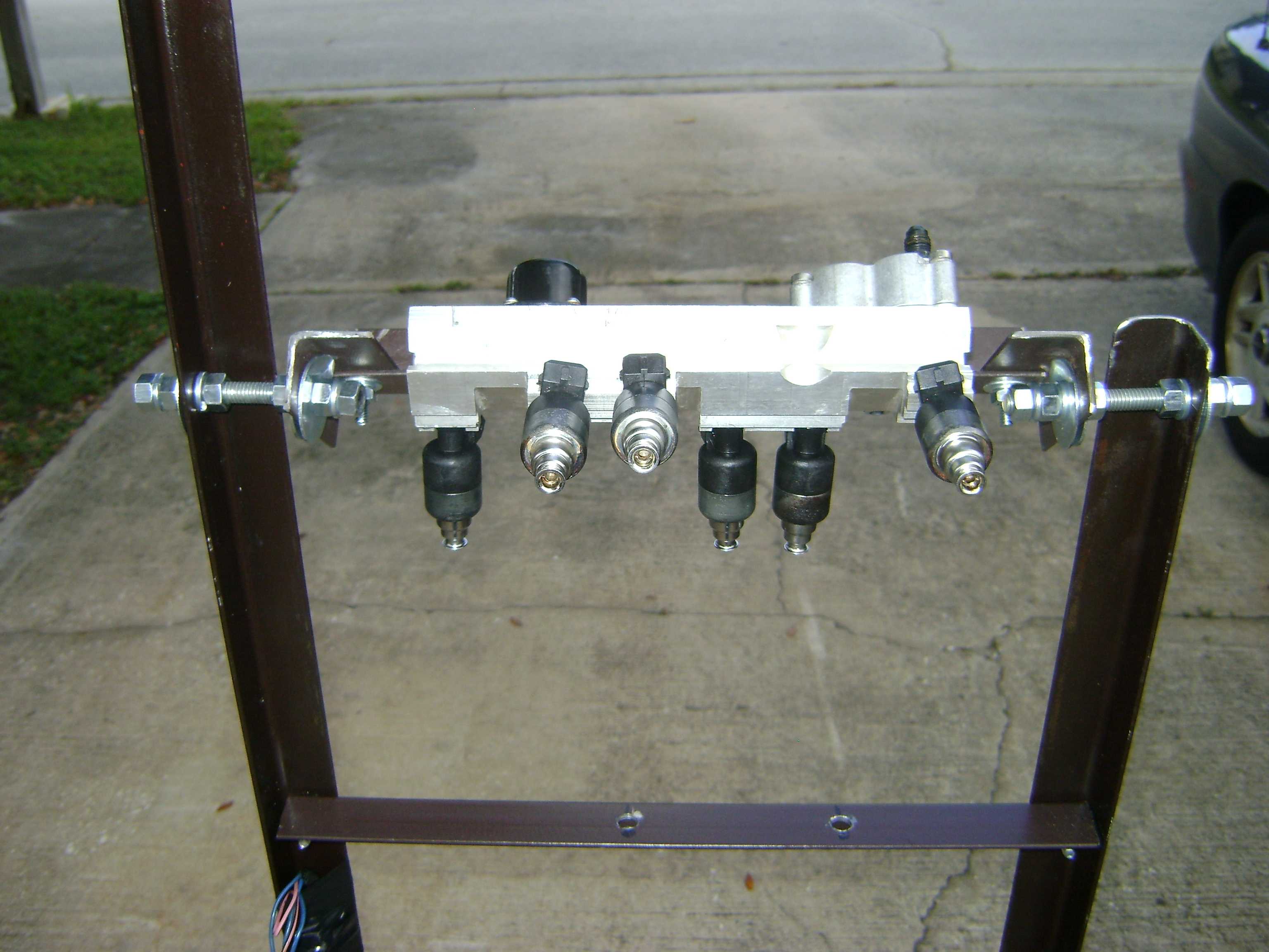

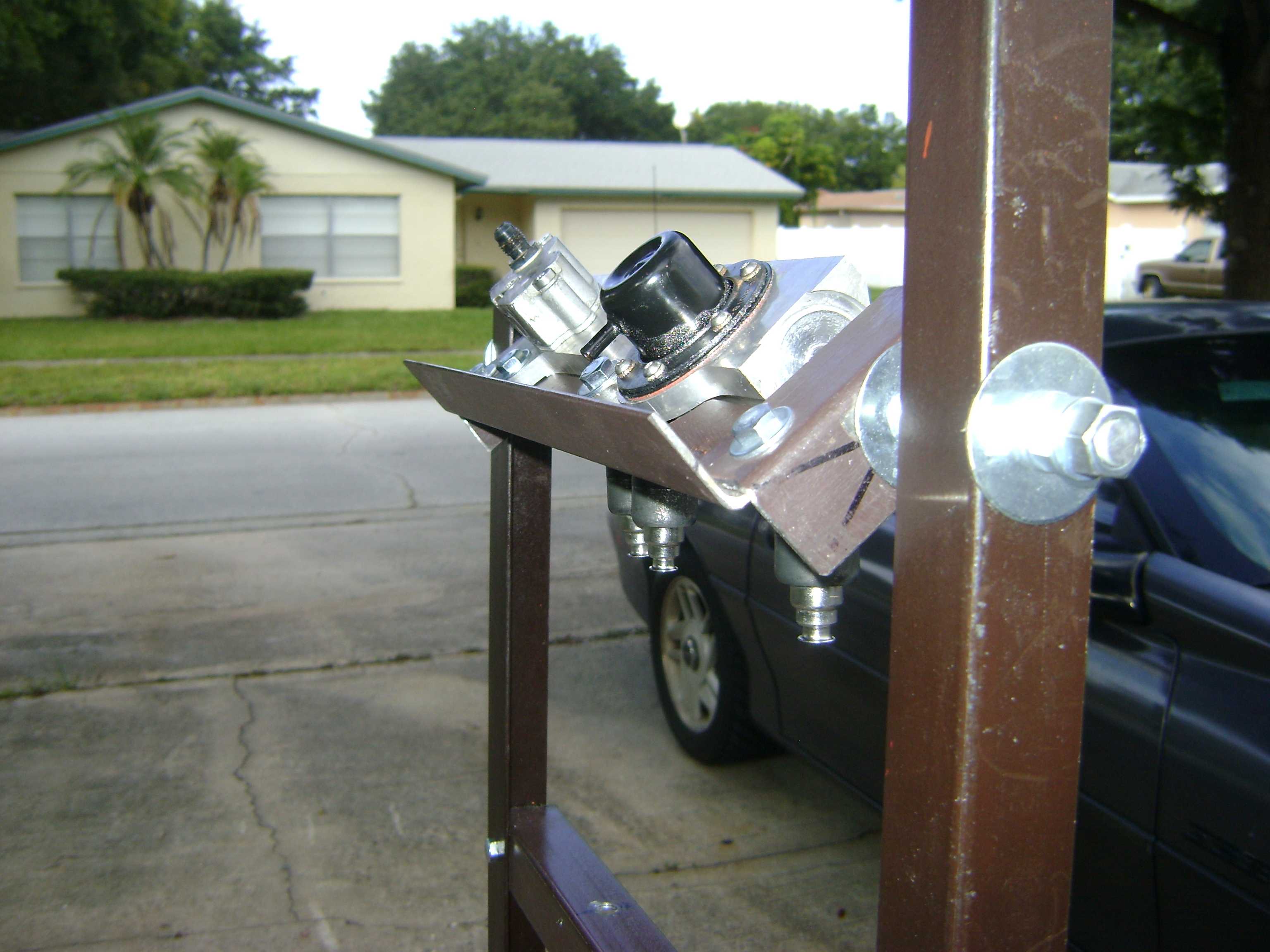

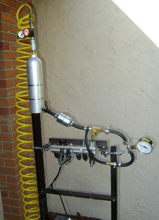

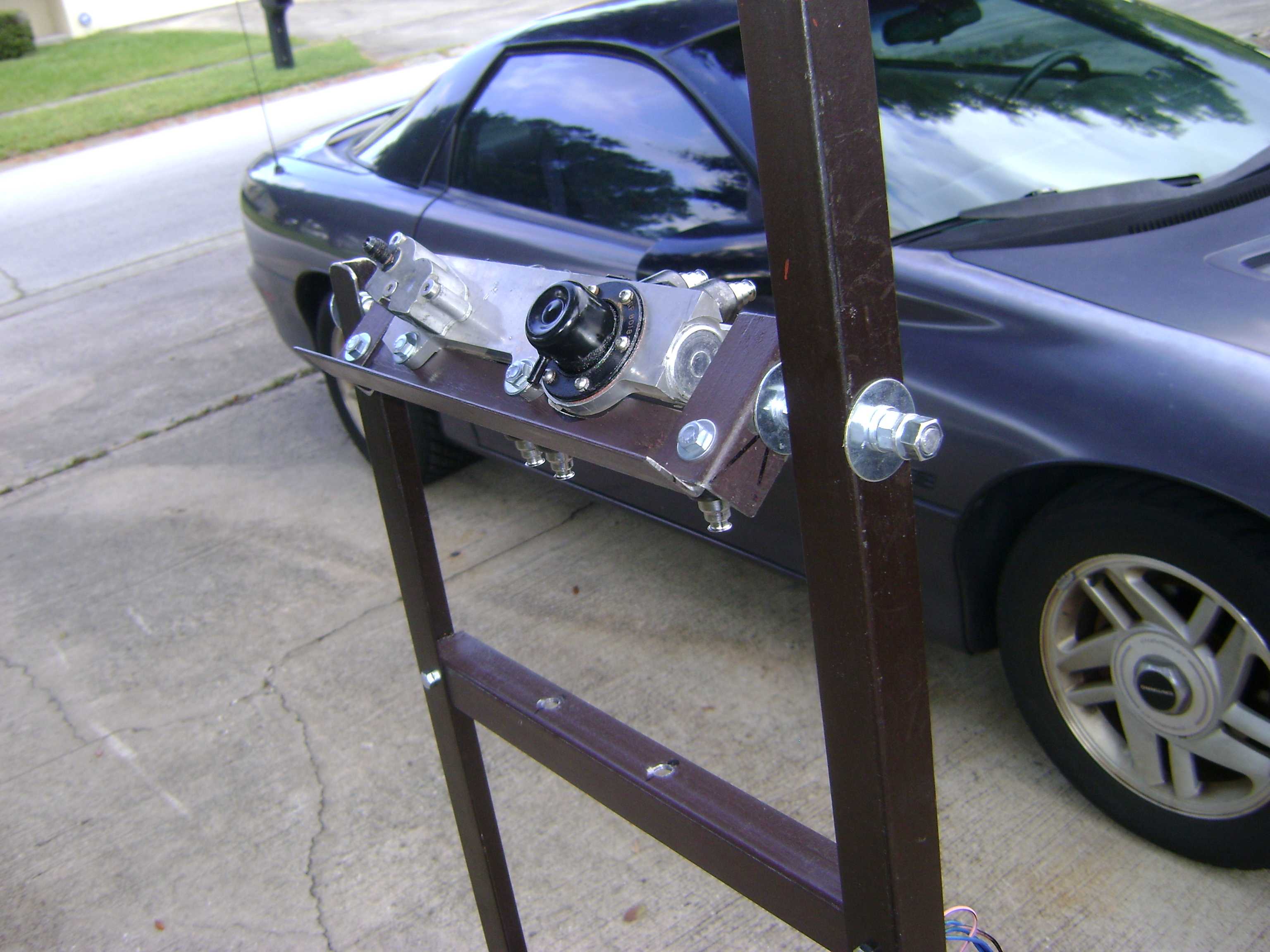

        Holy Smokes...! I think I've GOT it!!! I don't know why I didn't think if it B4... All I need to do is add an angled bracket to the threaded support rods and bolt the other end to the two Fuel Rail support holes in the outer cast aluminum block of the Fuel Rail Assembly! Doing it this way would angle the whole Fuel Rail over until the tips of the Fuel Injectors are pointing STRAIGHT DOWN! Moving the Fuel Rail around this dynamically will NOT affect the EFI Cleaner Feed Hose attachment on the Fuel Rail Schrader Valve and will NOT hinder the use of the EFI Electrical harness, either!
        Done!...
        Naturally it would easier if I had some sort of wide support bracket coming through holes drilled on either side of the Vertical Angle Iron Frame Supports. I just need to drill a small hole at the same height in both Upper Frame Arms to be able to feed a steel rod through them, fitted with some simple brass bushings or bearings mounted on both ends there and then somehow attach the rod ends to either side of the Fuel Rail. Then when I want to re-position the whole Fuel Rail Assembly, all I need to do is un-tighten the supporting rod assembly and rotate it back and forth (like a Rocking Chair or maybe a Pig on Barbecue Spit...) to move the Fuel Rail from one vertical position to another for both banks to be able to achieve this proper vertical position! ... but I'll work on that later... at the very least...I can use the pre-angled brackets idea first to get the Fuel Rail positioned just right and test it to see if this will work. Now all that remains is for me to design a sort of Holding Platform to support the 50ml Graduated Cylinders under each EFI Nozzle and turn on the machine and see how they compare! Gentleman...it is great to knock these ideas around with you guys! THANKS!!!

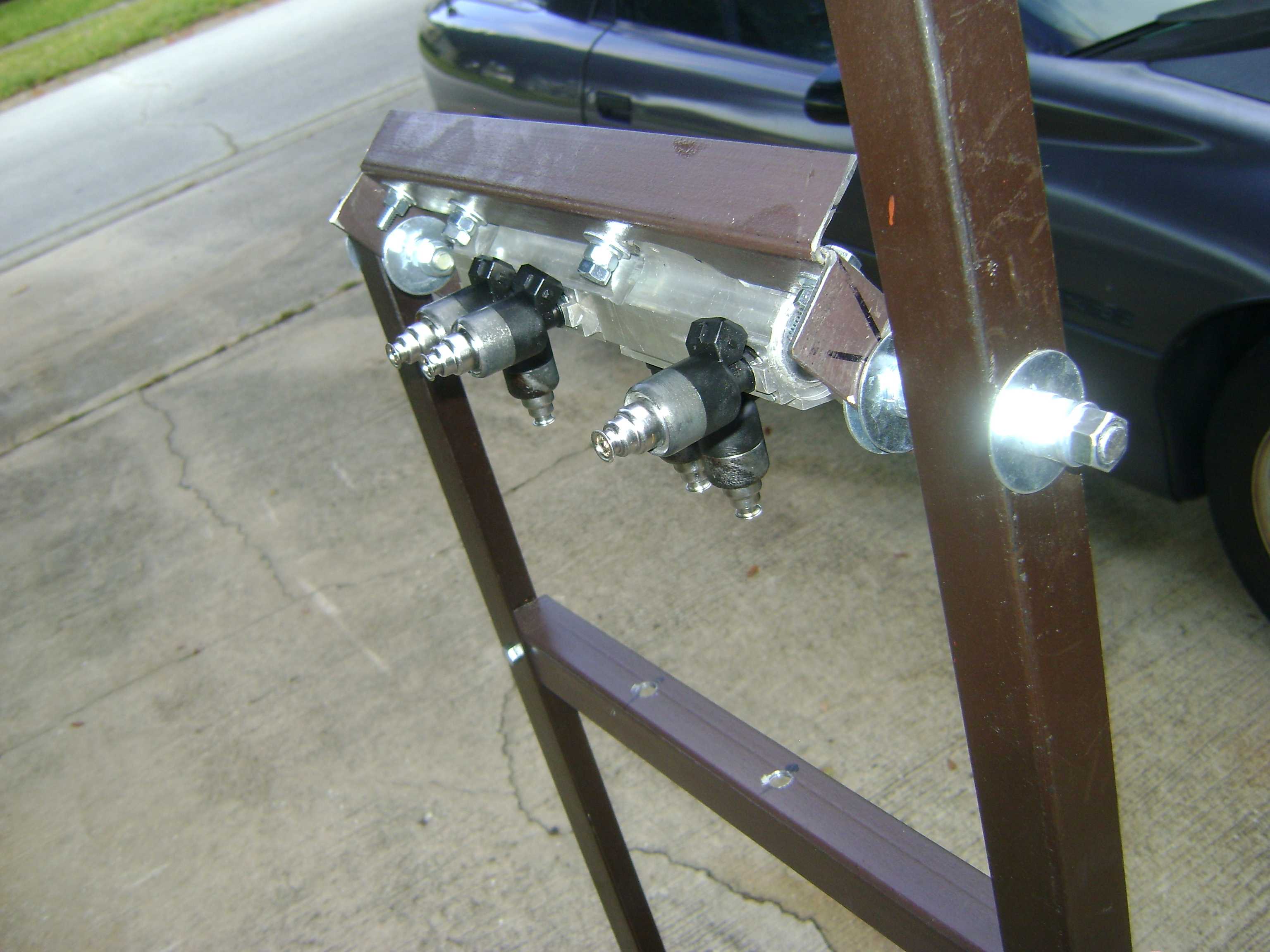

          Okay... on the heels of this morning's inspiration... I set about making the modifications to "The Frankinjector" machine that will now allow me an easy way to do the EFI Fluid Balance Test... and with unbelievable ease, too. Many thanks to all who poked and prodded my thinking here... because in the absence of this collaboration on www/60degreev6/com ... I may not have gotten these ideas in any other way! When I first imagined doing this... I thought about Superdave's parsimonious admonition on "over-engineering" it any further. So I took the simplest route I could think of in using JB-Weld to fix some threaded rods in line with the axis of the Fuel Rail's possible center of rotation. But this wasted about an hour of my time and I abandoned that build for the ones shown in the images and newest video here:
          That design took a bit longer to engineer because in spite of being a great construction material...Angle Iron (the residue of the sacrificial Bed Frames) is a bit difficult to work with when making parts that have to work in closer quarters than the original standing frame requirement. In any case...I adhered to the idea that once built and installed on the frame... the ability to rotate and adjust the position of the Fuel Rail for any number of reasons had to follow the idea that it would NOT be off center...regardless of the position I needed it to be in. And so...a few hours later...with a bit of labor and measuring thrown in...for "Good Measure"...I give you "The Frankinjector" REDUX version that now includes the axial re-positioning as described in my photos. etc. now on my Photo-Bucket site. I will be anxious to see what you think of this "angle" and let me know if I missed anything that needs more work. To the nearly thousand viewers of this thread... thanks for your patience in watching me stagger around with this while trying to make this idea become real. I think I have had a very good day with this improving the design and functionality of this device! Tomorrow morning...I'll button up all the parts and pieces and introduce the 50ml Graduated Cylinders to the fray (I've got to design a tray of some kind and use the two vacant holes in the cross-member that are now free and and see how things work out).

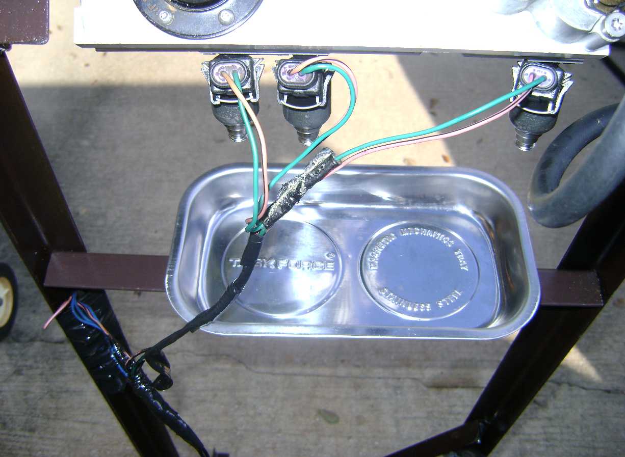

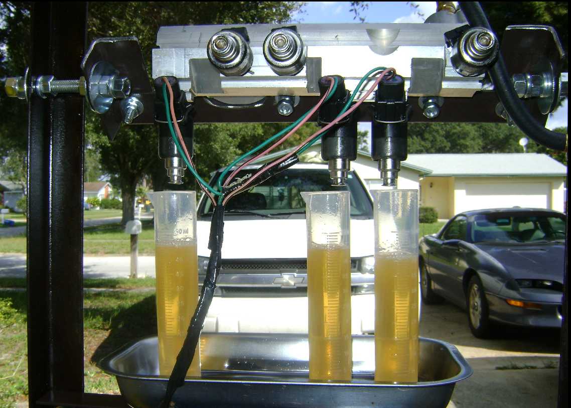

            Okay... This morning, I assembled only the parts of the "Frankinjector" equipment necessary to perform the Fluid Balance Test on six Rochester Multech EFIs for the VIN "S" GM vehicles. You will note from the photos and videos on this update via my photo-bucket link, that I decided to use the "KISS" Principle on the design of a tray to support the 50ml Graduated Cylinders by using a deep-dished stainless steel, magnetically attachable tool tray to support the collective tubes and simplify the need to build one that I would have to design another quick-on and off mechanism. Because the Fuel Rail has a staggered design, when rotating the Fuel Rail to do first one set of three injectors on one bank and then the other...moving the tray off center as necessary to support the tubes is a snap. Spills are easily captured and contained and so is the cleanup after finishing this test. I left off all the acrylic drain tube plumbing as it was not needed for this testing method and would have actually been a hindrance in getting around for this exam.
            They say you should be careful what you wish for... and in this case, the test(s) did reveal that this one set of injectors does have some performance differences that can only be reconciled by mixing and matching injectors from other sets that more closely fall in line with each other in performance or by further cleaning via the hot-soak in Purple Power and maybe back-flushing (...if I can figure out a way to do it using the existing Fuel Rail). I have one more set of EFIs to evaluate on hand and the other identical set (with fuel rail and electrical harness all for just a ten spot) will be arriving soon. The set up and break down of all this integrated hardware has proven very smooth and easy to handle. When not in use, the acrylic plumbing fits nicely in an over-sized Zip-Lock Bag and likewise for the six Polypropylene Tubes, so that shop dirt and contaminants do not get all over them. Keeping the rack with the rotating Fuel Rail assembly from getting under foot has proven itself very "storage friendly" and the whole upper portion can be covered with a long trash bag to keep the shop dirt from making a mess of this equipment. On the whole, this kind of "One Over The World" idea for the design of this machine has proven itself out at every turn!
            This takes care of the problem of conducting the "EFI Fluid Balance" portion of these comprehensive testing and cleaning procedures. Up next to try and solve is how to isolate and protect the wiring harness from shorting out and making direct contact with the hot cleaning solution when the EFIs are being dunked in the UMAX Ultrasonic Machine...

              The other OTC EFI TESTER just arrived and I attached one Multech EFI to each one to see how these units behave in tandem. I shot two videos just now that give a better performance impression than this paragraph can explain. Please note that I managed to get both to work off of a single, 12 Volt 110 AC Power Supply that I have been using for just the one OTC Box on all of the video posts done so far. Here is the latest link to the newest stuff...

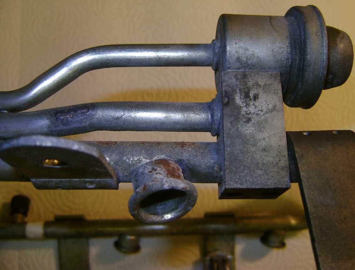

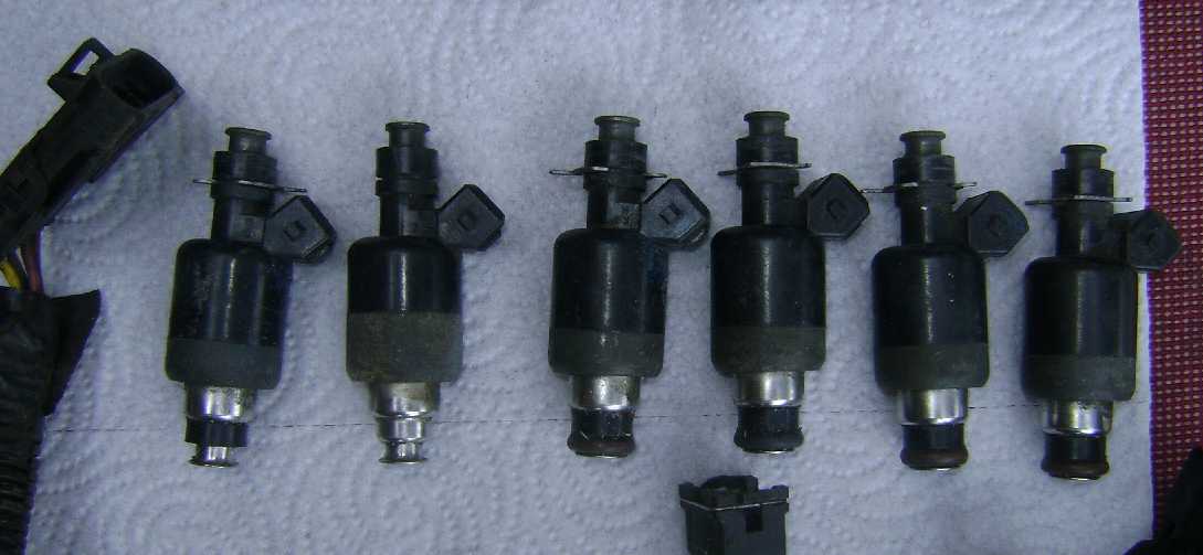

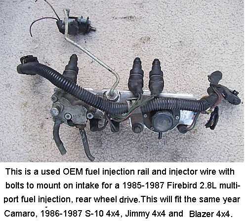

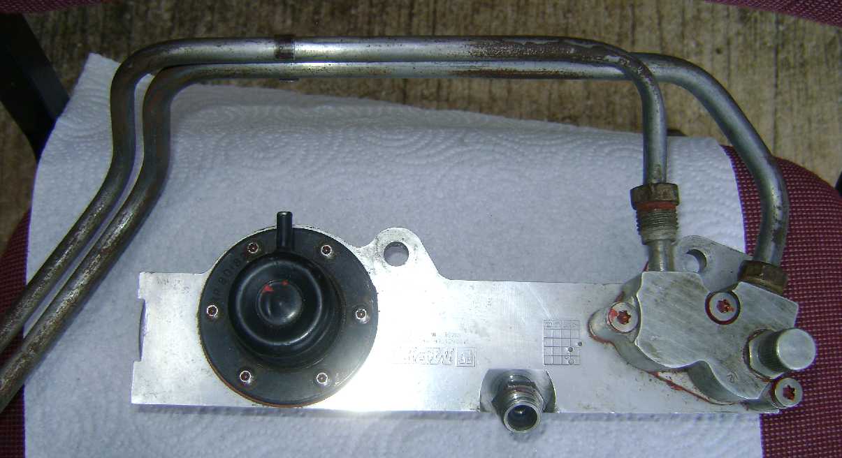

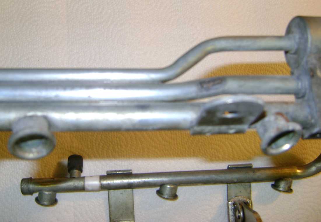

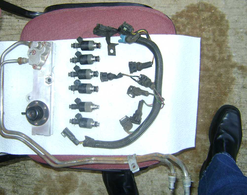

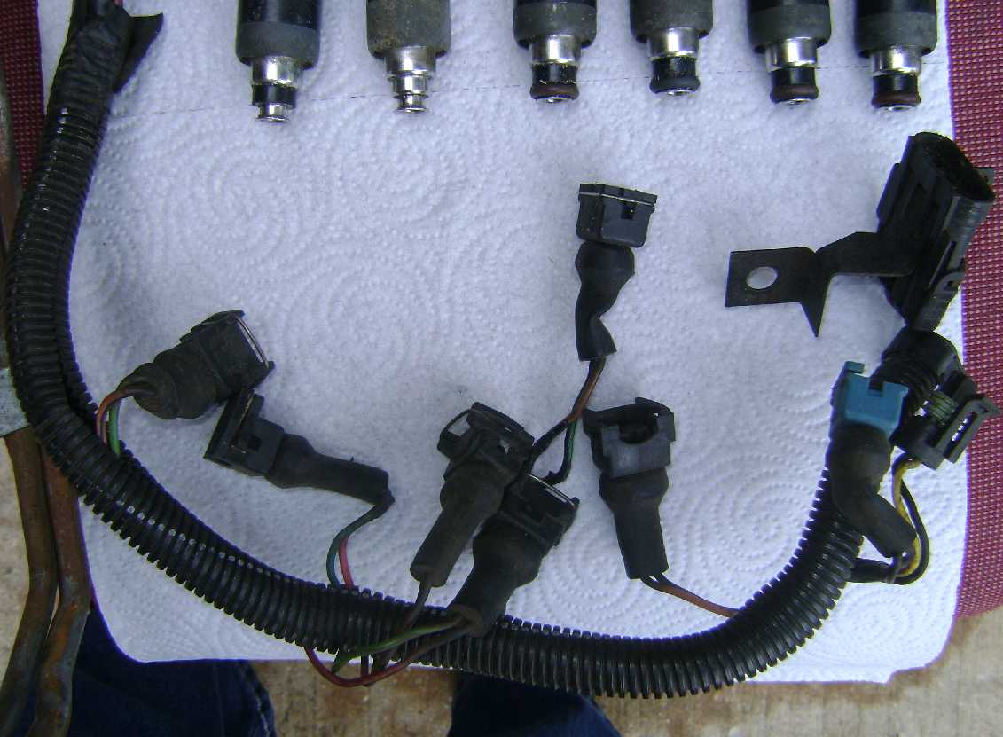

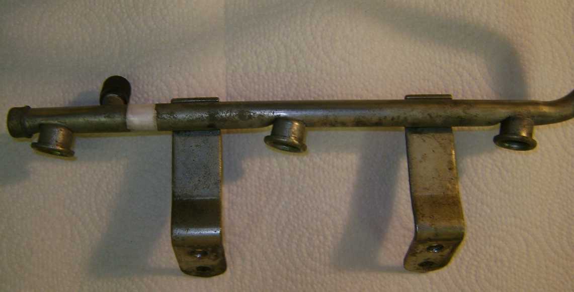

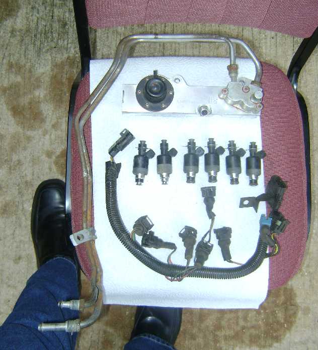

                Okay...The "Under $10.00" set of EFIs, Fuel Rail w/feed lines and Complete Wiring Harness came in just now. I snapped some images because I was curious if anyone has even seen this kind of early model Fuel Rail with that odd side port in it...Just curious to know what makes/models use this feature...and for what reason. The other idea here is to show that it is possible to get some of the primary components/parts and pieces that have gone into building this prototype machine without dropping too much coin down the drain. I'm puzzled as to why there is so much attention being paid to this project by "The Lurkers" with so little feedback on what their thoughts are. Now to paraphrase Slim Pickens as Major T.J."King" Kong in Dr. Strangelove, "I've been to World's Fair, a Picnic and a Rodeo..." and I've had my ass whipped a time or two in my day... and given back more than I ever got, so I can take the honest criticism if it needs to come my way. Don't be shy, Folks... Jump right in...

                                I snapped some images because I was curious if anyone has even seen this kind of early model Fuel Rail with that odd side port in it...Just curious to know what makes/models use this feature...and for what reason...
                                Never mind on this "Q"...I found the dope on this item... (image)
