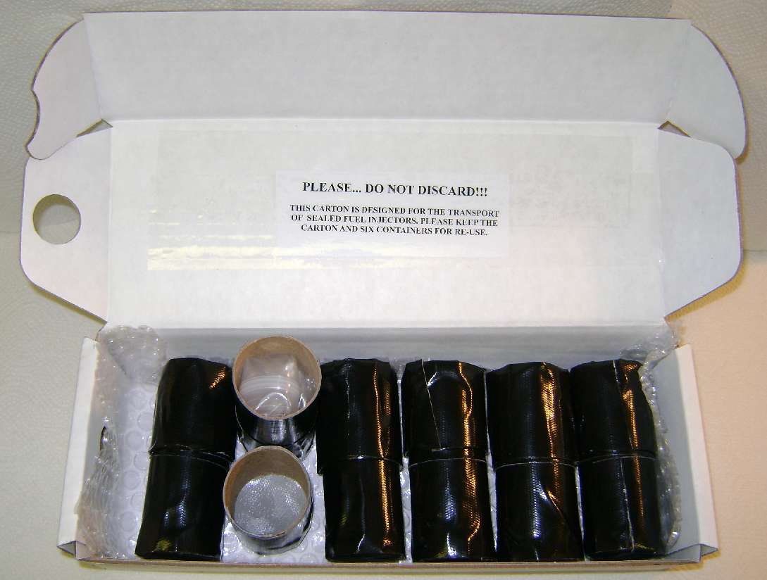

                      Okay Max... Your 1999 Set of EFIs are on the way...(Santa stopped me on the way to the U.S. Post Office and tucked something into the box that he thought you might need. He kept saying something about saving him some grief because of his, "...not having a lap BIG enough for THAT Kid!" LOL... Anyway... I told him, "No Sweat...Let's combine shipping and save you a trip to "Southern Canada"...
