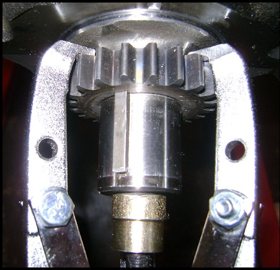

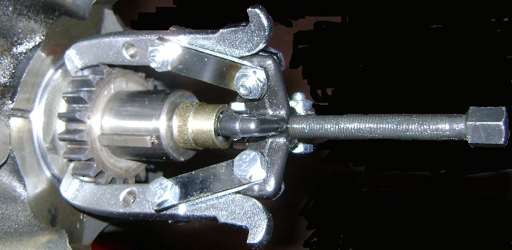

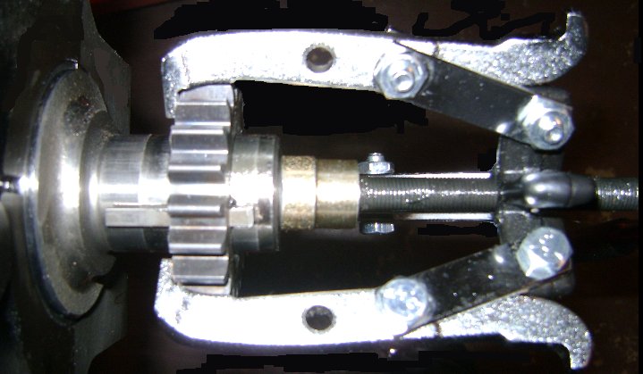

                            Hammering on any crankshaft can de-tune it at best ...and at the worst, ruin it completely for the need to get the harmonic damper/balancer back on and center bolt re-installed. The attached images show an easier way to get the hard-2-remove timing gear off. Please visit my Photo Bucket site below for more images on Timing Set replacement and installation data on the GM L-32 3.4L 207 CID engine. The clacking noise could be the stretched-worn out timing chain clattering on the slack side of the timing set rotation and be involved in the hesitation from the mis-reads on the timing gear sensors to the ECM. Your description of the poor engine condition indicates the 144,000 miles on it may have been very hard ones. Putting the super-high viscosity motor oil in the engine is reminiscent of that old trick of dumping saw dust into gear boxes to quiet them down and make selling used cars with them less suspicious.
                            (A pretty damned, mean trick to be played on your son, if you ask me...)
                            Bob
