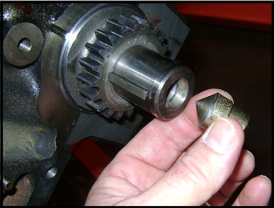

                            When you install the new crankshaft gear, it just has to be pushed on as far in as it will go, right up to the point where the crankshaft flairs (flares?) into and meets the front portion of the front main journal. When it is finally on this far, there will be a space of about 3mms between the back edge of the gear and the front face of the engine block. There are three possible methods to use for installing the crank gear:
                            (1) For the motor mounted on an Engine Stand, you can just use a section of galvanized muffler pipe of around 2.25" in diameter and then cover it with a length of 2"X4" that you can hit it on with a mallet. With a light smear of Moly-D...the small crank gear will make it all the way in with just a few hard thumps...no sweat.
                            (2) For the ITV installation, some mechanics prefer to just grease up the inner shaft of the Harmonic Balancer and using a few hardened steel washers to act as thrust bearings with some Moly-D in between, they slip the washers onto the Crank Bolt and slip the HB on the crankshaft with the small gear ahead of it...then tighten it down slowly with a medium sized breaker bar. Be mindful that the 9.8 Crank Bolt is pretty damned tough Hombre...but it isn't Superman ...and so using a small (Ladies Compact) mirror to eyeball the proximity between the back of the small gear and the engine block until its finally all the way in will prevent you from over doing the job and breaking the Crank Bolt off inside the crankshaft. Keep in mind that you will have to immediately use a the Harmonic Balancer Puller to remove the HB ...so that later you can install the Timing Case Manifold and Water Pump and then re-install the HB for the last time.
                            (3) The last way may be the easiest because it involves using the factory tool ...a Kent-Moore item # J-38612...It's elegant, simple in design...and generally...as scarce as Hen's Teeth. It consists of longer version of the 9.8 crank bolt with strong hex head and a floating larger hardened thrust washer. The bolt/washer portion slips inside the second part of the tool set: A hollow section that sports a female key way to slip along over the crankshaft Woodruff Key. The thrust washer rides on the outside of the hollow part and when turn with a large socket and bar, the bolt drives the whole unit against the front of the small gear. It works very well in driving the gear all the way on in short order.
