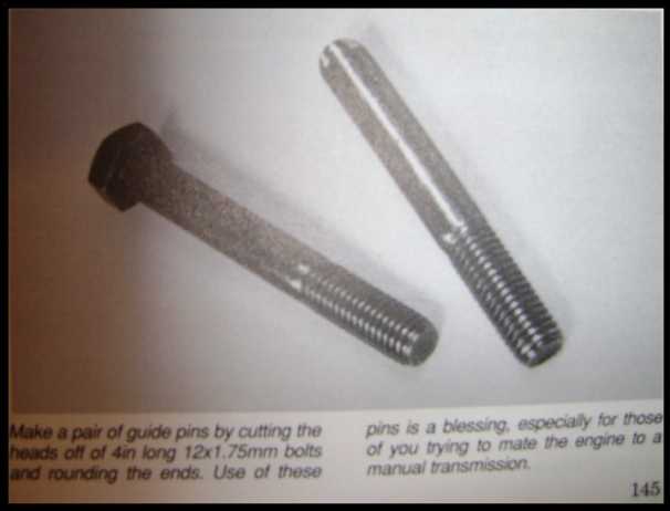

                  Some mechanics like to identify the metric bolts thread/width, etc. for the Bell Housing/Transmission interface and then buy a set of 8.8 bolts around 80-90mm long. Then after just cutting off the bolt head ends and sort of grinding the bolt shank ends down to an ogive (bullet-like) shape, slightly unbolt the lower transmission support member mounting bolts and then screw these babies into several of the rear engine locations (FINGER-TIGHT) to act as a guide and make it easier to move things around...with just a bit more room to move back and forth (the "OLD IN+OUT" LOL) so things can be better aligned and bolted up. I would urge you NOT to use the stock bolts to pull the engine closer and closer to the Bell Housing unless you have an extra one to bolt on when you crack the one you have waiting in the car. BSZOPI's warning on this is very well-founded. Take HEED! If you employ this tactic and it works ...don't forget to remove these "Aligners" and replace them with your stock bolts and re-torque everything/ Then remember to re-tighten the transmission support bracket hardware once the marriage of the engine and tranny is complete.

                        Metric engine-transmission alignment pins
                        The attached image of the converted bolts to pins also has the Metric Specs you need...
                        (Credit to Tom Currao's excellent book "How to Re-Build your GM V-6 60* Engine")
