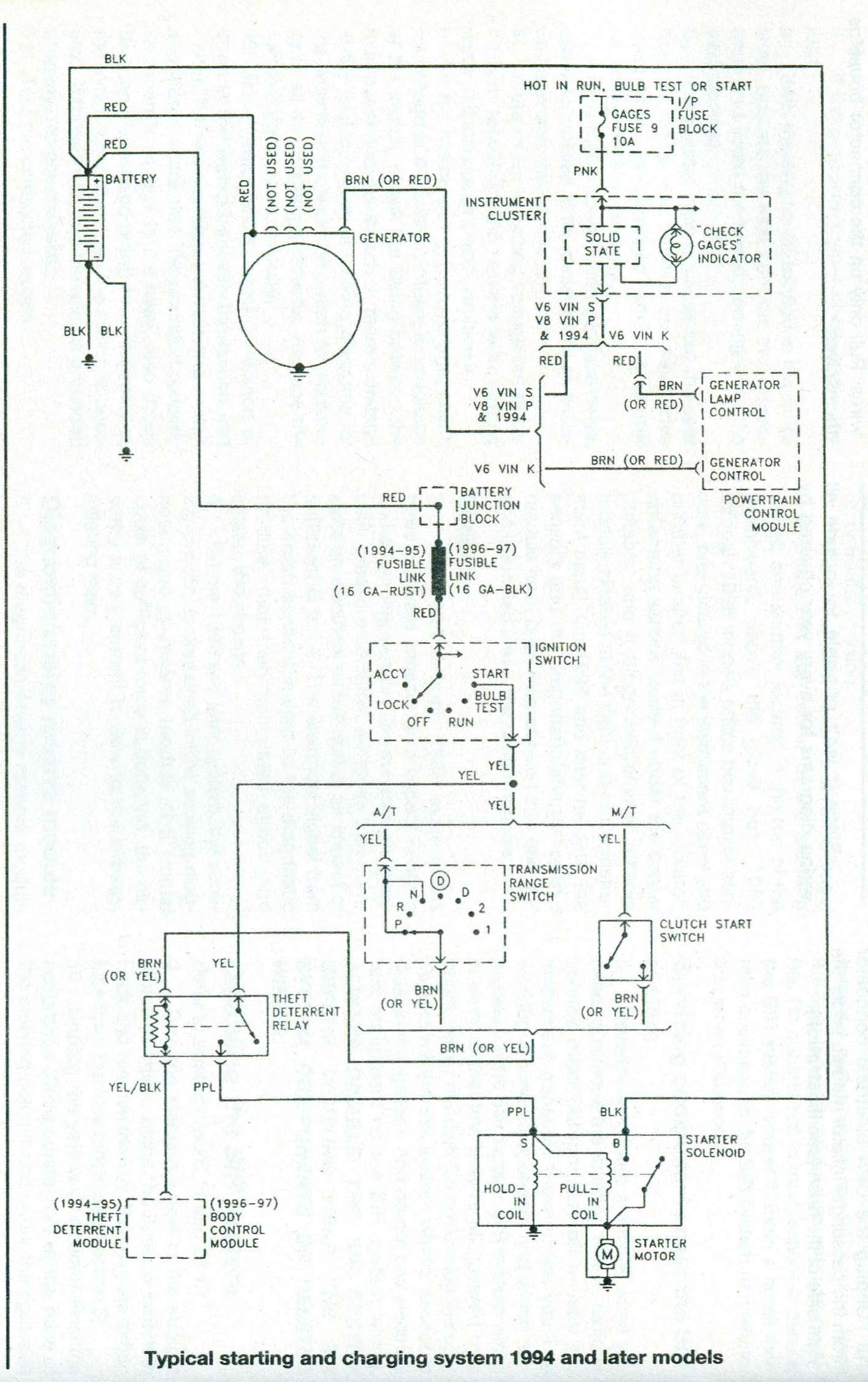

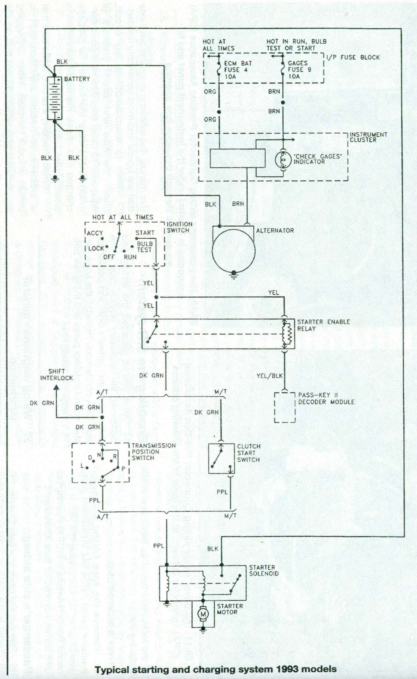

    Question : Installing a 3.4L starter
    I just installed a 3.4L engine on my MGB. I need to install the cables to the starter. I know the cables for a MGB. Can some body explain to me who the cables are connected to a 3.4L starter and were they go that way I can connect the ones from the MGB. Thanks
  • 60dgrzbelow0
    "Yes... I AM IRONMAN..."
    • Mar 2009
    • 1344
    Here are the Basic Wiring Diagrams that will point you in the right direction as to how to properly set up a baseline starter system unique to the wiring in the MGB. Either one of these will suffice, as long as you follow the parts and pieces consistently when you purchase the associated fusing, wiring and starter with solenoid, etc.
