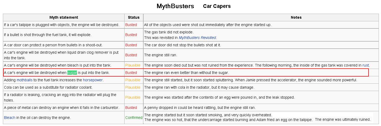

            Its from all that sugar in the gas tank...
            I think Jamey and Company at MythBusters looked at this one on their "Car Capers" Show...(See Attached Image)
                It would be the reason for the high idle. His car was having a sugar rush...
                  #23
                  wait, it actually ran better with sugar?

                        #26
                        ........i haz a scam-worthy idea.
                        Its the old principle in Chemistry that "Like Likes to Dissolve Like...". So...its a Polarity issue...Water+Sugar = Sugar Water because they are a polar match... but Gasoline is Non-Polar, so the Sugar will not dissolve into the fuel. It might plug up a fuel line if ingested... but it won't ruin the engine in solution, etc.
