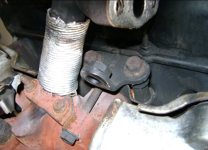

    Although I don't have much experience with the RWD engines, you thought on the stud being for an alternator brace is probably correct. Is there any other brackets on the engine that could possibly require a stud? If not, I'd say your book is just wrong. Wait for some of the RWD guys to chime in, though...

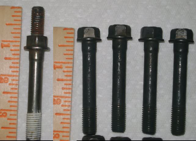

            yeah that stud is more or less useless. when you buy a "3.4 head bolt set" it will come with the stud and an extra bolt (at least mine did). I actually chose to just put a bolt in there instead of the stud since it's easier to work with. Don't freak out about it.

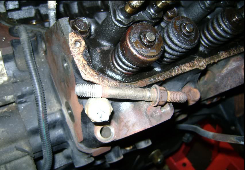

              I just pulled the heads on a '95 Camaro last weekend.
              Using the ultra-cool photos from 60dgrzbelow0's hard work...

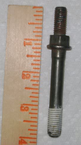

              The front-most, lower head bolt on the driver's side is a stud. 60dgrzbelow0 has a really good photo of that [If you want to wade thru all the photos, it's the photo on the left in the 4th row down on the 1st page (on 18 mar 2010) ] - here's a link to the exact photo I'm talking about:
              The lower 2nd bolt from the front on the passenger side is like a bolt with a nut on top of it... really odd. 60dgrzbelow0 has a really good photo of that [If you want to wade thru all the photos, it's the 2nd photo from right in the 1st row on the 2nd page (on 18 mar 2010)]- here's a link to the exact photo I'm talking about:
              I may have to re-use the bolt with the big nut on top, because my kit of replacement head bolts doesn't have anything like it.

                Thanks for the reply on this. What I found was that the stud/nut on the right head is a discontinued GM part. So, you have a 3 choices. 1. You can have your local chevy dealer search the country for available inventory and have them ship to you (if you have the time). #2. Re-use the one you have (but it's already been tq'd to yield) or 3. Use a 'normal' stud (I got an x-tra in my bolt kit) and put trust in one bolt holding the 'K' brace plate on the alternator/EGR support 'jungle gym'. My choice was (#3) to maintain head torque first and foremost. I can deal with the bracket later if the need arises.
                BTW, my Chevy dealer (Tennyson Chevy in Livonia, MI) ran a print off of all available studs in (chevy) stock in the country. Not over priced yet (4-6 bucks) but I opted for #3 to get my car on the road ASAP. JP

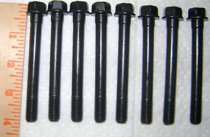

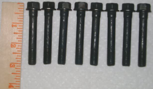

                  Syclone1452 is displaying images I took of my identical engine head bolt removal. Folks...If you are going to refer to my photobucket postings in the future... please don't use individual images because all of my work there is designed to be comprehensive and not only to show how things come off this engine...but also how the new parts go back on and with the correct part numbers, too so please use the main page link to avoid any further confusion on how they are sourced.
                  Project95... FelPro makes a set of head bolts that includes the one special stud/bolt and should still be available. Here are the images of these and the box end with the appropriate part numbers to help when ordering them. You should avoid re-using your head bolts in the 60* engines as they are supposed to be torqued home and then stretched to their final hold point. Once stretched... they will not return to their slightly shorter length when unbolted. These and other related images are available on my photobucket site here:
                    That set only has the stud used on the left side. It does not have the bolt-with-the-nut-on-top that is used on the right side. I already have the Felpro box-o-bolts.

                          Im just about to find out what you just found out. Ive got a 95 camaro 3.4L with the felpro gasket and head bolt kit.
                          You are right the Felpro bolt set does not come with the HEX post bolt. I forget what the hell that bolts into that one now. Is it the exhaust mainfold/exhaust recirculator? Do we really need to bolt that down?
                          My kit came with a loose bolt with a thicker collar/face (between the head and the shank), I assume Felpro thinks I am supposed to use that in place of the Hex topped bolt. Has anyone called Felpro to ask them? Is this bolt Felpro's mistake (some line worker threw in the wrong bolt in the box?)

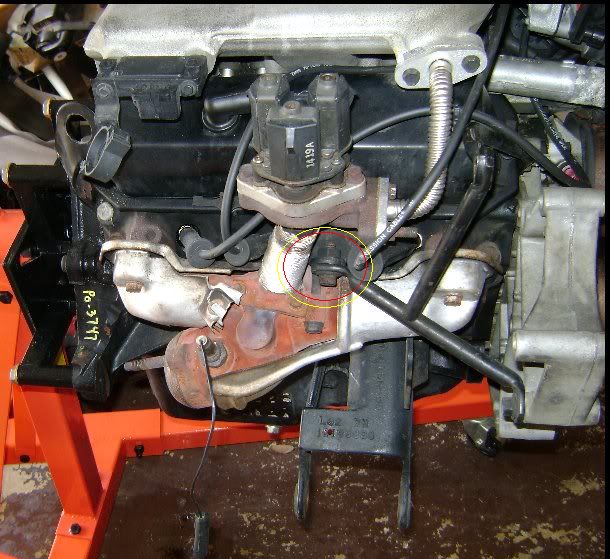

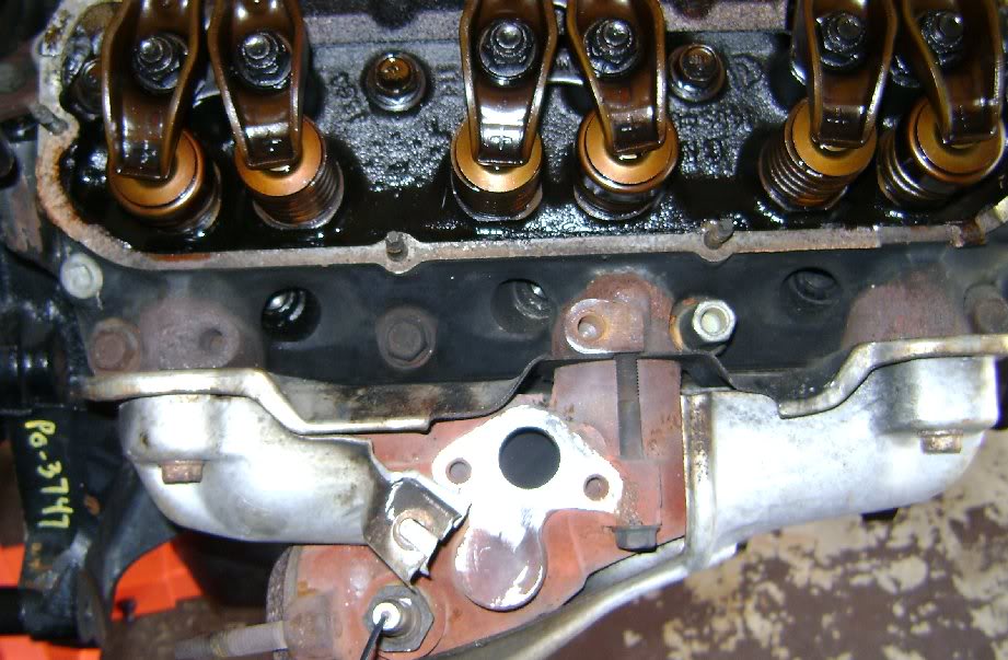

                            Yes... the attached images show a small, angled and pre-threaded bracket that has one of its two supporting pads screwed into the top of that damned Hex Bolt...
                            And I concur that tinkering with the bolt's strength and hardness by means of introducing either welding or brazing heat was probably not the best idea I've ever had.... but now we come to something I was thinking of that might really work and solve this problem once and for all.
                            Remember that one odd bolt included in the box of FelPro Headbolts that has the threaded bolt designed to support the Power Steering Pump/Fuel Line Brackets on the Driver's Side of the engine? Well... that item has a separate Part Number that could be used to order an additional one...and then just find a double sided Metric Female Barrel Nut to screw over that protruding bolt after torqueing it down in place with the other new head bolts and then that little angle bracket that supports the lower black alternator bracket could once again be bolted back in place!
