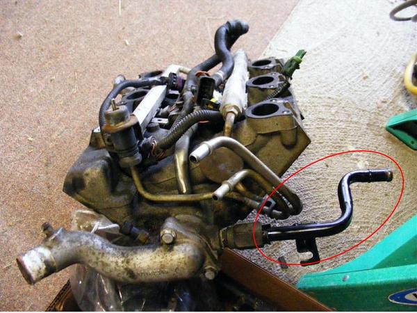

    My swaped 3.4 large port LIM currently has no coolant line attached. It is a smooth bore ready for the pressed on coolant line. My 3.1 has a threaded port with the coolant line attached. Anyone have an intake threaded for them lately and if so how's it done? Anyone have the coolant line pressed on and how's that done? My second question is the 3.1 LIM coolant return line attached to the threaded port is very loose but it does not leak (see pic). Is this typical?

    You have a couple options. You can try to find the pressed in pipe section, and adapt it to your existing lines (via rubber hose), or you can tap out the port with a 3/4" NPT (IIRC). If you tap it, just be careful to keep the tap straight when first starting it and don't go too far into the pipe.
    As far as the existing connection, it should be fine. The plastic part is actually a quick disconnect, but if you try to use it as such, it usually breaks.
