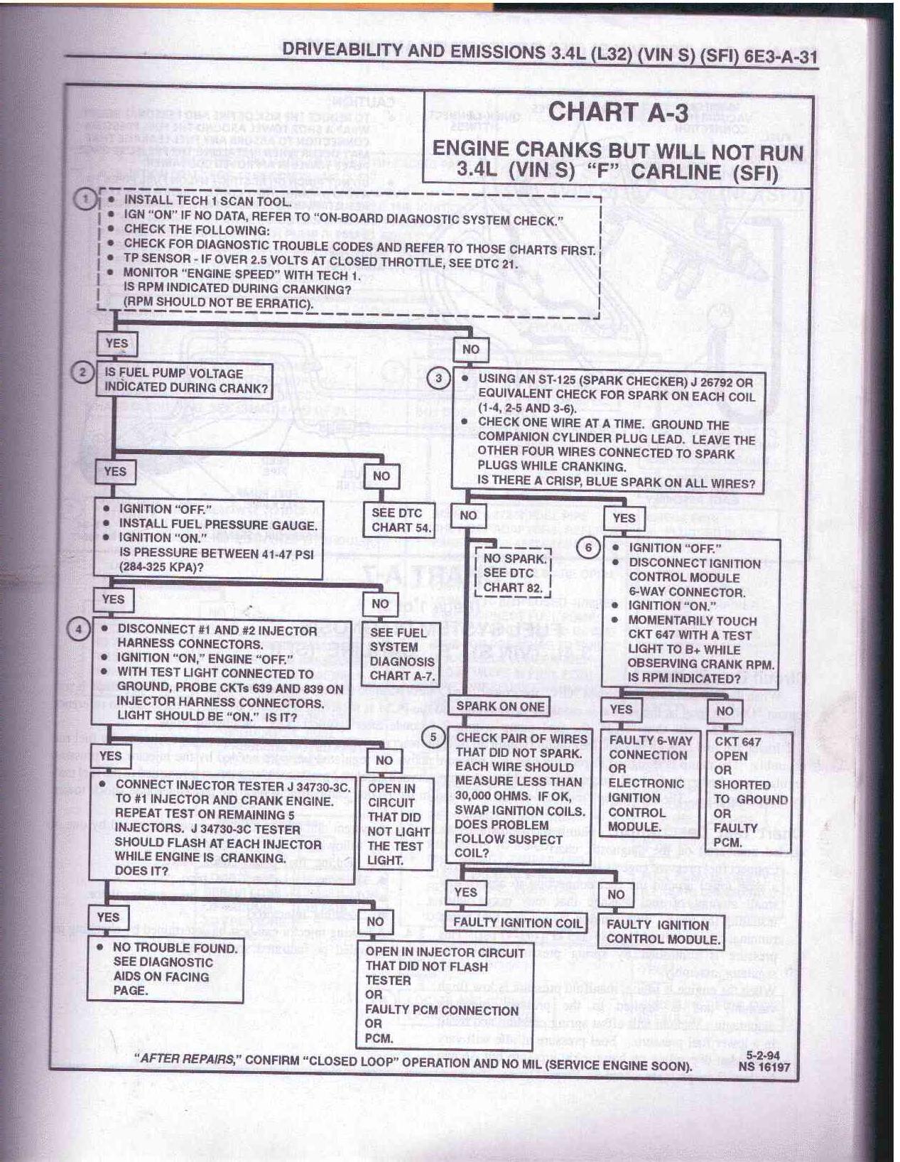

            Could I have killed the PCM?....
            As usual, my Saturday is dedicated to Sydni's car <sigh>
            I have been reading more in the Factory Service Manual (FSM). I found a troubleshooting chart that helped me realize what should be going on during the start process.... see attached FSM pages
            Open attachment page b [i.e. 6E3-A-31]...
            Step 1 - I do NOT see RPM changing. All I see in TunerPro is 300 RPM... whether the software is connected to the PCM or not. When I am connected, I see the Coolant temp, TPS and everything else... just no RPM changes.
            Step 3 - a couple weeks ago, I had spark at each plug. I discovered that the ones that weren't firing properly had the other side of the coil not grounded <smacking forehead>
            Step 6 - I do NOT see RPM jump in scan tool when I quickly tap 12V to the PCM... nothing...
            "NO" box below 6 says "CKT 647 open or shorted to gournd or faulty PCM"... swell
            I pulled the PCM and the 6-way connector at the ICM. I connected an Ohm meter on each end of the CKT 647... [E on the 6-way and C30 on the PCM]. I have continuity and the wire is not shorted to ground.
            I then discovered that a couple of the wires on the back of the 6-way connector were bare <gasp!>
            I think the B and C on the 6-way connector may have shorted... <drat!>

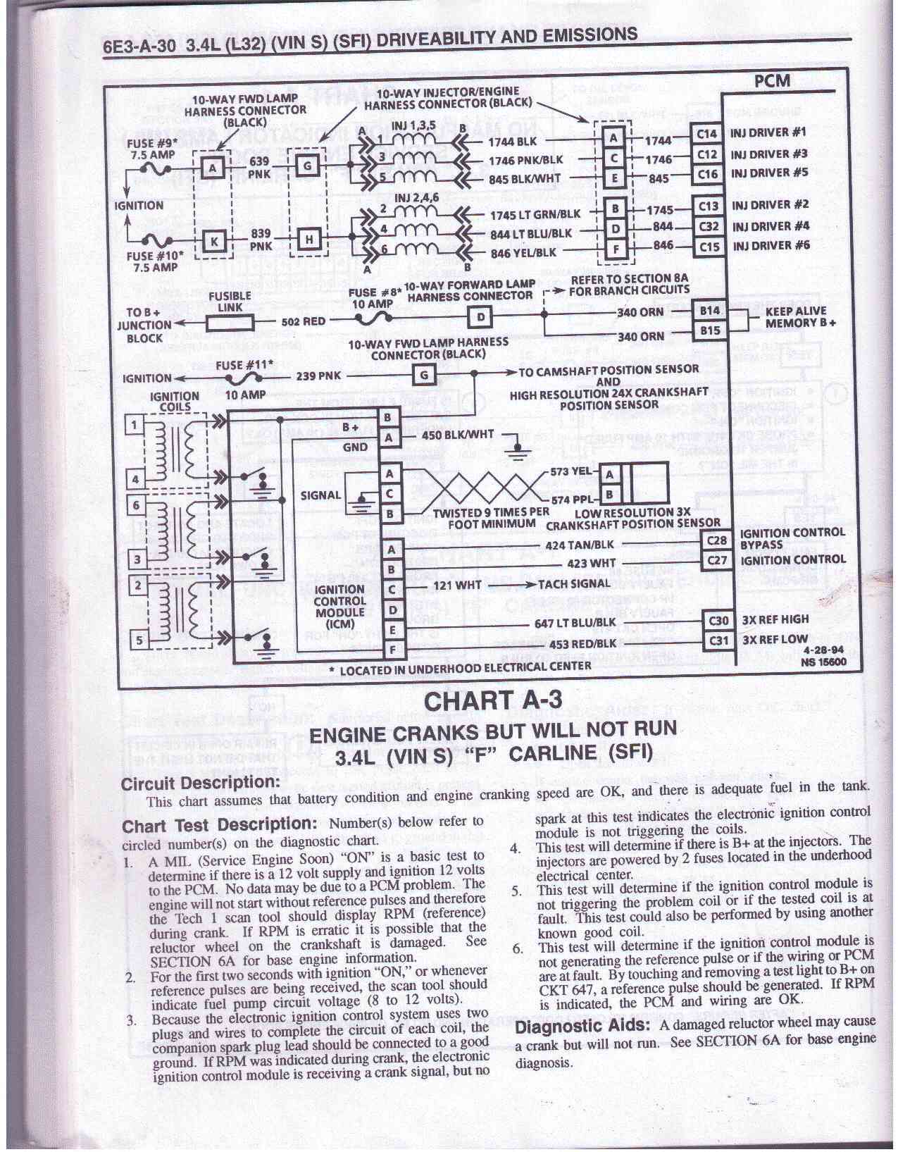

                              Expecting to find a bad connector or wire, I removed the PCM pins from the C connector that run to the ICM. I was unable to see the square wave at the PCM.
                              Since the wires at the ICM are down near the water pump, I decided to remove the coils and ICM... and just test with it sitting out. I connected a probe to the pin on the ICM that should have the square wave on it. I plugged-in the power connector and the crank sensor connector... nothing.
                              Doubting my testing methods, I decided to try that on the Olds. I removed the coils and the six-wire connector at the ICM, connected the probe to the pin that sends the 3X ref signal. The o-scope logged a square wave. That confirms my testing method was valid.
                              Wait... what is that?
                              The wires to the crank sensor are in different places!
                              The plug on the ICM that runs to to crank sensor is a 3-pin plug. On the Camaro the two wires are connected to the middle pin and the one farthest from the 6-pin connector. On the Olds, the wires are connected to the two outer pins of the connector - the middle pin is open.
                              If you look at the diagnostic wiring diagrams I posted last week, you'll notice the diagram shows the wires with a not-connected center pin. hmmm.
                              Out of curiosity, I moved that wire to the outer pin. I now have the square wave coming out of the 3x ref pin!
                              I put all the coils and wires back on and connected the injector harness.
                              The stupid car still won't start! I connected my scope to the 3x ref pin on the PCM. I can see the square wave at the PCM. I connected my scan tool [TunePro RT], and the RPM value is still 300 rpm all the time. I'm beginnging to wonder if the scan tool has the data stream defined properly.
                              The engine fires, but it won't start. I told myself it was because the plugs are too wet. I'll clean the plugs later and try again.
                              At least I have my square wave, now.
                              All the wiring looks OE. I wonder why the car ran before with the pins next to each other, but now the ICM won't generate a square wave with either the Camaro or Olds ICM <shrug>
