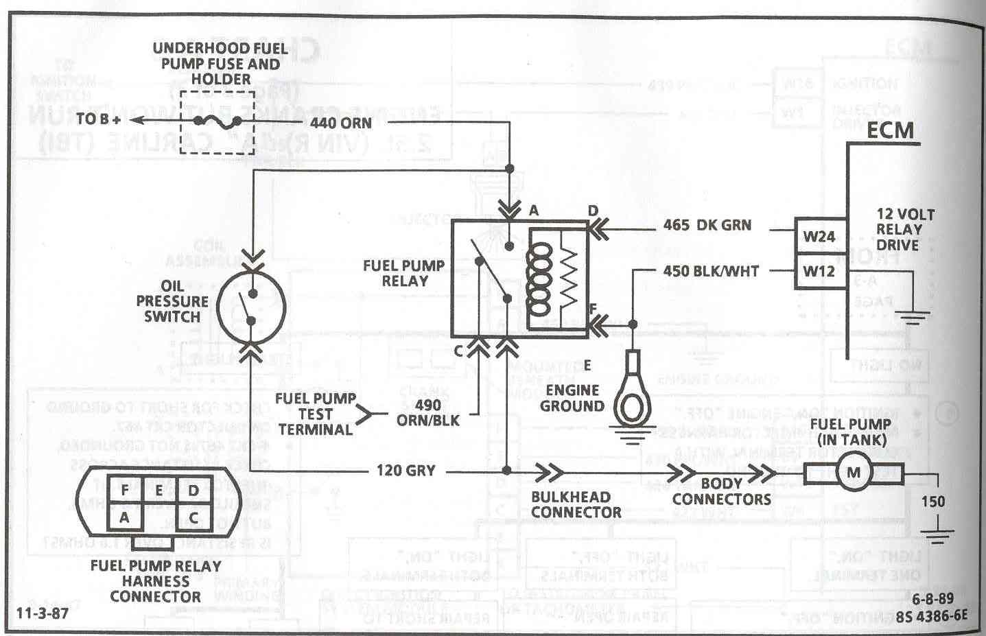

                          Point of order -- the fuel pump oil pressure switch will NOT kill the engine if you lose oil pressure. The oil pressure switch is in parallel with the fuel pump relay. If the fuel pump relay fails, the oil pressure switch will keep the fuel pump running. If you lose oil pressure or the oil pressure switch fails, the fuel pump relay will keep the fuel pump running.
                          The oil pressure switch is there because GM didn't trust the relay, not to shut the engine down for low oil pressure.
                          Don't believe me? Unplug the oil pressure switch and start your engine. It will start and run.

                            I was wrong about fuel pump circuit here is the wiring diagram. If you would like to test the fuel pump directly without any other circuits or relays involved, there is an orange w/black trace single lead wire as shown in the fuel pump circuit diagram. You will find it in a harness loom near the winsheild wiper motor, on the firewall. If you energize this connector with 12V+ battery voltage (key on or off) the fuel pump will activate and run for a pressure check (it will run the engine if cranking and no other probems present)
