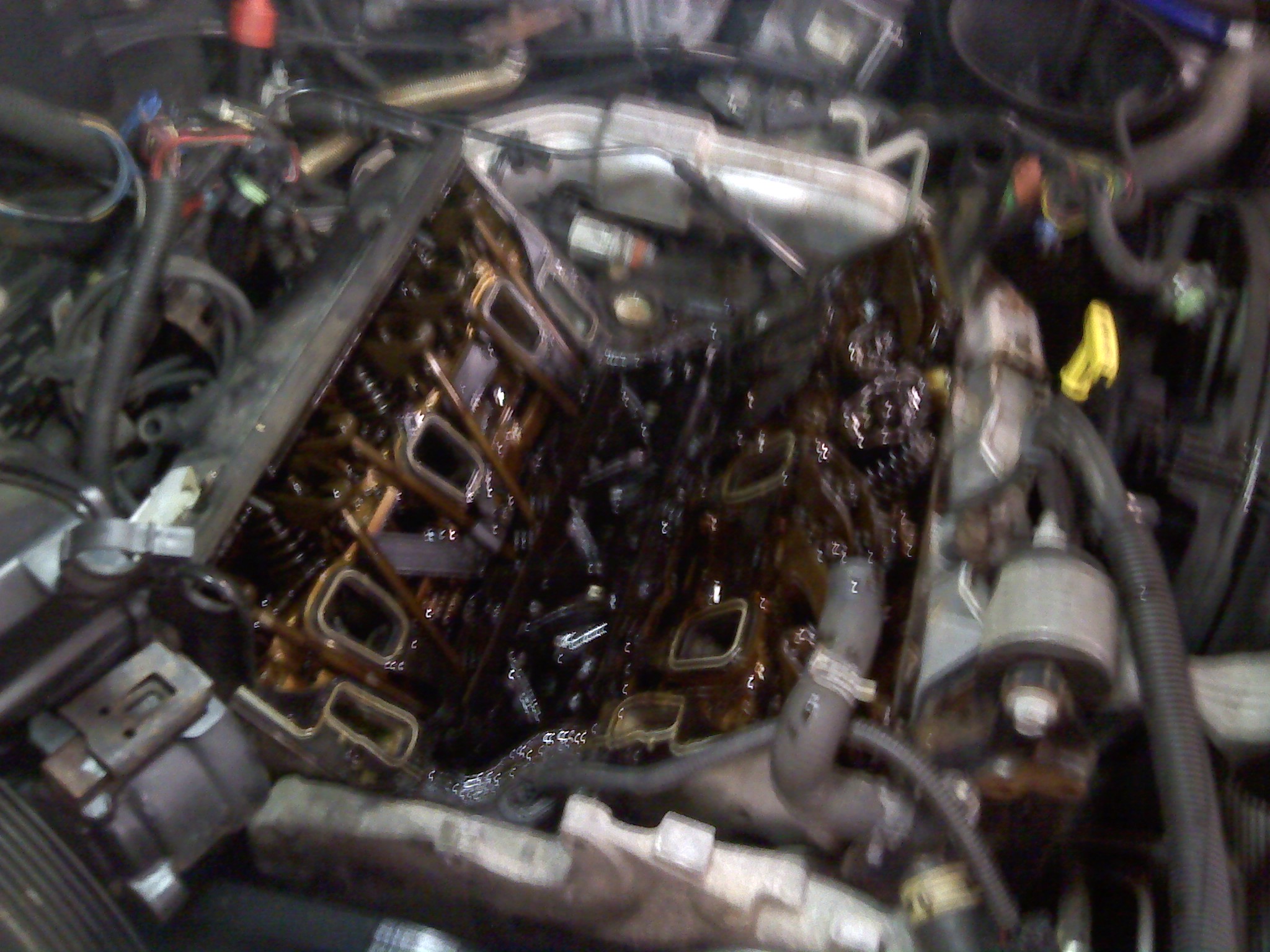

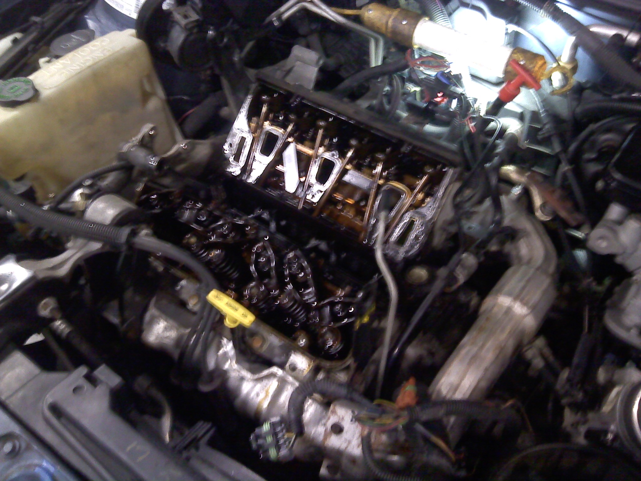

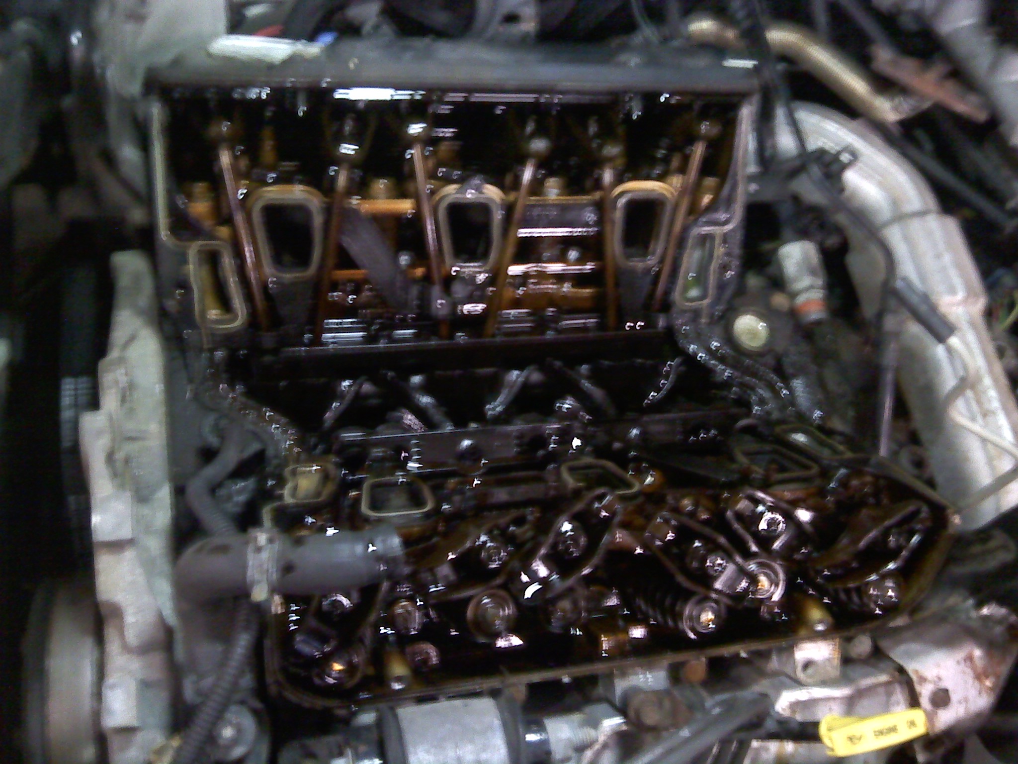

              Alrighty! Sounds like a plan. I got the pump out earlier today thanks to your advice, and am now somewhat stuck at a single step. I'm working on getting the right side (rear) pushrods out, but the valve cover has a tricky bolt, located right behind a coil pack mounting stud. I can't seem to get anything angled in there to get it out. Are there any suggestions here? I couldn't get a picture of the offending location, however I did grab a few of the current state.

                • 9190
                The coil pack mounting stud should be able to be removed somewhat easily...

                  I didn't see any means of removing it while I was back there. Have any idea how to do so? I don't know many techniques out there, so I find myself stuck quite easily.
                    If I remember correctly, it's got an inverted torx head on the end of it before you get to the threads that hold the coil pack down. Basically at the very end of it. You should be able to use a small box end 12 point wrench on it. I've used box end 12 points on inverted torx bolts before, but you won't catch me doing it on anything that has a good deal of torque applied to it or important bolts like bearing caps. If you don't have a wrench that will work, grab it below the stand off for the coil pack bracket with a set of vice grips. It's smooth there and boogering up that surface won't hurt anything.

                        So I attempted to remove the stud yesterday, but that failed. I used a T8 socket, which after flexing the stud a fair amount, slipped and rounded the head clean off of the stud. Being out of options, I bent the stud out of my way so I could get to that last bolt on the valve cover, just to find out...the head on that bolt was rounded off too. Out of options, I proceeded to break off the valve cover, and am going to be taking a few trips to some junkyards tomorrow to find a replacement cover, as I missed my opportunity to get to a dealership today. Simple jobs turn awry because of awkward engineering! Since I'm thinking about it...does anyone have a suggestion for a good product to de-carbon the EGR passages?
                          Sea foam. I normally just spray some carb spray and pick at it though. That sucks about the valve cover bolt. Personally I would go to the junkyard before a dealership anyways. Much cheaper. I would probably get one from a W body (GP, Lumina, Monte, ect.) because they have decent sized engine bays making it easier to get to the rear valve cover.
