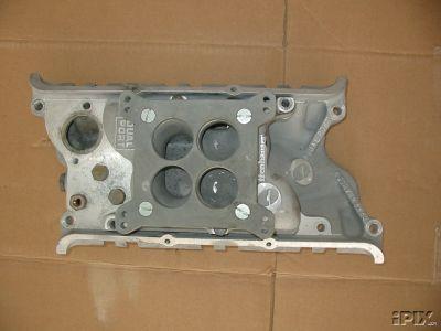

          In a moment of cool serendipity...Here is a Chevy S-10 Blog that features non other than our very own Geoff Moore (betterthanyou) helping out on this very subject... Ben... Since the motor involved on the S-Series mod was a 2.8L engine...would this manifold still work in this case... or does this image portray a V8 manifold?
            • 13522
            That is still for iron heads.
