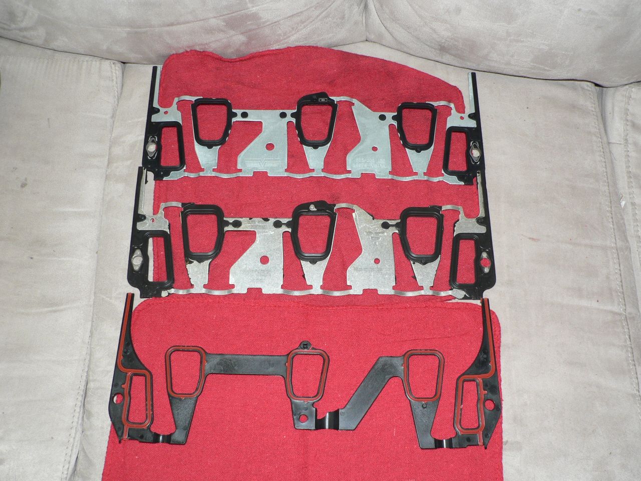

                          • 9185
                          Set the gasket on the head and take a picture, then post it on here.

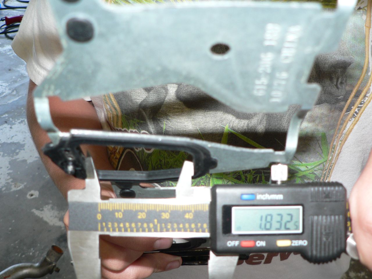

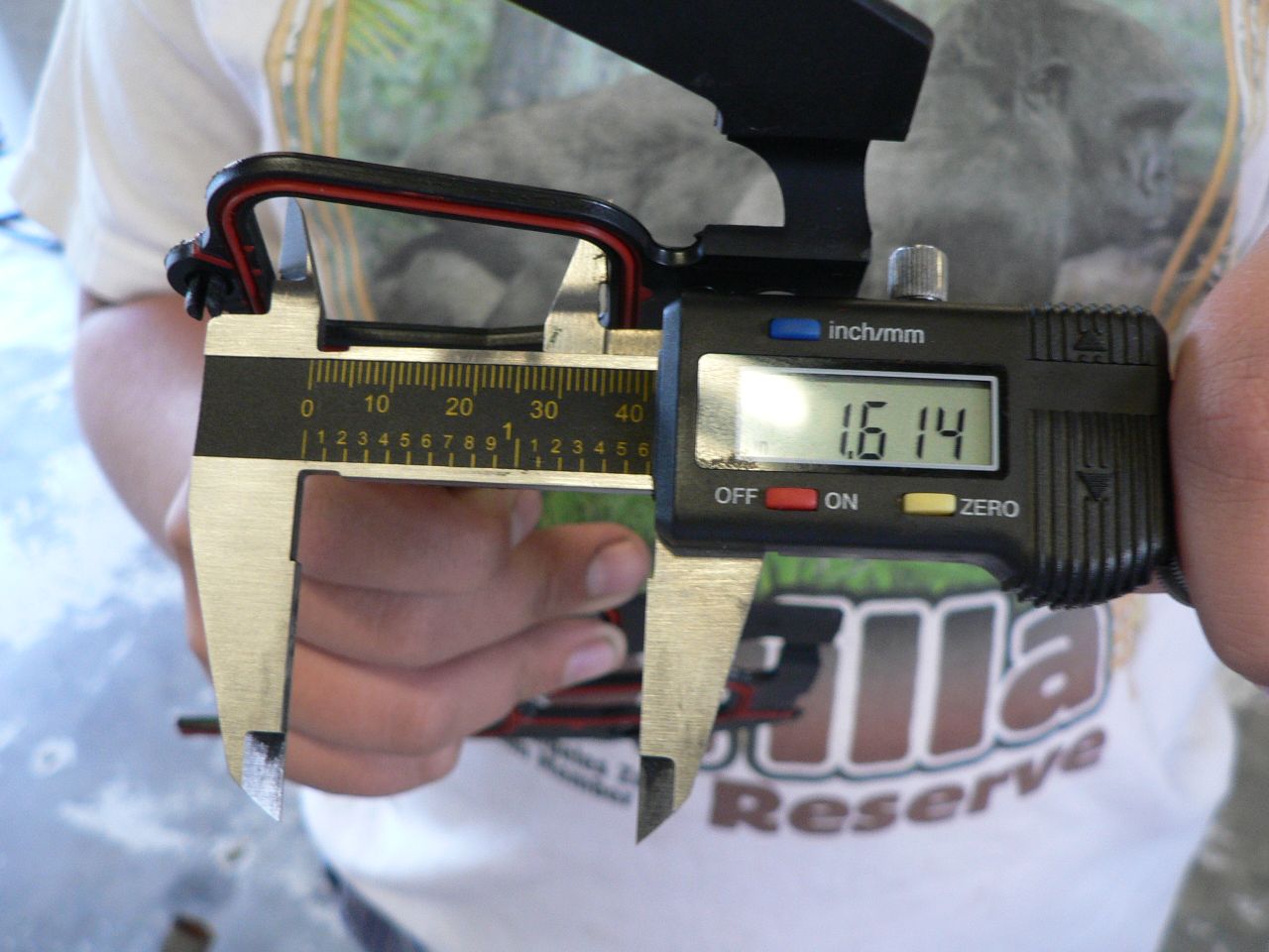

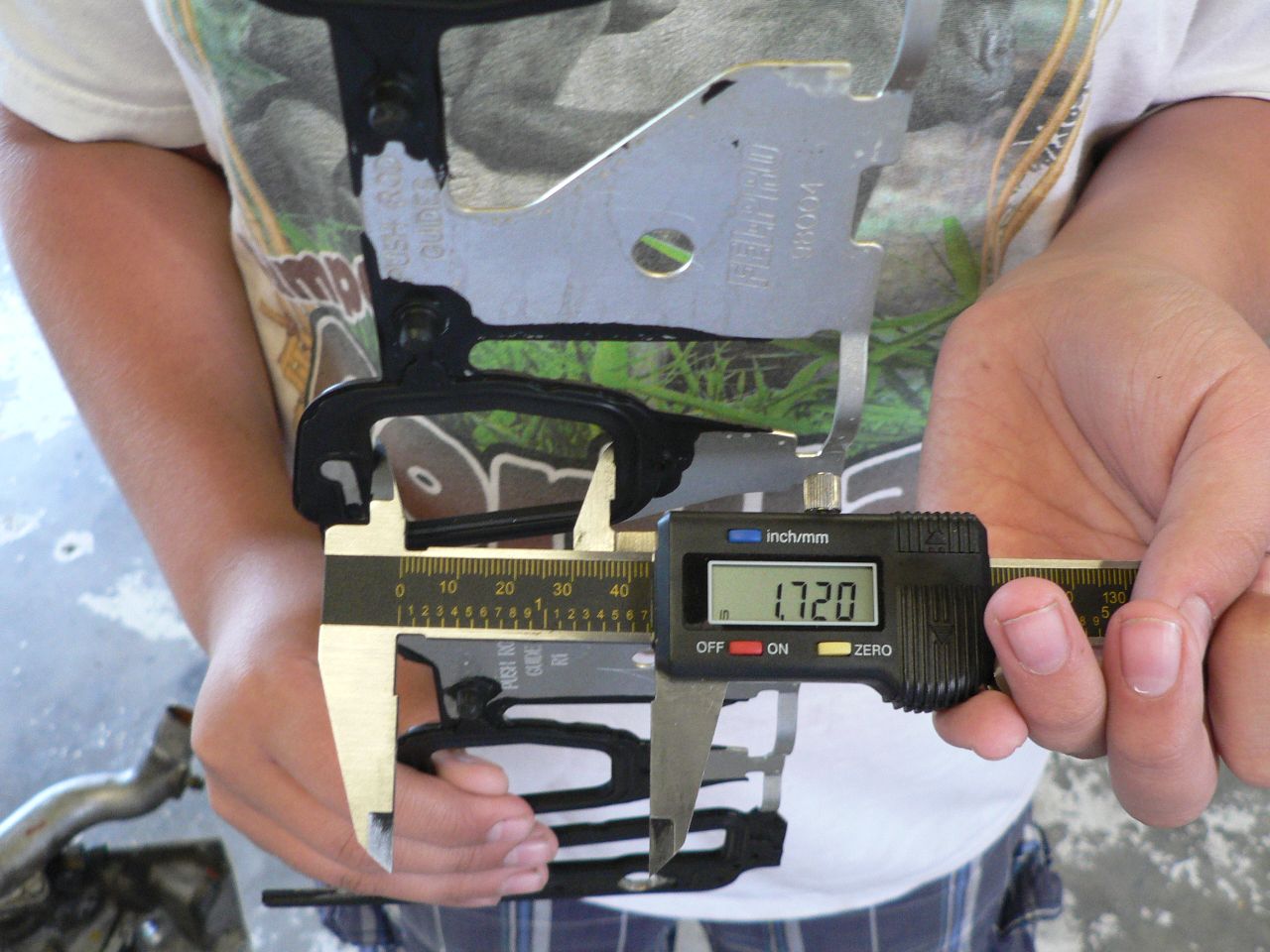

                              Okay, I measured each gasket with a caliper, and as I suspected, the Dorman 615-206 is bigger than any of the others. The Dorman measures in at 1.83 inches. The Fel-Pro 89004T Measures in at 1.72 inches, while the stock replacement Fel-Pro 95536 measures 1.61. Pictures are attached. It almost looks like they set all the tabs correctly for an "M" type engine, but used the measurements for a "J" type engine when setting the port size.
