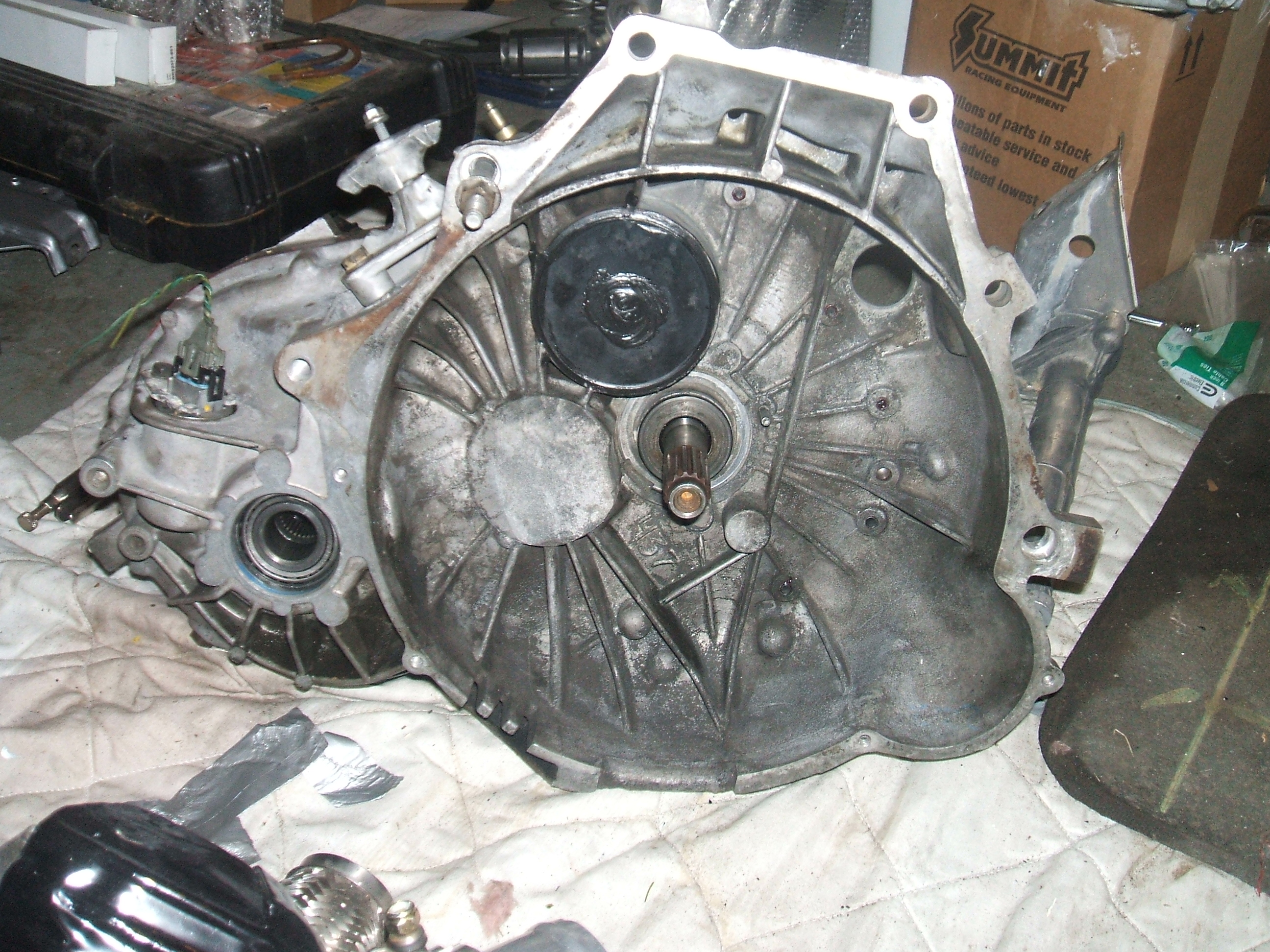

      Not many pics on this laptop. This is the inside of the bellhousing. I placed the htob w/o anything between the htob and bellhousing.
      I'm just going to pull the darn block/trans and get the Speedway Hydraulic Release Bearing set-up tool. Too many different parts to know for sure what the clearance is now.
      So I guess my REAL question is what is the best clearance I should aim for? I read 0.1"-0.125" is optimal but it was a Ricer forum found through google.
      Also, shimming the htob....can I simply shim the htob with steel cut to size/thickness or must I use proper shims? Assuming I need to shim, I won't know for sure until I remove the trans and measure.
      And what is best to shim to make up the difference? Flywheel or HTOB? It will be easier to shim the flywheel small amounts, but need to keep the starter aligned as well. To shim the HTOB I have various thickness steel sheets (0.012" - 0.032" - 0.064") so I can stack for a precise amount. Maybe I should shim both to prevent larger extensions on either side. Again, if I need to shim.

        i've swapped HM282 parts for years and never ever had to shim anything. as long as the TOB setup matches the bellhousing it should work fine. The masters are also different between the internal and external slave setups, If yours is an 89 then it's for the external and that may be causing a problem when used with an internal slave.
        I'm assuming you have a stock 60v6 flywheel for a 5 speed 2.8 or 3.1 Gen 2 engine, and the clutch is made for the same setup. Part numbers would be helpful though. It has happened in the past that people get an incorrect pressure plate that causes all kinds of problems.
        The flywheel, pressure plate and disk are all the same for all V6 HM282/NVGT550 trannies regardless of the slave setup.

            I wouldn't install the shim, but that's me.
            You have a hydraulic slave, it takes up the extra slack from clutch disc wear just like your brake system does for pads. That's why hydraulic clutches don't need to be adjusted like cable driven clutches as the disc wears.
              It could just be a bad slave too...
              Pulling it out would be a good idea though, you could test it on the bench and see what it's doing. You might be able to pull the starter off and with some luck be able to see the slave through the hole and have a buddy push the pedal.
              Flywheel shims are sometimes used after a flywheel has been shaved a few times, on the older HM282's with the shift fork this is sometimes needed. For yours you shouldn't have to worry about that. Especially if the flywheel is new.

                    Okay, this is what I found.......
                    My clearance is 0.1" (actually just shy of 1/8" which is 0.125") - PERFECT
                    The fingers had signs of engagement with the htob. - GOOD SIGN
                    The HTOB, however, had an issue with bubbles. Really small micro bubbles that looks like contamination in the fluid. I lowered the slave and positioned so air had a clean upwards path. Power bleed from the bottom up. But still had air in the slave, I could feel/hear it in the lines.
                    I then decided to pump the slave by hand. Drawing from the reserve and pumping back up. By pumping the slave I could really feel the air in the system, bubbles jetting is the best I can describe it. I noticed a reduction after several pumps, after a good 15-20 minutes pump/bleed/pump/prime... I finally got the slave free of air. Now the slave has force when the pedal is depressed.
                    I can only speculate why the air was so hard to get out of the slave.....? Maybe a design flaw....
                    Testament to bench bleeding!!! It can save time and money.
