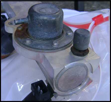

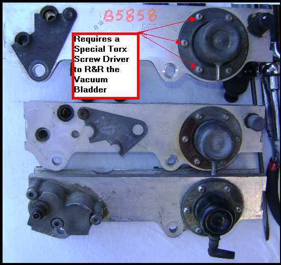

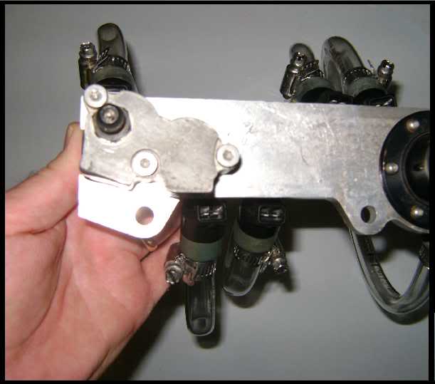

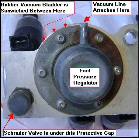

Was there any other engine damage... Pistons "Kissed"... Supposedly ... the early 660 engines with iron heads were not interference engines...but with the heads off maybe you could see if anything got "smacked" and allowed the chance of bent rods? First thing to check is whether the Fuel Pressure Regulator has gone bad. This can be easily diagnosed by simply pulling off the Small Black Vacuum Line from the side of that "Little Black Top Hat" vacuum chamber on the top of the Fuel Rail. If you either see pure, liquid gasoline coming out of that line or smell the heavy odour of fuel there...you will have found the culprit. RockAuto sells a Repair Bladder Kit for around $75.00, but you will also need a tool kit containing "Special Torx" drivers that will insert into the set of screws around that top hat....and fit inside the Torx Screw Head and over the small pins sticking up from inside these special fasteners. Make certain you bleed off any residual fuel pressure via depressing the Schrader "Bicycle Tire" Valve into a catch rag BEFORE attempting this repair...and IIANM...this fix can be done WITHOUT having to remove the Fuel Rail and injectors to do the job right. Park the vehicle away from the house and keep a fire extinguisher handy. Take the Ground Cable off of the battery B4 you open or undo any part of the fuel system to affect this repair. Lay out a clean, white work towel that you can lay out the new and old parts on and not drop or lose any of those damned tiny Torx Screws and you will not regret all this preparation.Last edited by 60dgrzbelow0; 02-22-2012, 08:09 AM.
