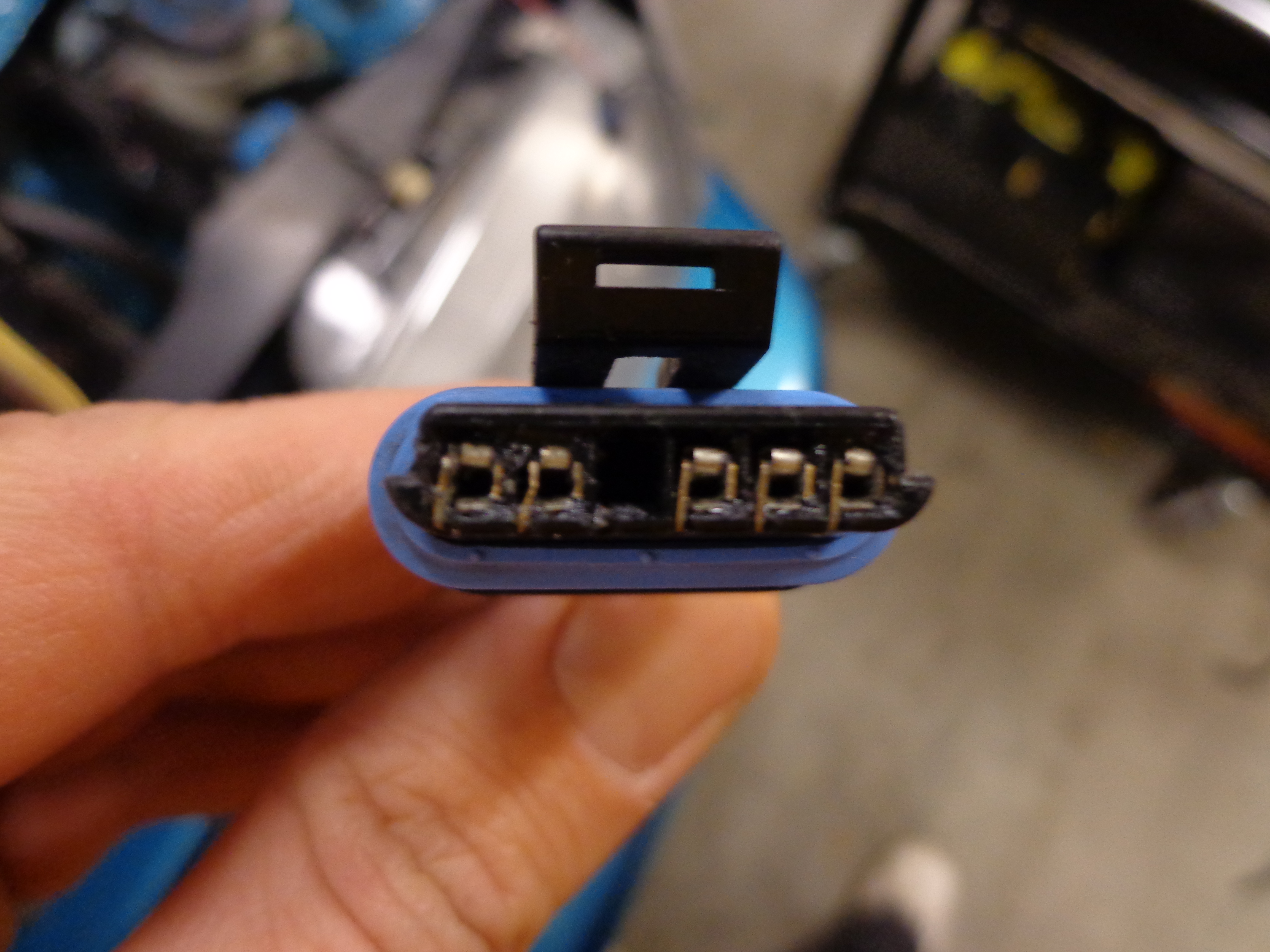

                        I had cracking around my terminals too! When my ICM went out (again) about a year ago, I saw cracks on two of my 3 coils (DIS).
                        My 93 Caprice Police Car had that same ignition system as in the pics. I believe MSD and Accel also make coils of that variety.

                          Here is a post from a-body.net which may help here. This is a Buick engine, with the bolt-on DIS module connector. The terminals are identical to the ones in the connectors for the 60°V6 DIS, so the same damage could happen. It seemed like DIS modules kept failing again and again, but it was just the connector. Removing and reinstalling the connector would "disturb" the damaged contacts and it would work again - for a little while. This was shortly after I got the car and hadn't found all the gremlins in it yet!
                          Originally posted by turbokinetic
                          About a month ago, my 1987 Century Turbo Sedan, with LG3 3.8 SFI engine quit running about a mile from home. It was just like the key was cut off. It seemed like an ignition issue. There were no codes and the laptop diagnostics didn't reveal anything unusual in the real-time sensor readings.
                          I tried swapping out ignition parts from another running car. I swapped the DIS module/coil assembly; crank sensor, cam sensor, and ECM/chip assembly. Nothing would make it spark. The parts from this car were put on the other car, and it ran normally.
                          Fast-forward to today, after a month of being out of town and other distractions. I got the engine started and finally determined that moving the harness near the firewall would provoke it to stall. The trouble ended up being the terminals in the connector where the harness plugs into the DIS module. This has the Magnavox DIS with the small screw in the middle of the connector. These terminals were "forced open" wider than they are supposed to be, preventing them from gripping the pins in the DIS module. It appeared that someone had forced an electrical tester probe into each terminal and damaged them.
                          It took about 5 minutes to fix, after LOTS of head-scratching, testing, reading diagrams, and shotgun-style parts swapping. Sometimes the simplest things trip us up. Just a reminder not to force a tester probe into that style of Delphi terminal. And you never know what the previous repairs have done to a used car.
                          Here are pictures explaining this fix for a faulty ignition module connector caused by loss of pin tension. Applies to all engines with DIS and bolt-on connector.

                            WOW! Thanks David!
                            That is AWESOME how you fixed that yourself! Turns out, that is EXACTLY what was wrong with my system.
                            But I just now got it fixed...where were you when people were battling over whether to use thermal paste?? LOL
                            I have noticed, however, that the 60 degree V6 (BTW- How did you put the degree symbol in your post?) IS a different harness (3 of them, actually) than the 3.8.
                            BUT, it WAS the exact same problem! Too bad that I spent all the money and time to buy and solder new new harnesses instead! On my two pin harness, the connectors were so deformed that I doubt I could have repaired THAT one.
                            I applaud your ingenuity in your method of repair!
                            Thanks again for your detailed post!

                              Thanks for the comments! Growing up in a family who was conservative with money tought me to find ways to fix things without buying stuff, whenever possible.
                              But yeah that one looks kind of past repairing. You were probably better off with a new one.
                              As for the thermal paste... LOL I don't like arguments so I wouldn't have been interested in reading that. Thermal paste has its place, and is called for by the factory for certain things, like HEI distributor modules. There are other products (dielectric gel) for connectors. They help keep corrosion at bay if the connector was clean and new when it was applied and not already corroded.
