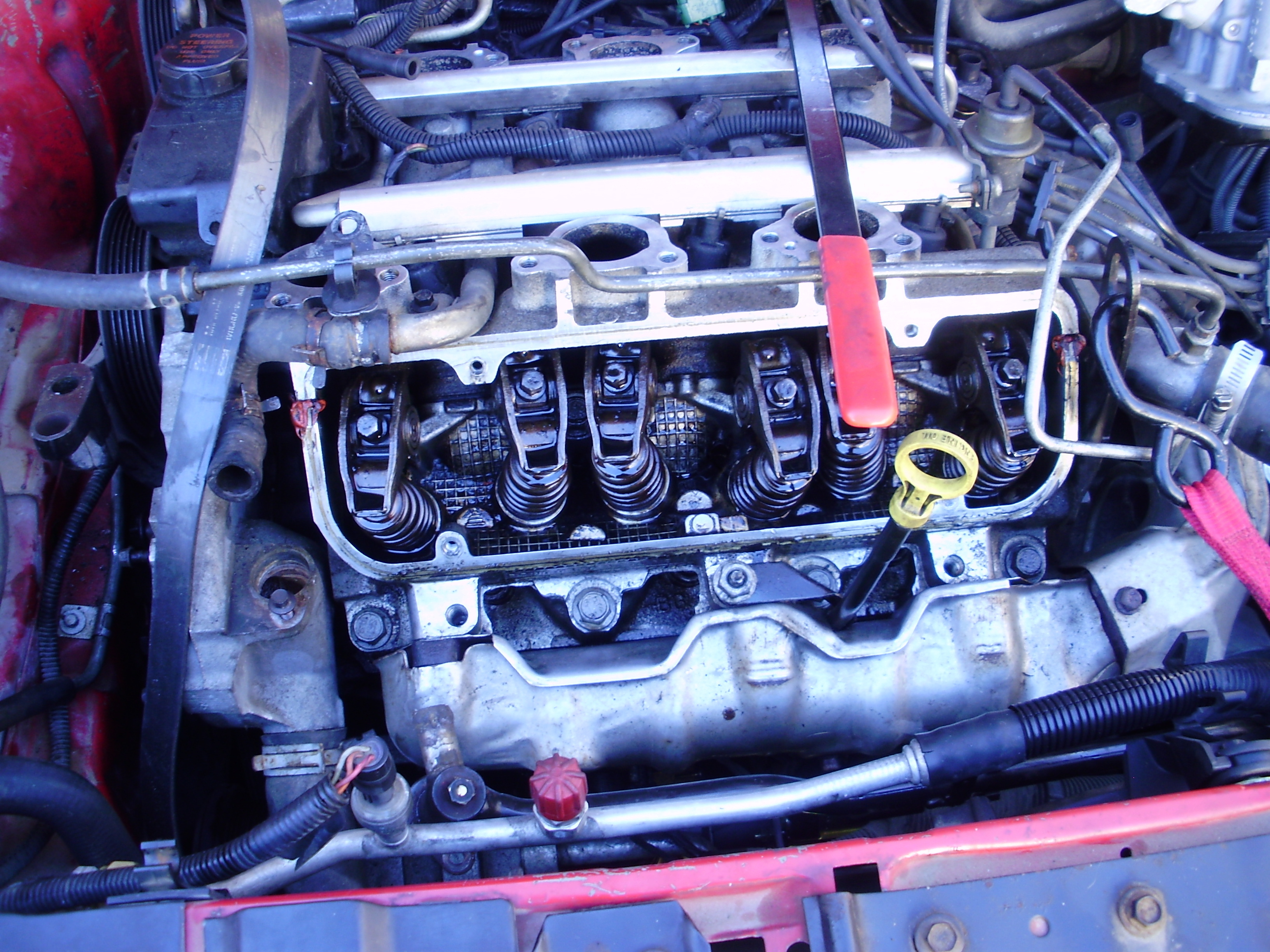

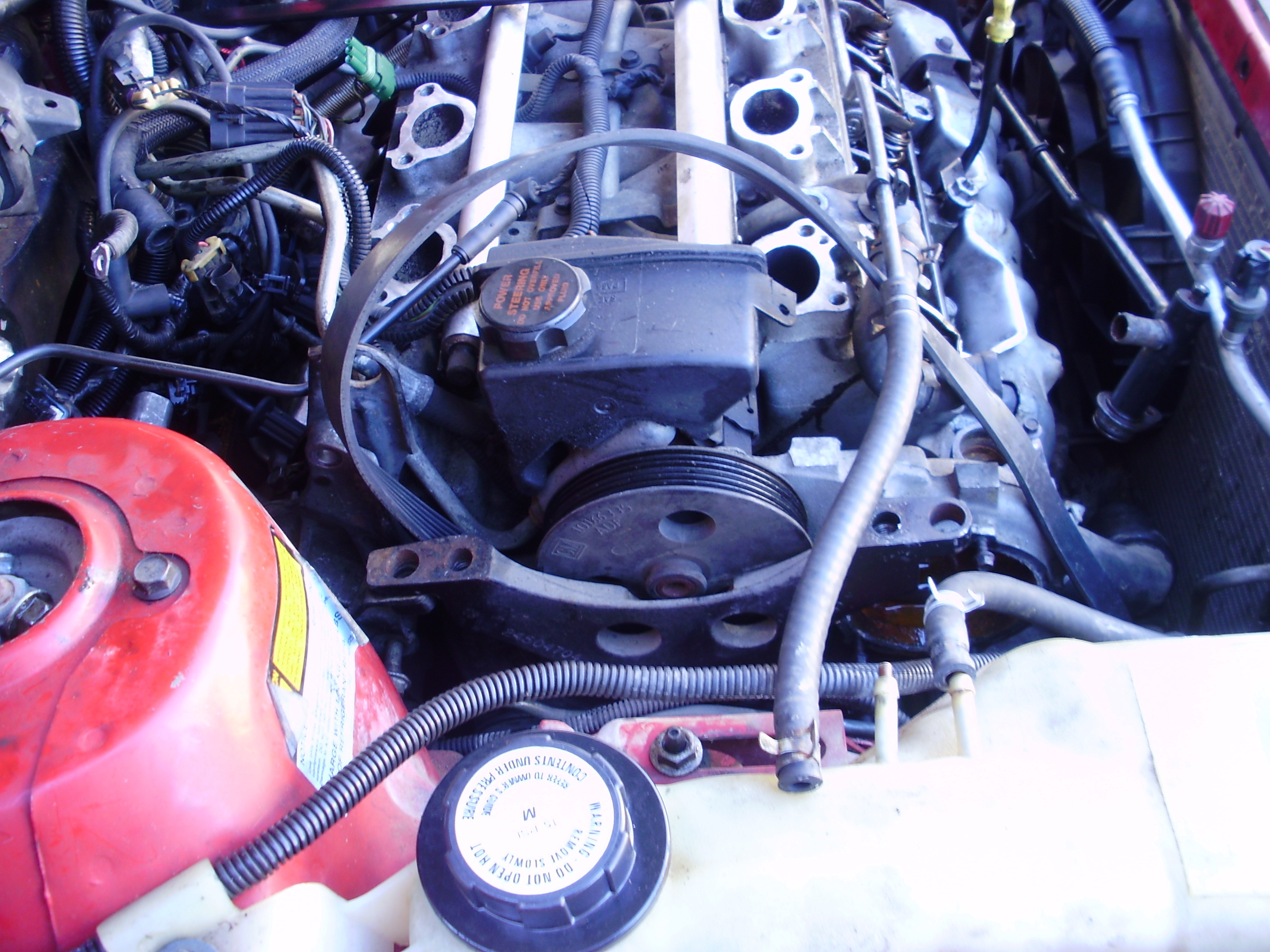

                          I'll take some pictures if I don't forget. For all I know it may not be possible to replace the bearings through the oilpan. But if so it'll suck to have oil dribbling on my face while I do that. Progress so far.
                          You can see this is one of the engines with roller rockers. There is oil and dirt deposits in the lower intake ports. You can see the area next to the pulleys after I took the motor mount out. It was held on by two bolts behind the wheel going in horizontally.

                            Wait... you're planning to slide the pistons out the bottom? yeah that won't work, for various reasons, but the block just won't allow it, on at least a few cylinders.
                            Do you self a favour and buy or borrow an engine crane and engine stand, you'll save yourself a LOT of time and effort just pulling the engine out, and that way you can refresh it properly.

                              I think he plans to remove the cylinder heads off, then push out the pistons and rods from the bottom of the oil pan. He can replace the connecting rod bearing but not the crankshaft bearings.
                              He wanted to keep the motor inside the engine bay while replacing the rings. Remember to change all them seals including the dizzy one which is exposed with everything removed.
