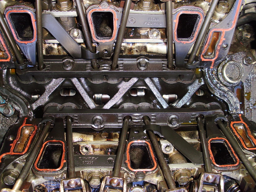

          Had to wait a day for the fuel line disconnect tool. Here are some pictures.

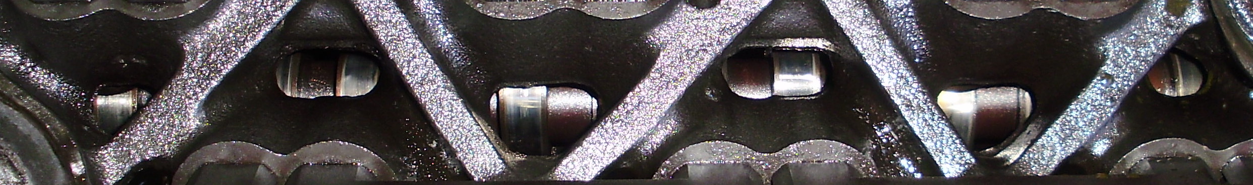

          According to this the camshaft doesn't seem to look too bad. What do you think?
          It's probably a good idea to choose a specific oil for this engine and maybe go up a weight grade.

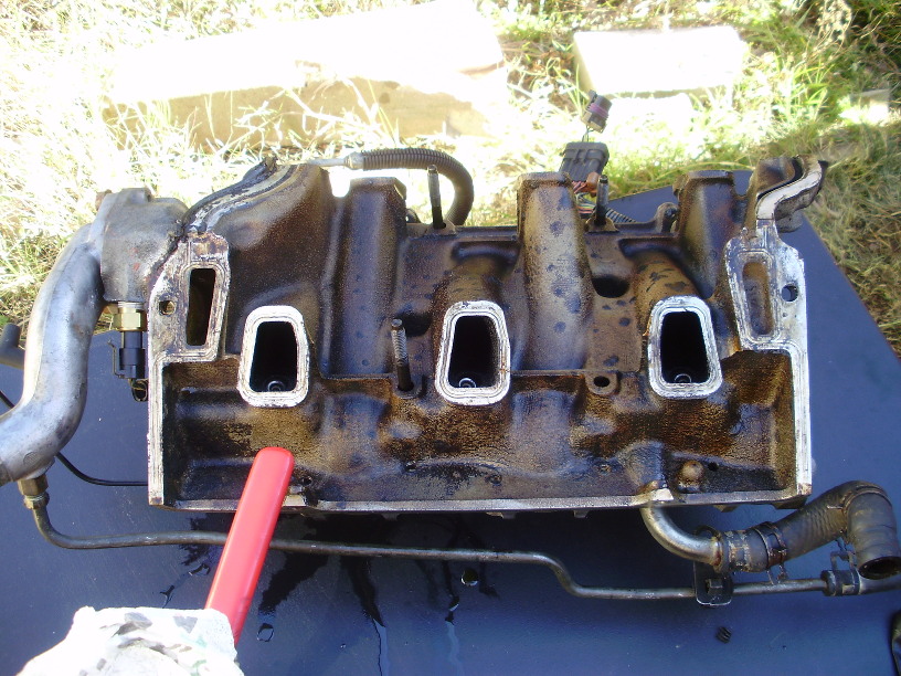

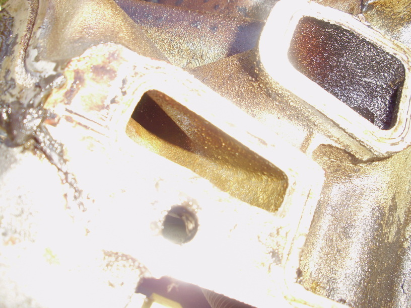

          Coolant passage looks very clean, oddly enough. If the head gasket failed, it failed between the cylinders without failing at the fluid passages.

            The engine is filled with what looks like pieces of old gaskets and grommets, and gritty stuff in general.
            One of the pushrods appears to have been replaced, oddly enough. The rest of the pushrods show an obvious smooth wear pattern around the oil hole.
            None of the brackets around the pulleys will come off because there's not enough clearance to remove the bolts. Not unless I take a hole saw and make swiss cheese with the wheel well. It looks like I can still take the heads off without removing the brackets though. I can't take the bracket off the engine so I have to take the engine off the bracket!

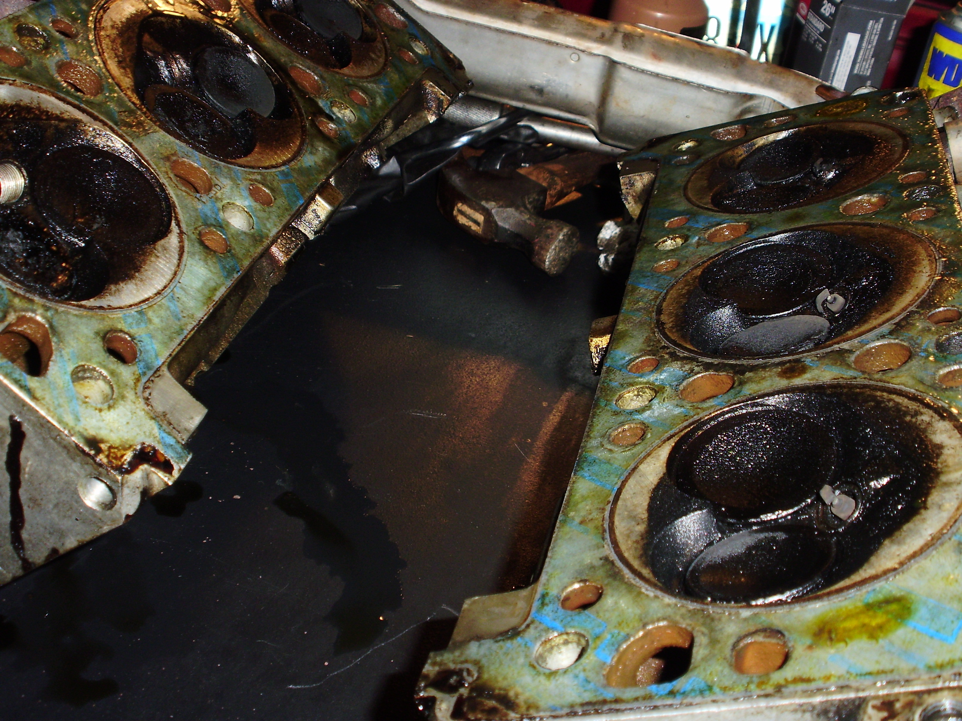

              On this engine the dipstick tube has a bracket that next to one of the head bolts. The bracket prevents the heads and exhaust manifold from coming off in one piece as seen on youtube... The bracket broke off, so problem solved. It left 4 neat small holes in the tube, which will be easy to seal with silicone tape. Then I'll wire it back to the bracket.
              I'm lucky I was able to get the heads off with the exhaust manifold because I rounded over one of the heat shield bolts. I might not even try removing the manifold because dealing with exhaust bolts is not something I'm prepared for. Hopefully the smoke I saw rising from it was stuff burning off or came from somewhere else.
              There was frost on the car when I stopped for the day. I mopped up the coolant out of the cylinders, sprayed everything good with more WD40, then wiped it down with motor oil.

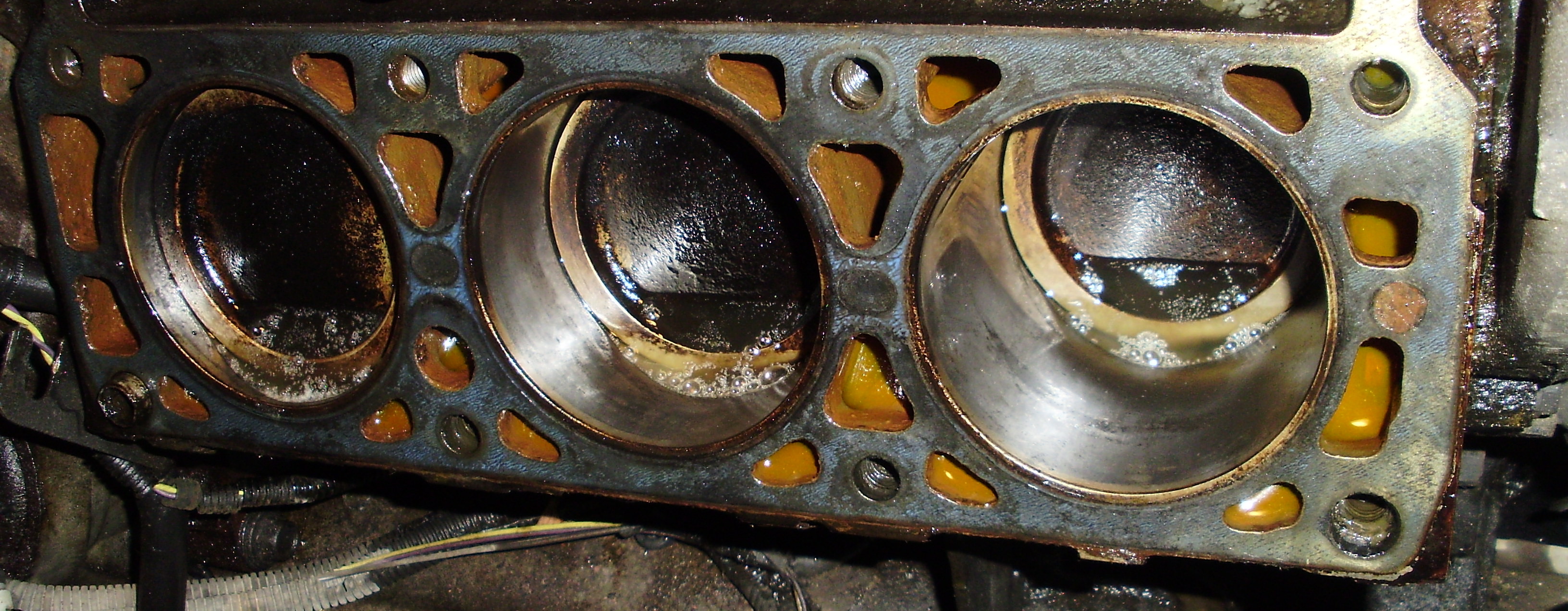

              Here are the pictures. Please advise on the gunk level, cylinder wear, and what you would do to prepare everything. I didn't notice any evidence of valve problems while I was troubleshooting it. The cylinders are polished, with some faint vertical streaks and what appear to be scuff marks.
              Rear cylinders.

              Valves. You can see the decals from the last head gasket are still in good condition, but on the head rather than the gasket.

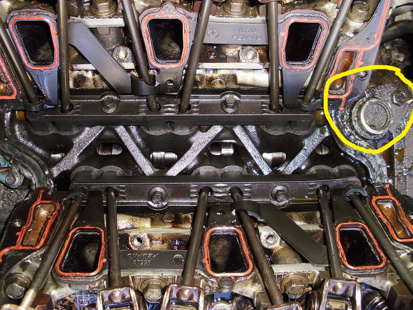

                              • cutlass supreme FE3
                                • Nov 2008
                                • 225
                                #30
                                here is the dizzy seal that seems to create massive oil leaks if not replaced.
                                for a few dollars with everything off just replace it.
                                I circled it in yellow in one of your pictures.
