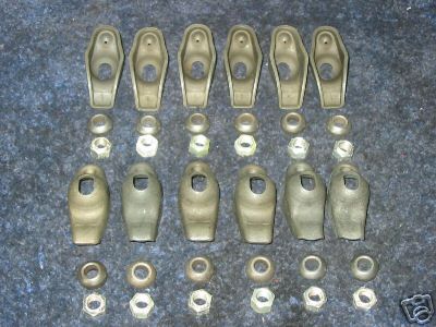

          found a picture of what I had on ebay
          Experience is an expensive teacher, but fools learn from no other. Mark Twain
