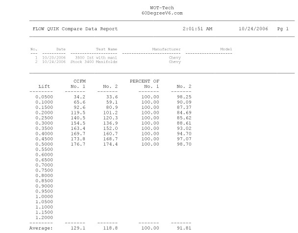

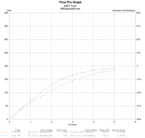

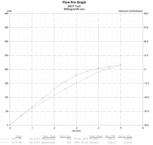

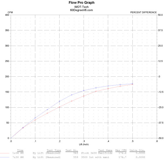

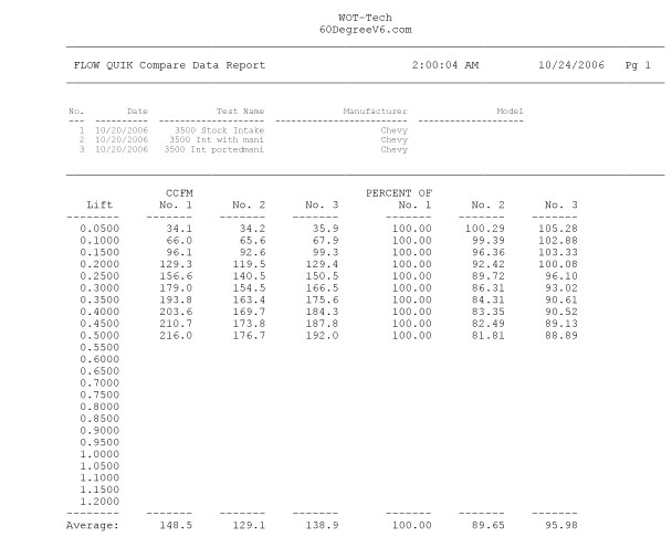

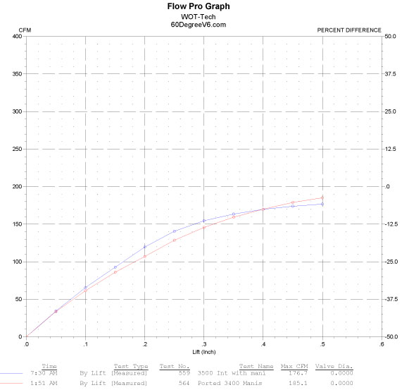

Flowsheets, 3400 vs 3500.
    • 13531
    Adobe acrobat file and pictures for those that don't want to use acrobat (they look better though).
    Flowsheets include Stock 3400 vs Stock Manifolds vs Ported manifolds*, Stock 3500 head vs stock manifolds vs ported manifolds, 3400 vs 3500 head, 3400 vs 3500 stock manifolds, 3400 vs 3500 ported manifolds, stock 3500 manifolds vs 3400 ported manifolds. Graphs for some included since graphs seem to make more of an impression than just numbers.
    *in .pdf file only. It is in the 60V6 store section right now as well under 3400 ported manifold set.
