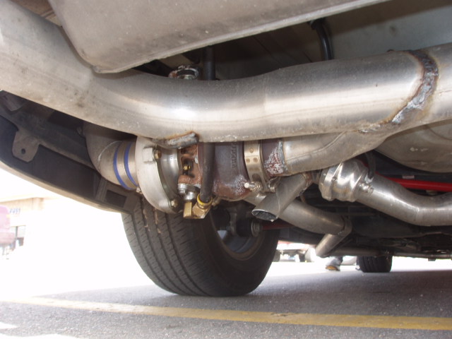

    I got lucky today and had a firebird with a rear mount turbo come in the shop, i have to admit after driving one i can say the system works better than i could have ever dreamed. Heres the info 5.7 car with rear turbo stock exaust, the car produces boost as low as 1400 RPM it was around 2 pounds there and produced full boost at 2800 RPM of 9 pounds, there was no turbo lag at all, and the intake temps where very good less than 130 even at full boost, the only thing i didn't like about the system was the way it oiled, the return goes into the oil cap and just looks cheesy. a remote oil system would make these units ideal, i would love to put on my car this things is awsome

      of and the oiling: it uses engine oil pressure to feed the turbo. it uses an electric scavenging pump to feed oil back to the motor. if the pump dies, the car just starts smoking cause the oil is building up in the turbo.

          yah and sts (who makes the rear turbo) has the patent on that scavenge kit for the oil, and it doesnt have to inject back through the cap, that is just the easiest place where they can feed alot fo oil and it not get in the way of anything else. plus they dont need to be intercooled to produce good power without robbing timing and they can be used to higher boost apps on stock engines. also with the methanol injection kit you can go massive boost on mostly stock engines with no kr, detonation, or any high heat temps under the hood, plus it helps take more advantage of a coated exhaust, keeping the heat in the gas and making the velocity higher, plus you can use them with better fitting headers and many other mods without making too many adjustments, cuts, or rearranging
          and they even make a syst with dual tips where the waste gate goes through the one tip and the turbo is on the other

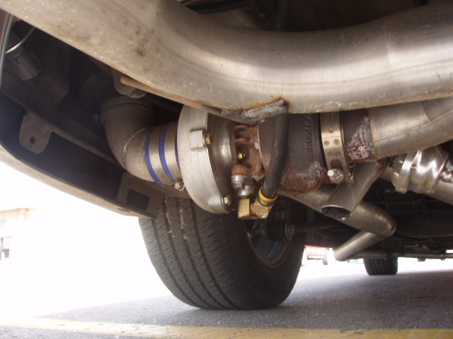

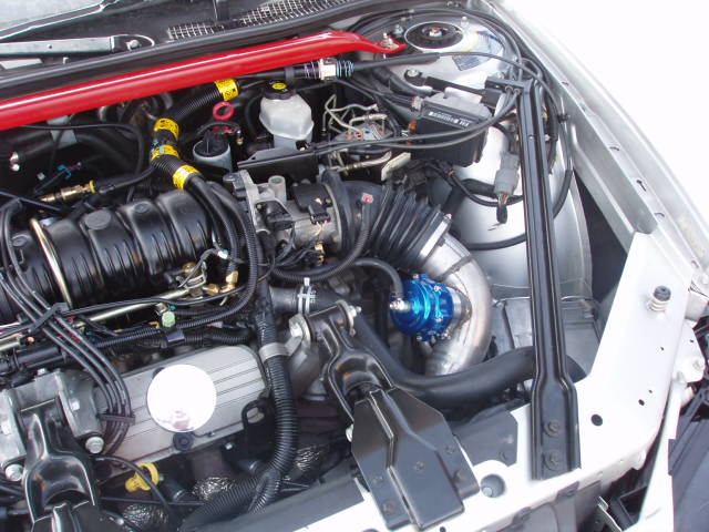

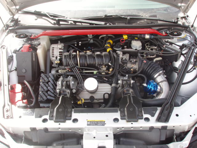

            sweet setups for sure...i got some pics on a gp here locally with the sts kit if you are interested.......

              yah i wanna see em, what year model?

                coming right up........i think it was an 01

                  two more........they also have a gtp that is twin charged with the sts but i'm not sure what i did with those pics..........

                    are they not using the oil cap return line? if not where are they putting the oil back in at?

                      so the smaller pipe running up the drivers side is the intake piping? does it have an intercooler also?

                        not sure exactly obviously t'd in elsewhere

                          thats how mine is gonna b also, but with an I/C also

                            i rode for quite awhile in it and even without an intercooler the temps stayed down pretty far, about equal to what i used to pull on my roots/w2a setup.....

                              sts claims that the pipe running from back to front works as about a 50% efficient intercooler, and claim less that 0.5psi pressure drop, were a normal intercooler is 1.5-2psi. an intercooler actualy isnt needed.
