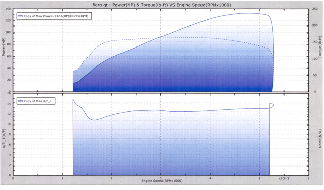

                  dyno
                  Here it is.
                  Notice the air/fuel mixture graph. The spike down is the accellerator pump being too rich. You can see where my secondaries at the time were too lean. These two conditions are a whole lot better now. That rich accellerator pump caused a noticable bogg and hurt the lower rpm hp numbers.
                  There is a spike near the top on the hp chart which was a malfunction in the sensor which you can ignore.
                  I am hoping to bring that peak hp band back down at least 600 rpm so I have more usable power between 2500 and 3500 rpm by advancing the cam timing. The tuned extractor style exhaust should add probably 5-9 hp overall.
                  Arn

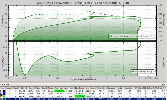

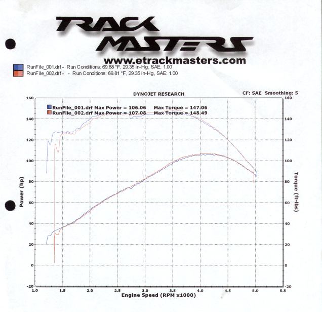

                              Shaun, as usual you are totally full of it.
                              The stock 2.8 dyno showing 107.08 peak hp (as posted on the Fiero forum) does fall rapidly after 5k as did my initial dyno run when I let my foot off the gas at 5200 rpm instead of 6000. (before a tune-up) (see both below)
                              My 130+whp result is not a bad gain for the limited work done. It will be higher and it is perfectly acceptable for now. Where is your dyno of your 2.8 and the dyno with your ported heads?? Show your sheet if you have one.
                              There are no ported 3.1 heads on my engine and it has the original cam. BTW I once had a 3.1 rated at 130 hp with an auto and you can bet it did not make 110 hp at the wheels.
