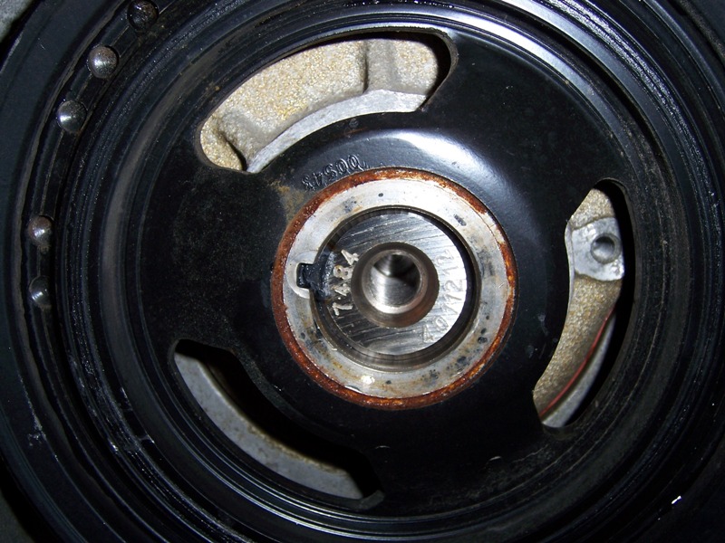

                        • Joseph Upson
                          Originally posted by wasas9 View Post
                          im assuming steel because they do not end in 7484
                          If they do not have 7484 as the end of their part number they are CAST IRON. The 7484 is steel and that's what makes it stronger. I'm not sure where the forged idea came from. When I sorted this out months ago with GM parts direct I was informed of the weight difference which I posted on here somewhere being about 5 lbs between the cast crank and the steel crank and that's how I was able to make the 7484 association which was stamped on both of my cranks.
                          The cranks are not exclusive to any 3500 vehicle from what I have observed and if you check GM parts direct you'll find both numbers listed for pretty much all of the applications. GM helped us out by putting the number on the end of the crank so that simply removing the balancer bolt would reveal this information before your purchase.

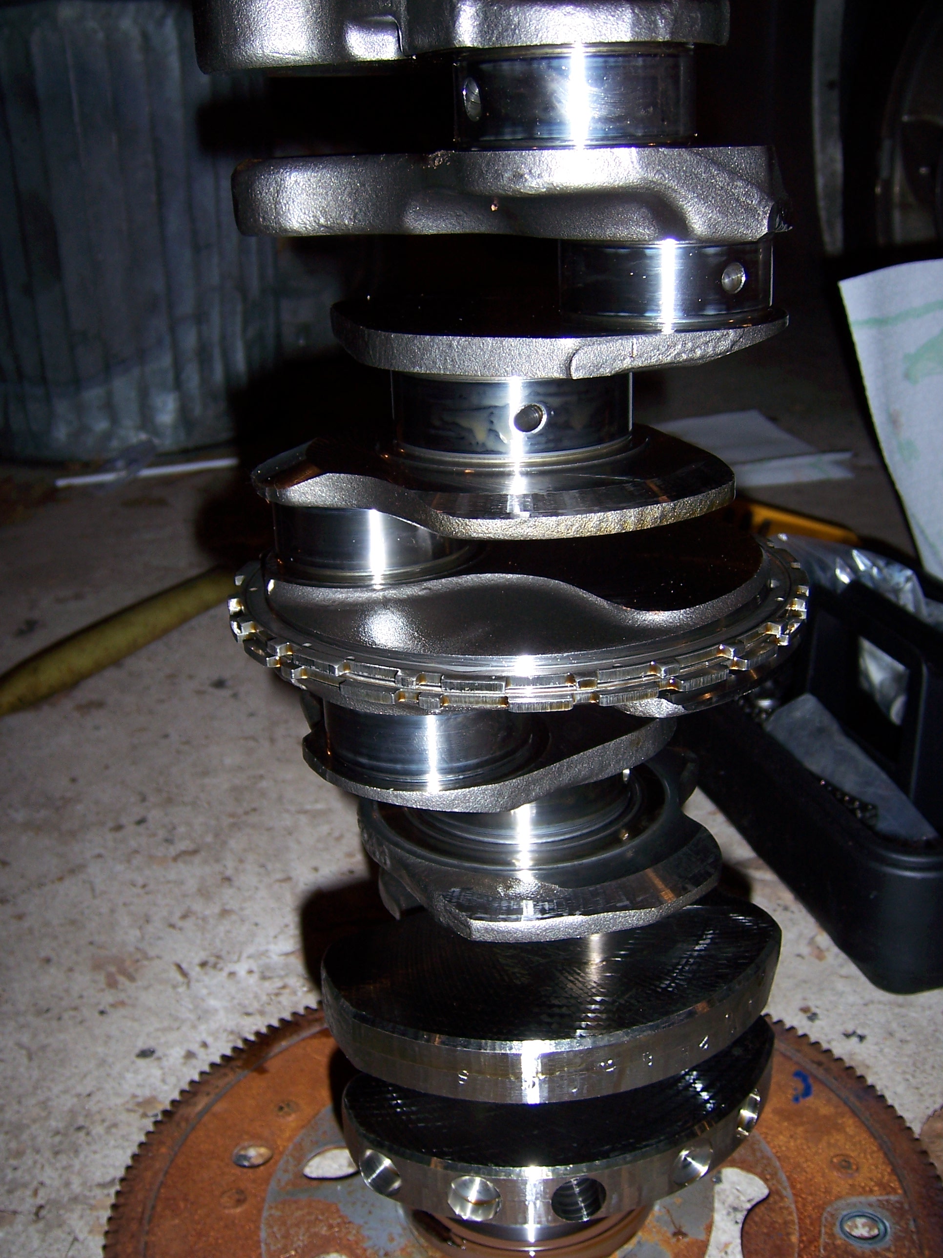

                            • 13500
                            http://60degreev6.com/gallery/browseimages.php?c=12
                            I uploaded more pics so there should be enough there to figure it out. As for being forged, I thought it was forged steel.
                              This is what came out of the 04 3500 I bought.
                              Definately steel, Forged, well I guess thats up in the air now.
