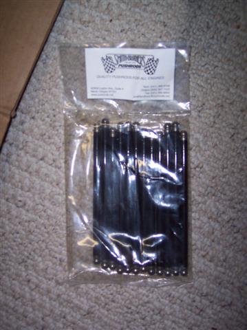

        here is a pic of mine...
          I should be receiving a package just like that sometime this week...
          Oh and Dave you just added the base circle radius loss to your pushrod length to get your new length correct??
          Thats what I ended up doing.
