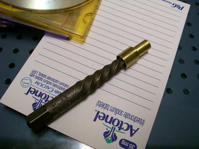

                          Professional screwout FTW
                          Really everything that Sears and Home Depot sucked... I could get a drywall screw out with their stuff and a drill but with this, a 12pt 10mm socket went on the end and it came right out.
