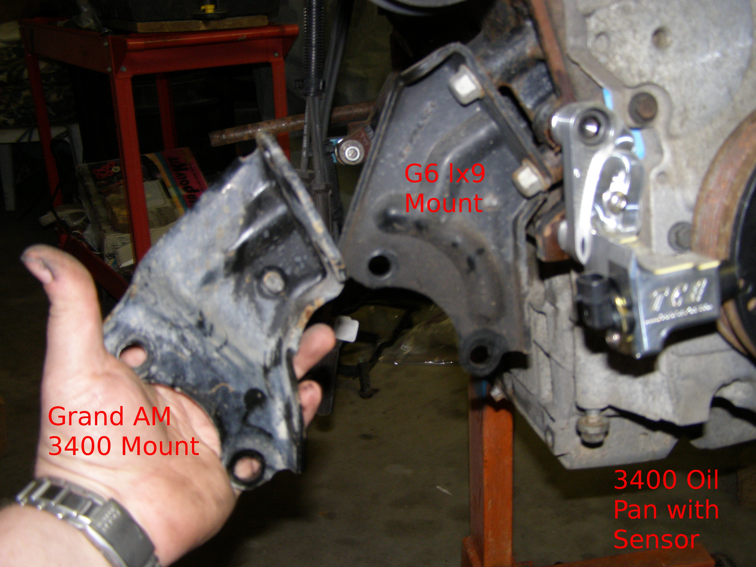

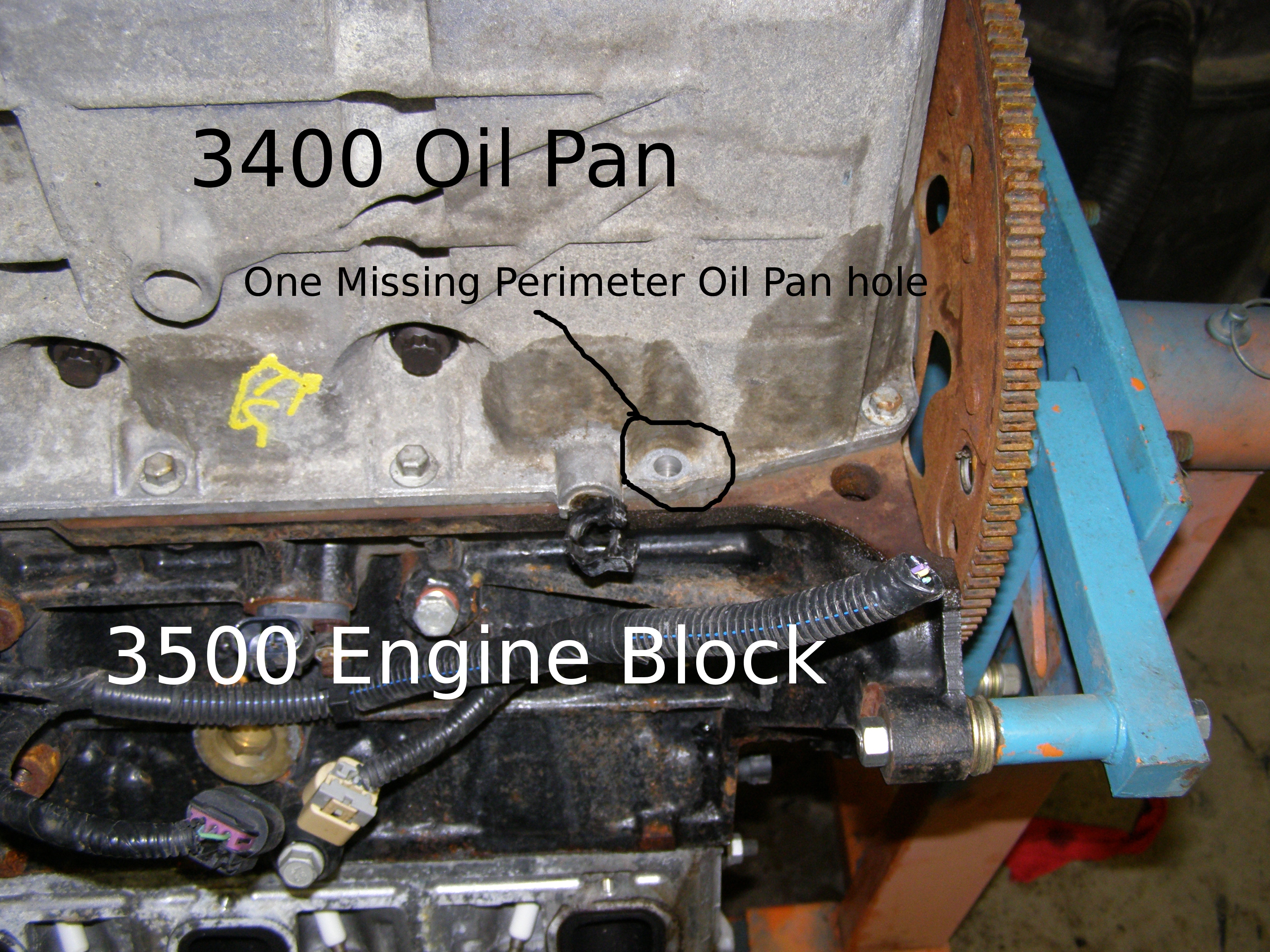

              I used a 3400 oil pan on my 3500 block. No issues with clearances at all. Ive turned the crank over by hand before putting it in the car and nothing hits. And yes 1 perimeter bolt hole is missing in the block. It could be tapped however I used the pan with 1 perimetor bolt missing. Probably not the best solutions, but I have no leaks. As for the lower engine to tranny mount. The solution is a mount that was made for the engine. As the G6 came with a 4t45e, the upper block to tranny mount is a perfect fit and the lower one from the 3400 that bolts to the oil pan lines up perfect as well. No Drilling whatsover needed.

                #472
                Interesting. The block is notched and the pan is matched. I am surprised the stock 3500 connecting rods clear without the pan clearance.
