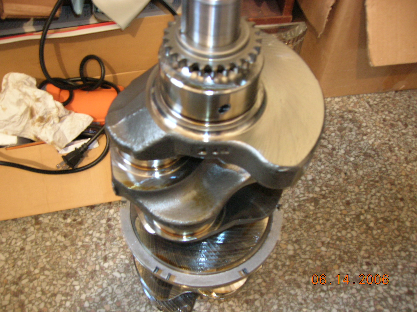

    If it has the wide seem line it's steel even if you can't find the last 4 digits of the steel crank part number on the crank snout. I don't remember what they are but they're posted. More importantly they probably only used the cast iron crank in the early engines as I have only seen one in a picture on this forum side by side with the steel version and it had the characteristic thin seam line on the front throw.
    I recall the debate I had some time ago here after noting that my crank looked funny compared to what I was used to a cast crank looking like. I called GM parts direct and was given two part numbers for the 3500 crank the difference being the cost and the shipping weight of the crank, my numbers matched the heavier more expensive crank and along with the pictures confirmed it was the steel version. It proved that just because GM didn't say it, it doesn't mean it isn't so.
    Forged or not, it should be considerably stronger than the iron crank and lets not forget the benefit of the larger diameter throws for increased bearing load distribution and further stiffening of the crank to make high rpm safer. The fuel cutoff at least for the 3900 was bumped up to about 6400 rpm and thats with a heavier reciprocating mass. I don't see any cause for concern with the crank.

        Also notice the 7484 crank is almost completely machined, whereas the older 981 cranks are almost completely cast (except in the journal areas). Even this process would make it much stronger even if it was iron because it is closer to being "billet" - or machined out of a large piece of stock, rather then being molded to shape.

          I took a bunch of pics... here:
          the crank is just sitting in the block, if you need any pics of different spots just let me know.
          from where i sit, its cast. thanks dave

            The casting markas are the same as a forged GM crank, it's hard to tell until someone can talk to them and get a solid answer.
            Either way it appears to be much better built then the predessesor.

              If your judging by the sound, all the literature I can find on the subject says a steel crank will ring and a nodular iron will thud. Just because the outside appears to be cast doesn't mean it is, look close at your forged 60* rods - they appear to be cast.

                  I don't see what all the fuss is about, all of the 3900 engines get a steel crankshaft, the difference between the cast 3500 crank and the steel 3500 crank is clear and distinctive visually especially when it comes to the seam on the throw. The 3500 steel crank also carries the same part number as at least the 06 3900 steel crank and to my knowledge the only reason the part number may have changed is because the press on crank trigger wheel changed in 07 I believe on at least some vehicles.
                  My 04 and 05 3500 engines both had steel cranks with the last 4 digits of the steel crank part number visible by removing the balancer bolt with the balancer in place. My 3900 crank does not have the number in that location but it is identical to the steel 3500 crank in the picture I posted. I highly doubt your concern is warranted, just make sure the crank looks like the one posted in the picture and you can't go wrong.

                      Probably the most productive route to getting a definitive answer would be to take the crank or at least the specs to a reputable machine shop preferably someone with race knowledge and have them assess it. I doubt however given the quality the crank has over stock iron 3800 cranks that it should be a concern.
                      I believe your efforts would be better placed in the main caps because the 60 degree angle will allow for more stress on them than the 90 degree block of the 3.8 would.

                            i found this article: http://www.carcraft.com/techarticles...to/index1.html
                            also asked some local guys and they seem to agree that the 7484 crank is infact forged steel. They said that the parting line gives it away.
                              • 13534
                              #89
                              The parting line was what I was going by. Its wide
